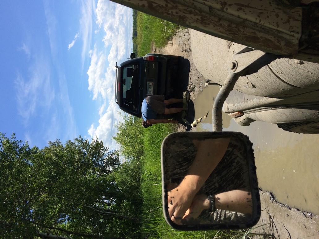

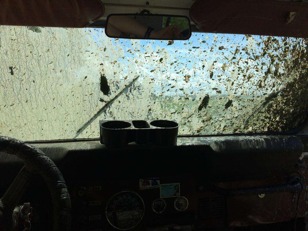

Went wheeling in my Dad's jeep with him on Father's day got high centered on a rock in 1.5 feet of wet clay and mud. Couldn't get the jack to lift us off and didn't have the winch on a cradle with us. So since it was Father's day I had to walk 4 miles to go get the 4runner and go down the trail to yank the jeep out.
Here's some crappy pictures:

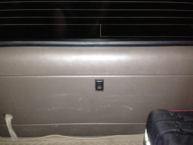

This:
Rear window switch. Works like a charm without the ignition in. Credit to ryani and this thread for the how-to.
I wanted it high enough to clear a sleeping platform, and easy to reach from either side, but I wouldn't put it right there again. Very snug fit on the backside, had to modify the switch and mounting to make it fit.
I like it. I want to do this, eventually.
Nice!, I bought a $12 switch for this but I think its to thick. I was shocked by the little space behind the panel, I might try and find those wires where they come into the cab above the roof liner. then just put the switch on a side panel.

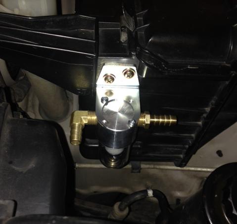

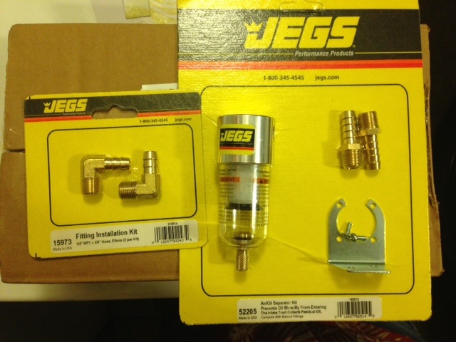

With the incoming SC install, I wanted to try to keep it clean and install a catch can / air-oil separator. So I installed this:
It feels a little small, but a) it actually has a filtering element, b) it has a clear catch cup so visual check is easy and it unscrews to empty, and c) it's US made and appears to be quality.
It fits neatly on the side of the airbox, where it's easy to check and empty:
All that said, don't know if it's any good yet. Will only know if it's working when I have to empty it.

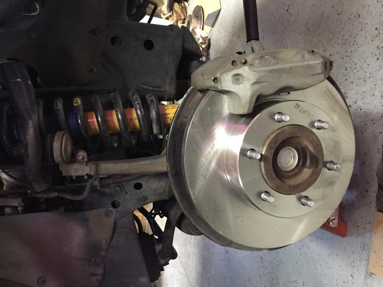

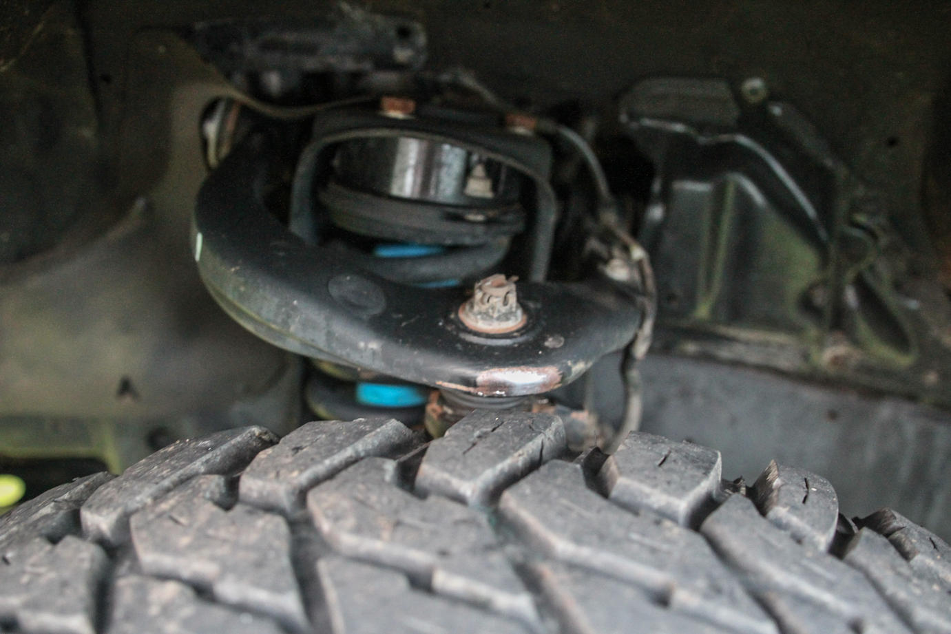

Brakes; new rotors and pads. Also recently installed Tundra TRD front suspension. I love this thing!
