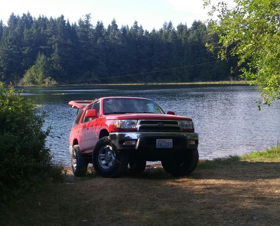

Took mine out to a lake with the family. Guy thought it wascool that I backed up that close he got stuck few spots over.

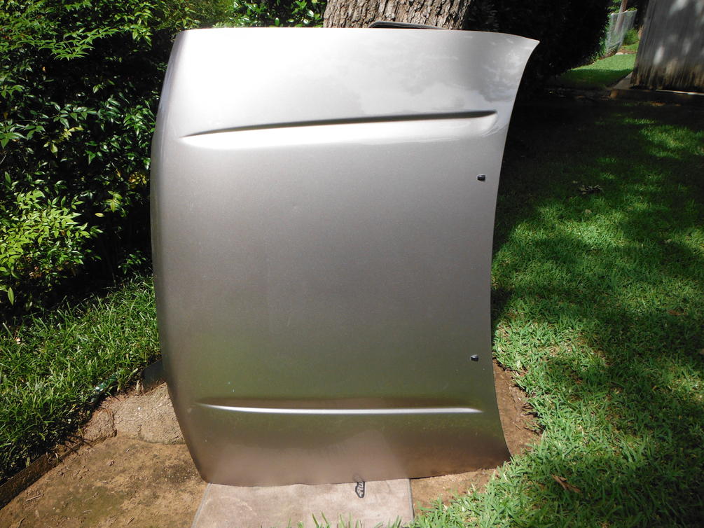

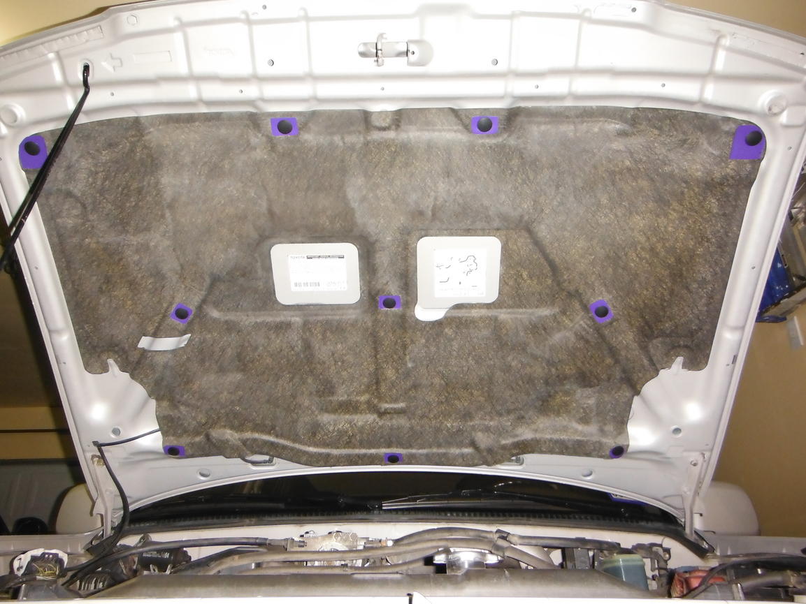

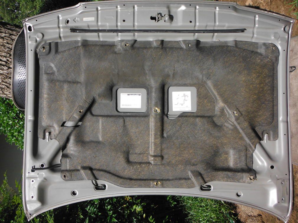

Purchased a 3rd Gen Thunder Cloud Metallic hood (first two photos) locally and removed the insulator. Installed the insulator on the '97 hood today. There was some insulation loss around a few of the holes when removing the fasteners. There wasn't sufficient material left around those areas to help hold it against the hood to my satisfaction. Since I was changing the oil on my 4th Gen I used the thickest sections of my Royal Purple 5 quart jug to fab up some extra support for the new fasteners. They aren't the exact same size or anything but who cares. This insulator isn't going anywhere. Only 3 or 4 of the holes actually needed help but I made one for each fastener anyways.
