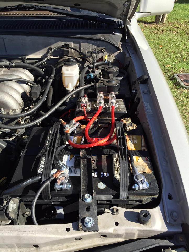

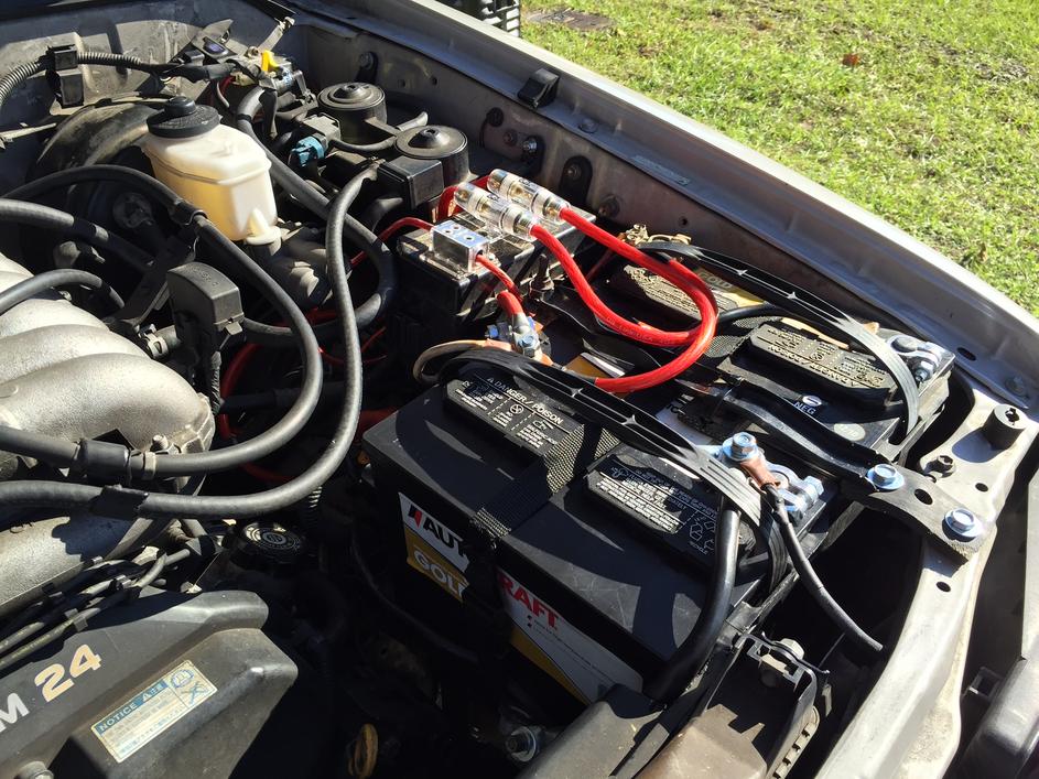

Just finished my dual battery set up. After reading a several random threads about it I decided to do it. First I moved the "charcoal" box and fuse box back about an inch or two toward the firewall utilizing other bolt holes and some creative mounting. Then I removed old battery tray, cut the original battery tie down and old fuse box mount ears off of the fender, and then beat the fender that was under the fuse box flatter. Then I added an eyebolt setup through the fender to replace the battery tie down ear, cut a 1x1x12 inch chunk out of the radiator plastic cover next to the battery location, replaced old tray with a marine dual battery tray, modded the old battery strap with some muffler hanger rubber strap to fit, added an 80 amp isolator just below the fuse box mounted to the fender, ran the 100 amp fused wires to split all my add-on (stereo, amps, inverter, lights, ect) accessories to one side and the rest of the truck to the other. All works great. Waiting for a dual battery switch that fits the dash panel to get here, then I will add a couple more wires to the system so it can self jumpstart from one to the other in emergency. Pretty stoked with the finished product.
Just finished my dual battery set up. After reading a several random threads about it I decided to do it. .
I see you're in FL. Just for future reference, I was in West Marine (I assume you have those over there) today, and they have a HUGE selection of battery cable and crimp connectors, and the one I was in even had a crimping station where you could cut the cable and crimp the connectors down right in the store. Like anything else in that place it wasn't cheap, but at least they're there in a pinch.

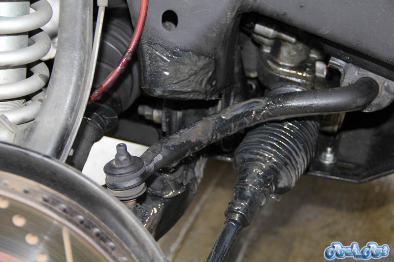

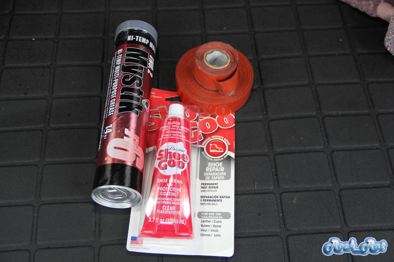

Changed my Oil and....my sweet little Jade decided to become a member of the "Torn CV Boot Club." You guys did not have to let her in you know! Being turned away at the door would have been fine with me.
It was bound to happen; 15 year old rubber CV boot - check, one year after the lift - check, 285's on 17 inch wheels - check, throwing some miles on it both on and off road - check. Yup, the "Members Only" club just dragged her right on in.
So now for the fun. First comes the band aid fix, some shoe goo, self adhesive rubber tape and lady luck. Done Next comes the suspension upgrade:
  • PRIORITY ONE - Keep my OEM axles if they're still OK, or have someone rebuild my OEM axles.
  • LCA's with poly bushings
  • New and improved spindles either going all out or TC reinforced
  • Extended inner and outer boots - Just Ordered!
  • New bump stops
  • New links
Isn't it funny how priorities change...BTW I'm not laughing.
