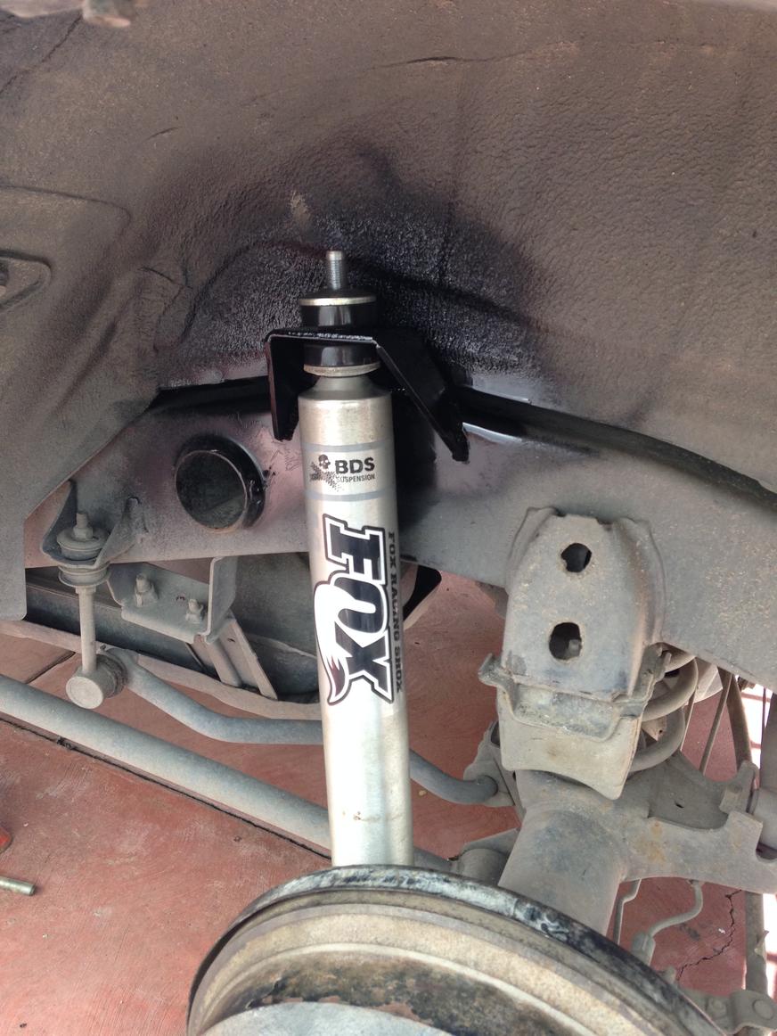

I would only go with one set of the wheelers bumpstops. You will have to run them on the front part of the LCA, they won't sit properly on the rear part. They hang off too much to be effective. You also want to keep one of the stock bumpstops as a final limit on compression as well, this will be the rear one on the LCA. The front bumpstops are larger than the rear ones in diameter, that's why they are labeled front and rear. Here's a bit from my build thread on the super bump install.
UNNER said:

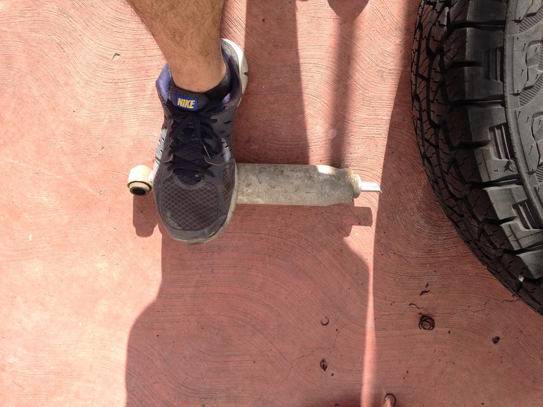

I also got the wheelers superbumps installed up front. I know earlier in the thread I said that I called wheelers and they said to put the bumps on the rear of the LCA, but when I did this they didn't seem to sit very well back there. The rear of the LCA is skinnier than the front and a good bit of the bump was hanging off so I decided to put the stock one back on the back and put the new wheelers ones on the front of the LCA.
This made easy work of taking the stock bumpstops off. I wear a 13 in Nike's...
Installed on Front:
Installed on Rear:
You can see how much better they fit on the front of the LCA versus the rear.
As for the rear, here's a shameless plug for a couple of extended bumpstops I have for sale right now. :sorry: They work perfect to keep you from over compressing your shocks and blowing them out when flexed. Let me know if you're interested in a set.
