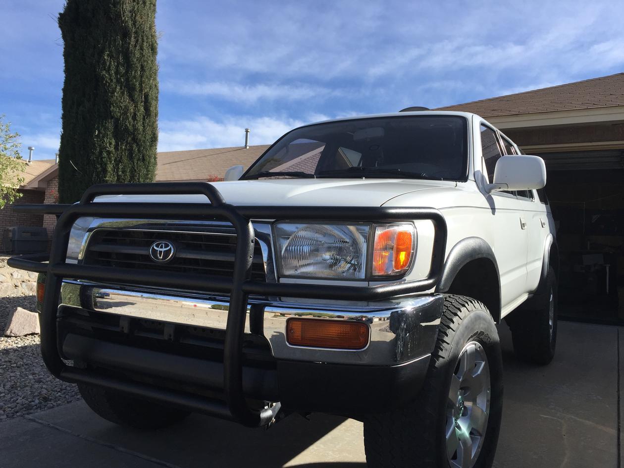

Spray painted the grill guard with truck bed liner over the past week. I'll be doing the bumpers next, but doing it with a roller instead of spray.

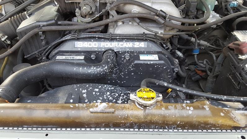

Parked the truck after the rad blew up. Original radiator, 343,xxxKMs.
As soon as my friend gets out of my garage the truck will go under the knife.
