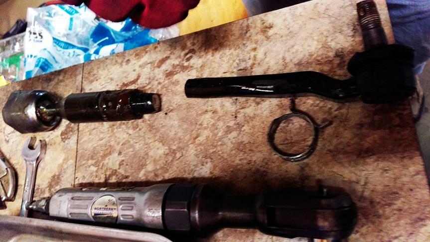

Replaced my inner and outer tie rods over the weekend. Had to saw the right outer tie rod from the inner to get the boot off because the nut was seized. Got the front end aligned and tire's correctly balanced yesterday. Truck drives perfectly now :thumb:

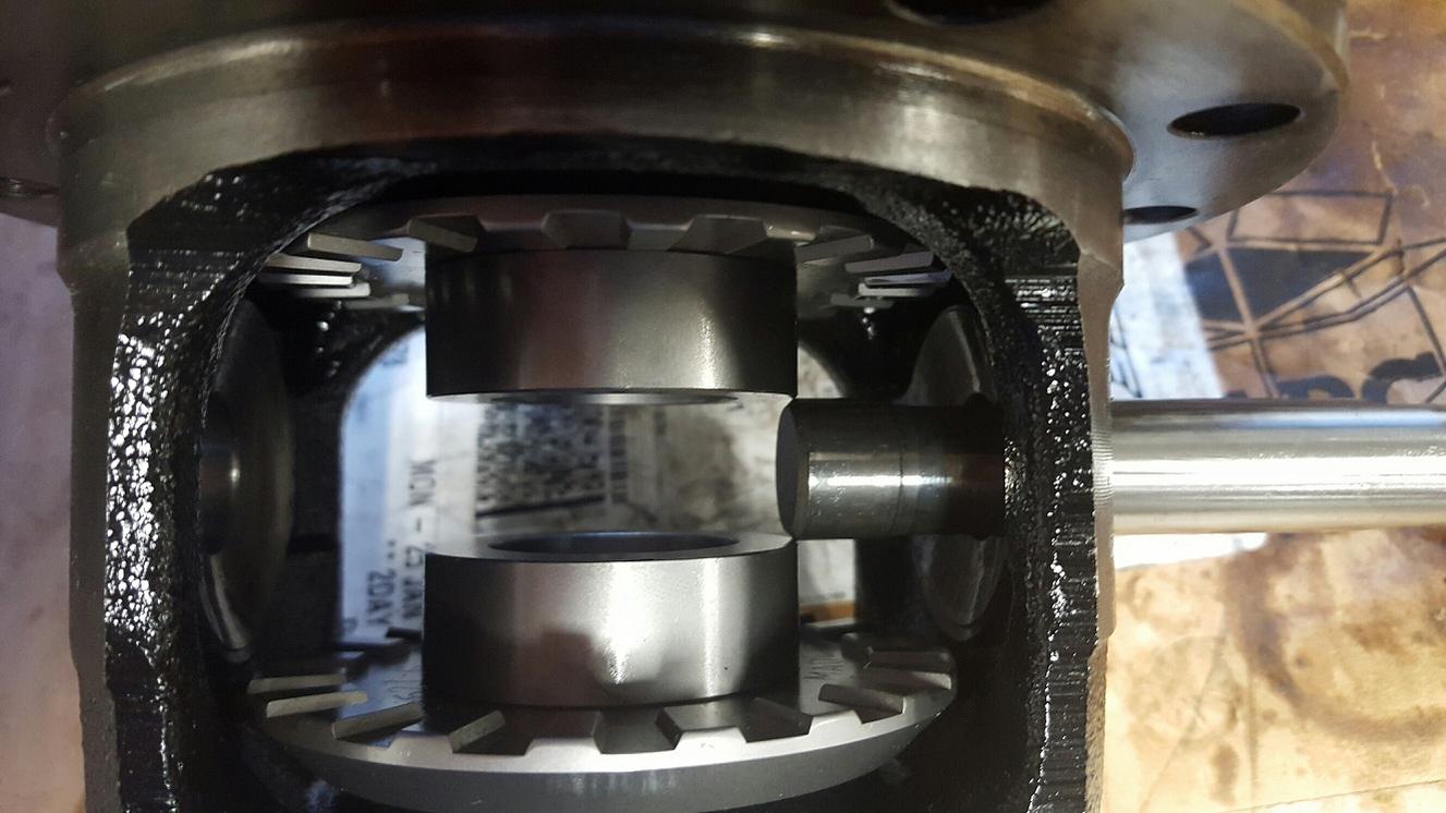

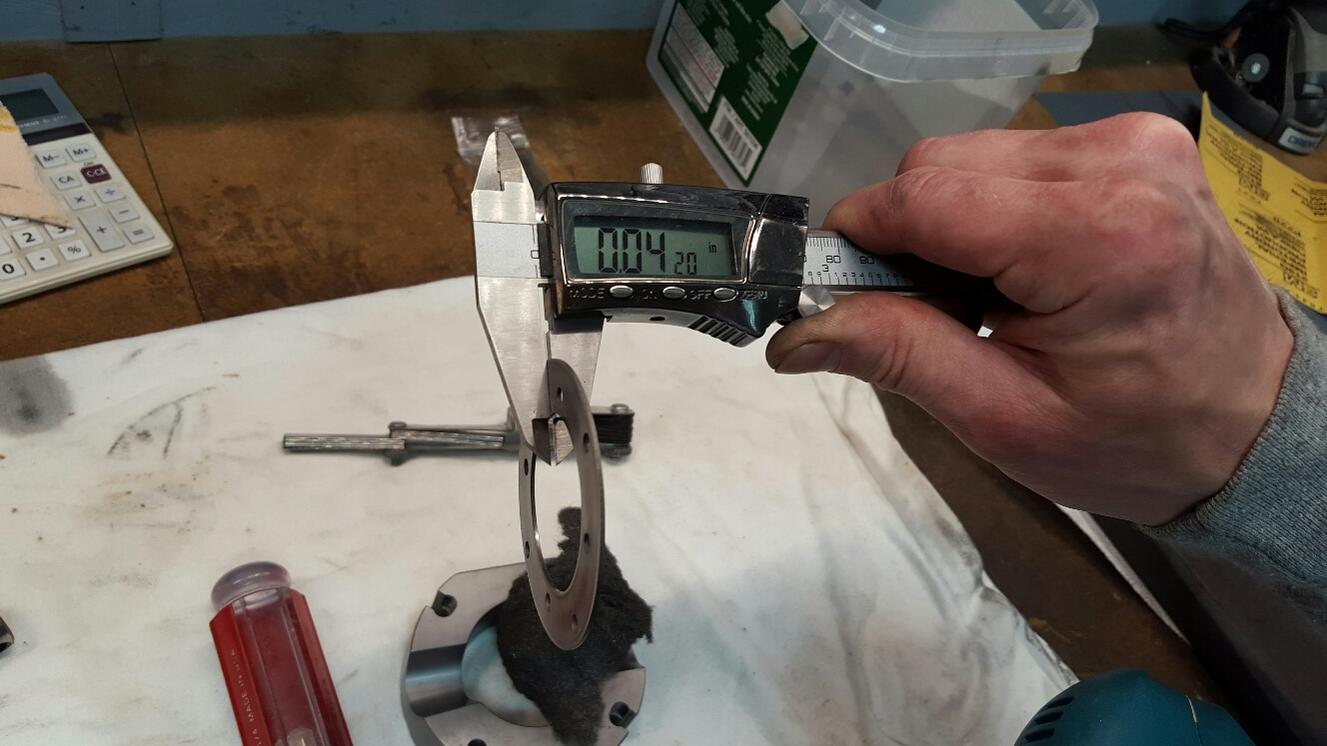

Well really I did it last night but I figured out that my thrust washers were really about 10 thousandths too thick for my Aussie to go together properly. I also learned that these thrust washers are a seriously hardened compound and you'd be sanding for 10 years to remove the excess materials. You can't see it in the top pic but if yo haven't had your front diff apart before the thrust washers sit behind those side gears in the top pic.
According to Aussie, I learned I'm one of the lucky ones that has a front diff cage that's slightly out of tolerance. Soooo now my diff waits for new thrust washers or I can take mine to a machine shop and have some material removed. Turns out the easy part of the install was getting the diff out of the truck!

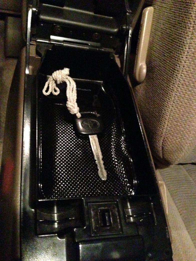

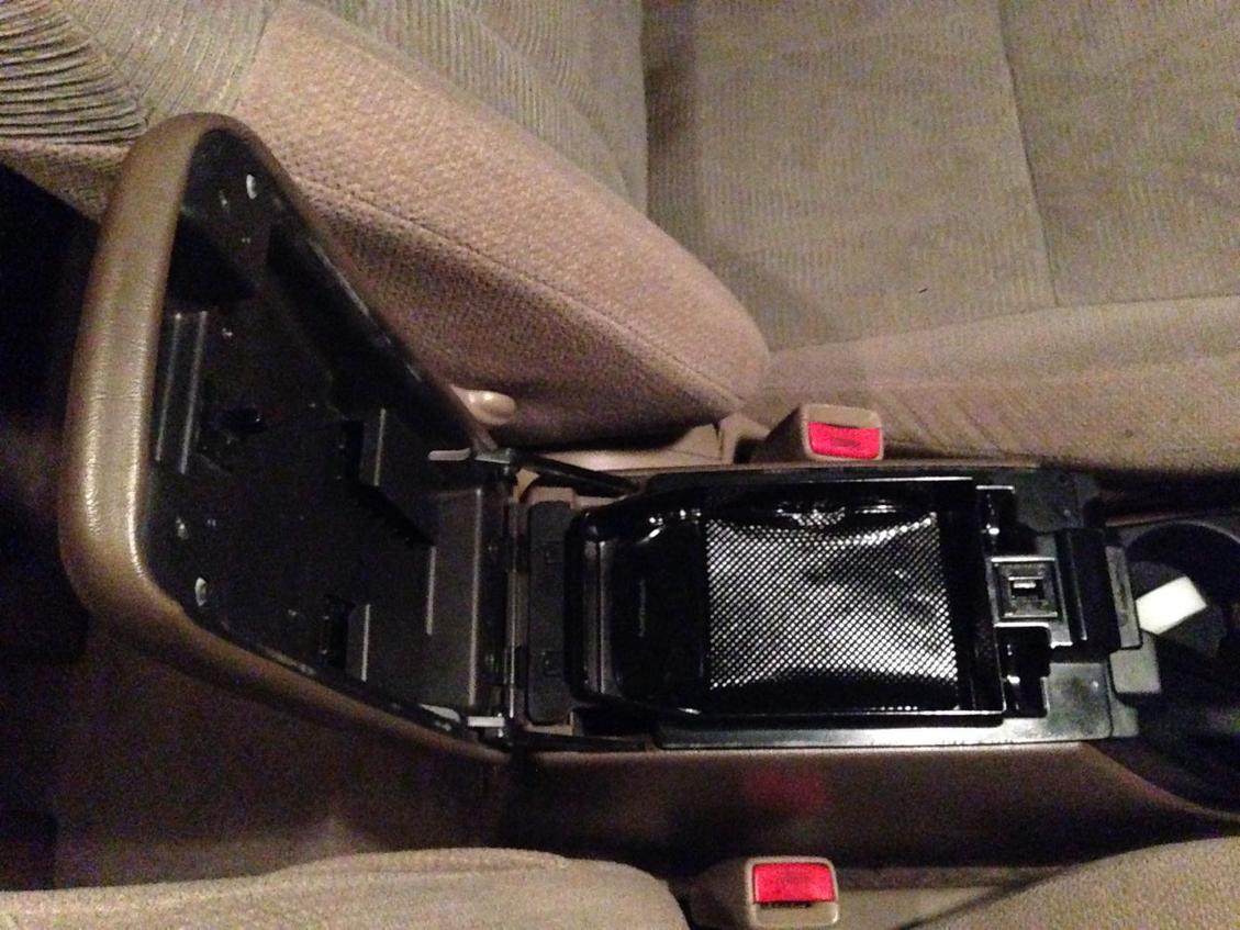

I put a silicone pad inside my upper glove box compartment, I usually keep a knife in there and this holds it nicely in place and prevents it from rattling around.
I got it for free with something I ordered off Amazon last year but the brand is Auto FX products, its meant to be put on the dash to keep you cell phone from sliding around.
It came for free with this Sun Shade I ordered the Sun Shade is okay for the price but not anything special its a little on the flimsy side:

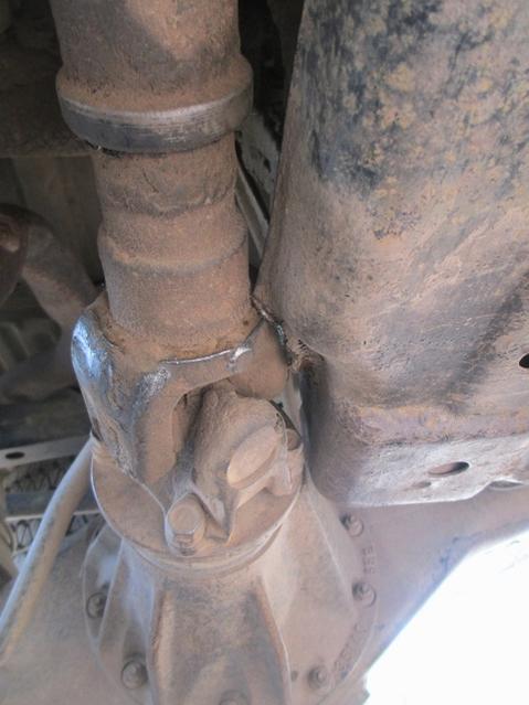

Because of the added flex, the driveshaft may touch the gas tank?!
First time I'm hearing this
With extended rear sway bar links I flex pretty hard into the rear tank skid. With the removed rear sway bar links just driving slightly quick though bumps can have my axle slam into take and it really hits hard when flexing all the way out. NTM the body roll is so bad that I had a lot more issues with the body rolling into rock and or trees near the edge of trails. Here is an example.
I wonder if your coils are too soft? I've had both sway bars gone for a long time now and do plenty of harsh flexing but excessive body roll has never been an issue.
Yes they are soft, but IMO is what you want for trail crawling. Allows the tires to stay planted. My buddy with OME coils just lifts tires all day and never has the issue because they just dont flex like LC coils.
