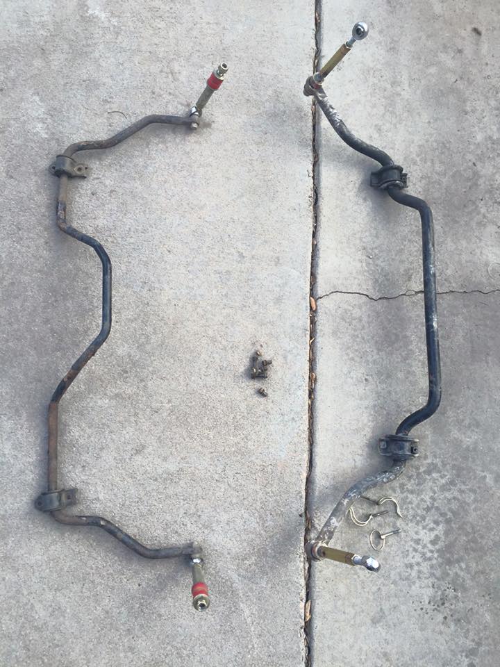

Well after refurbishing the front end with all new bushings I still had a random pop sound. I thought maybe it's the sway bar since I bought aftermarket links and poly bushings. So I disconnected it and sure enough that's what it was.
So I put the original sway bar links back on with the new rubber bushings from the new links and viola it's fine. The poly end link bushings I bought, the holes are too big so I think the sway bar moved around causing the pop sound. I heard this to be an issue with universal poly bushings (that the internal diameter of the whole to be much bigger than the diameter of the part; in my case the end link).
After cheap OTRE and sway bar parts I learned my lesson, just go OEM...

Sounds to me like the problem was with the bushing itself. The inner diameter of the bushing is greater than the diameter of the bar, so it has room to move. General bushing image below: size of A was too big.
I had this same issue on my Tahoe's sway bar a long time ago. The OE worn bushing had too much play in it, so the bar kept popping when it "swayed" enough. I bought the correct size diameter polyurethane aftermarket bushings and fixed the issue.
I think the OP's trouble is that they got either the wrong size or too "universal" of a bushing. Need to make sure you get the right bushings made for the right diameter and all will be good (whether its OE or aftermarket). :yo:
Exactly what I was trying to explain. Thank you :)
You're welcome. :yo: I think the only reason I know exactly what you were saying was going through the same thing with my Tahoe. hah. I remember crawling under it and measuring the sway bar size and then comparing to the spec sheets of the bushings I was ordering and whatnot.. And the Tahoes have two different sized sway bars during those years, so I had to get it all 100%..
