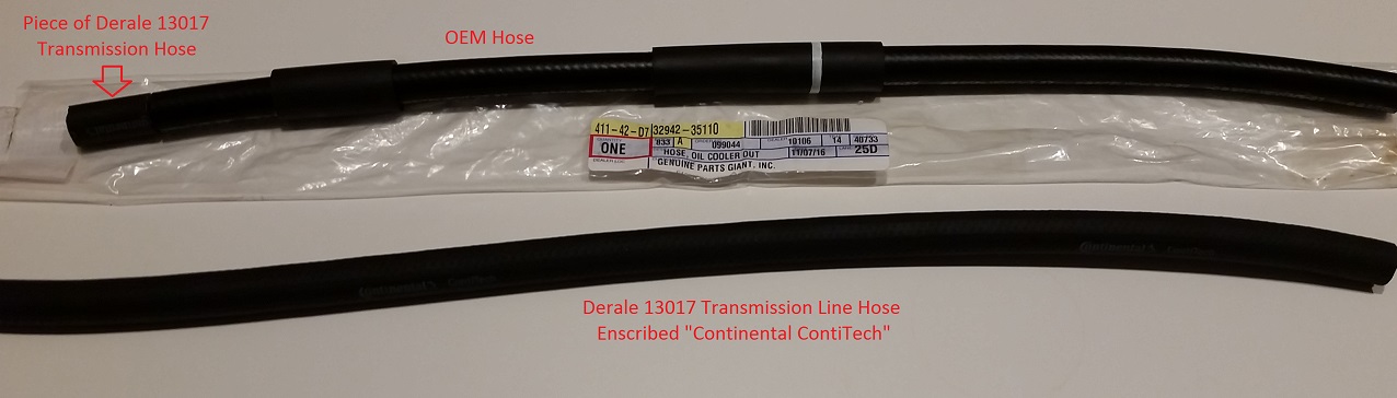

I decided to replace the rubber transmission line hose when I replace the radiator. Looking at the original rubber hose on the radiator transmission fluid output, it appeared to me that the line was pre-formed with bends, much like the coolant lines. OEM replacement hose is much more expensive but I figured I'd better get OEM for the output side (32942-35110) since there is a 90-degree bend, so I wouldn't risk pinching off flow of transmission fluid through the radiator and downstream into the transmission. I also decided to purchase aftermarket line made by Continental and sold by Derale P/N13017 (instead of OEM 32941-35260) for the other side since that is a straight shot, and to save a little $$$. Well lo and behold, the OEM hose is not pre-bent. So now I will just send back the OEM hose and use the extra aftermarket line I bought. You can order the Derale hose by the foot on ebay here:
Auto Trans Oil Cooler Hose Derale 13017 | eBay
Below is a pic of the OEM hose that I thought would be pre-formed with bends at the top, and the aftermarket Derale hose below it. I also cut a small piece of the Derale hose and put it next to the OEM so you can see the outer diameter of the Derale hose is the same size.

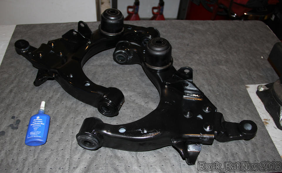

Lower Control Arms, Whiteline Bushings, Wheeler Bumpstops
It's getting to be a habit...starting to finish up other projects. Installed, with a bit a of hesitation, my Whiteline bushings and the Wheeler bumpstops. Another project done...but wait...there's more....
Here's a pic of the finished project. I'll put the details in my build later on.

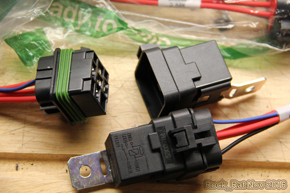

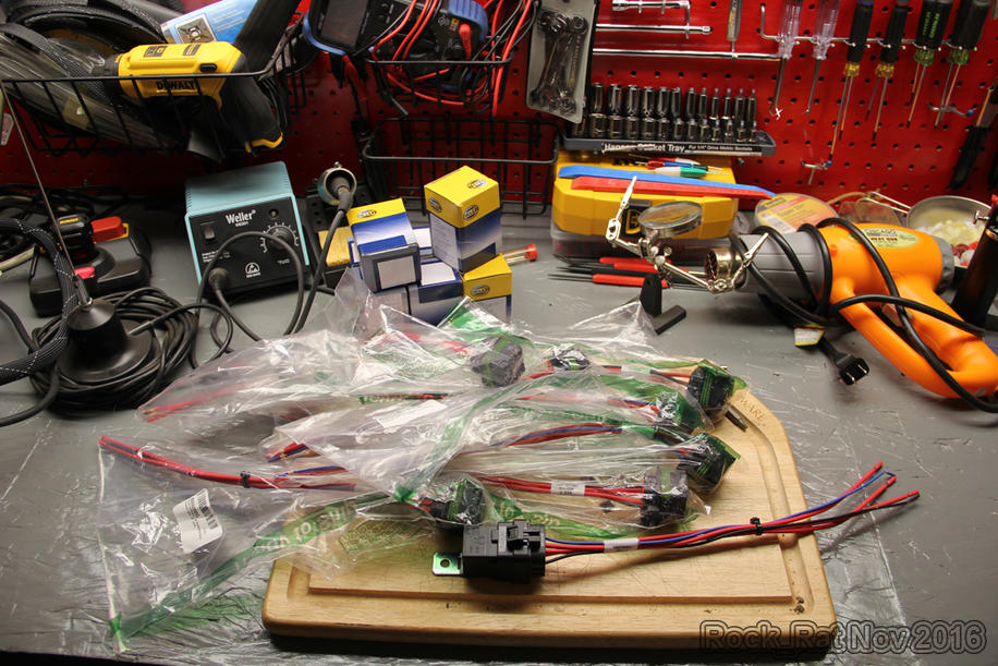

Hella Weatherproof Relays and Housings
.....and another project arrived...my weatherproof Hella relays and Hella weather proof housings for my lights etc. Can't wait to get started on this project.
