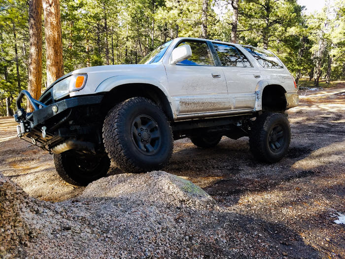

Custom plate bumper, cali raised pods with cbi ditch light brackets, cali rasied spots in bumper, custom adjustable panhard bar, 8 wraps and bent rear brake like bracket. Need to stop being lazy and install toytec extended ss brake line and extend the bumpstops!
Next on the list: TBU and rebuild rear brakes with [MENTION=120071]mtbtim[/MENTION] and [MENTION=102606]infamousRNR[/MENTION]!

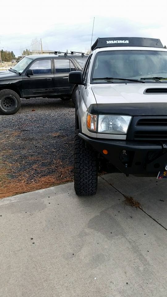

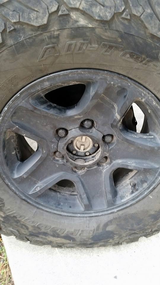

Got my front wheel spacers on. Now just need to modify the center caps a bit.

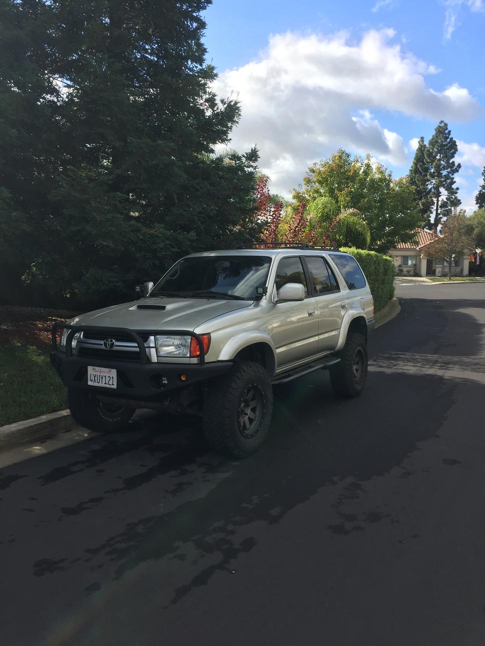

Haven't posted in awhile but this past few weeks i got to work on a few problems with the 4runner. So I had bent Camber tabs making my alignment a Horror story so installed Total Chaos Camber tabs and brand new OEM LCA bushings and Spc Cam bolts All went well but did have to cut the tabs to fit in some areas. So heres a pic after alignment and a wash Also got Weathertech floor mats and other little items like color matching my lights up front and fixing my headlight adjusting issue. Also Not wanting to sell my truck but my buddy is giving me a great deal on a 4th gen v8 so I'm testing the waters.
Nice! Finally color matched the hood huh? V8 mmm! Definitely on of the best sunfire red builds ive seen! I want that rear cbi hah! Btw what lights are you running in the center?

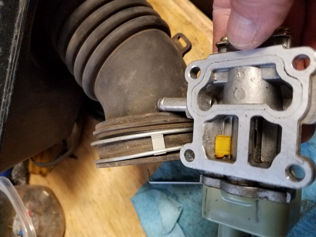

That piece looks familiar. The rubber intake tube that mates to the throttle body, it has hose clamps on it that are made out of wire (as opposed to flat metal jubilee clamps). They had a little plastic spacer on the back side of them to keep the wire bands evenly separated. They brittle and break off in time. This looks like the remains of one of yours fell off when someone was taking the intake tube off. Luck would have it it fell in instead of out.
I don't think this part came from the AIC or throttle body. Good luck.
You were correct about that plastic piece. I will now try to return the new idle valve I ordered. Thanks Kanoe!
