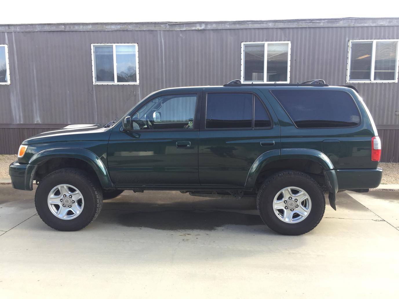

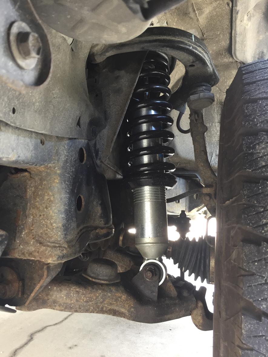

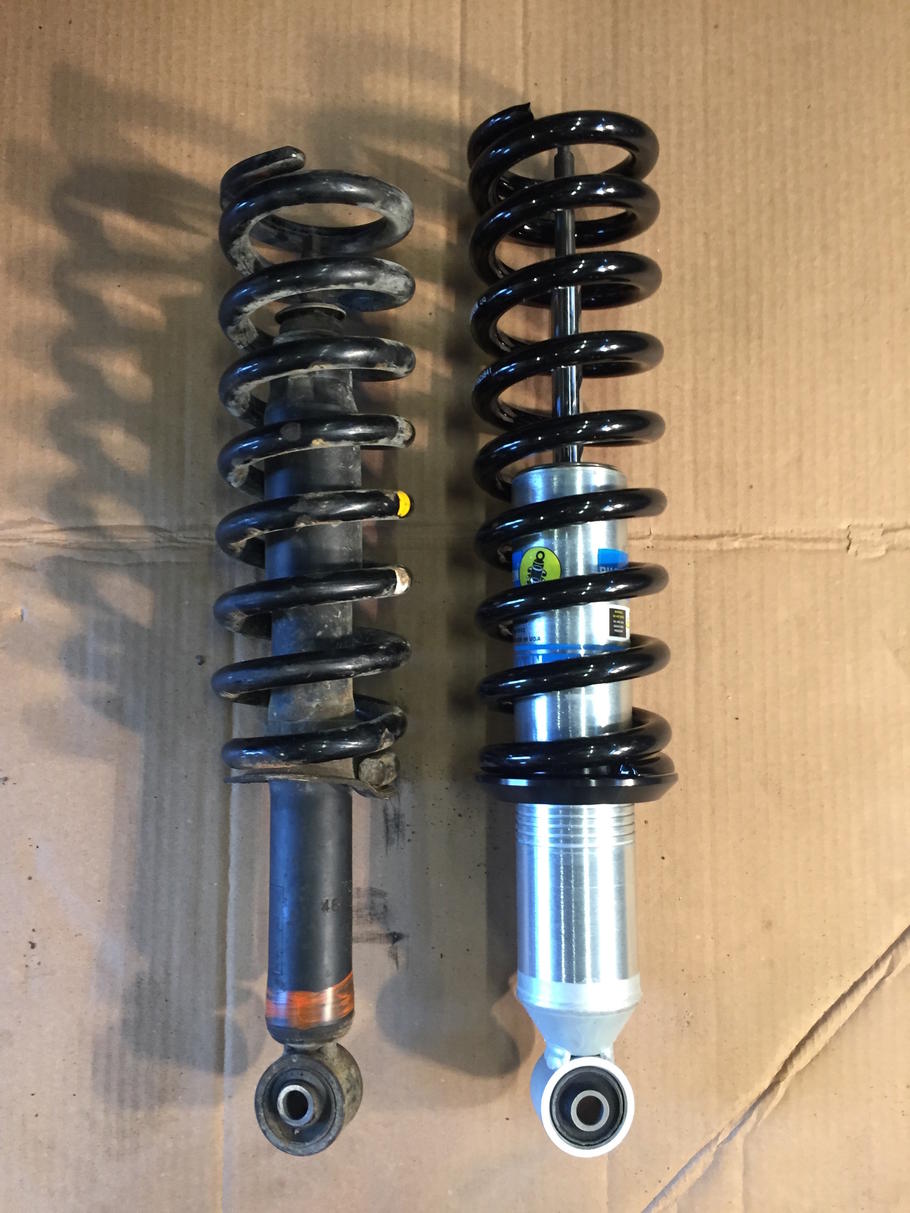

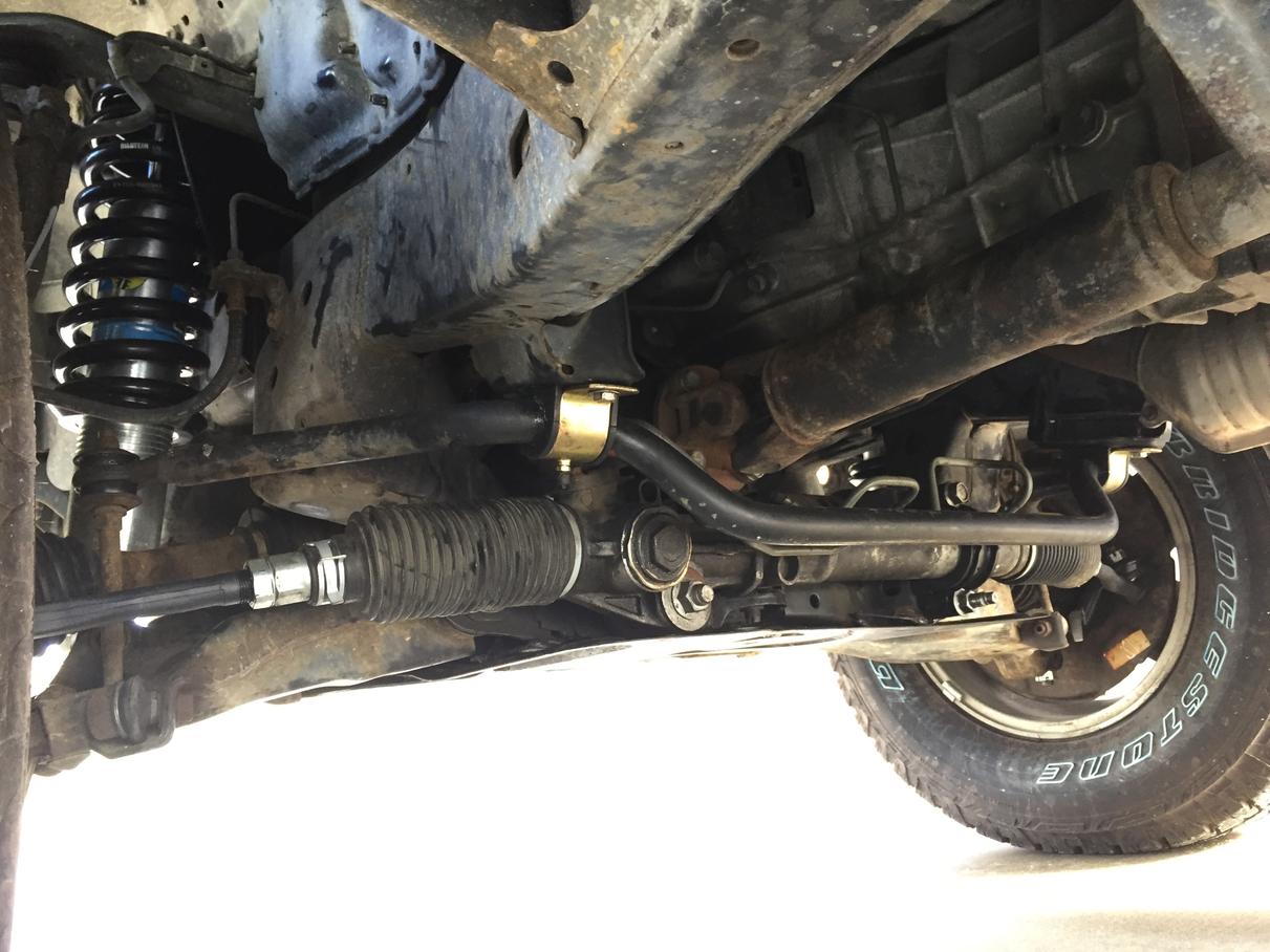

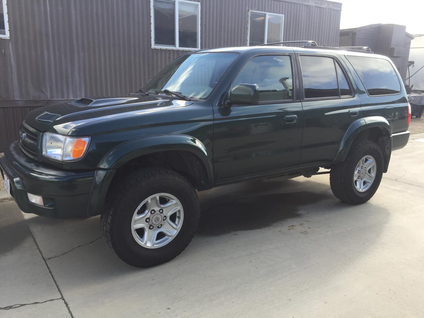

Installed the new Bilstein 6112 coilovers for 3rd gen T4R's. I had been riding around on the original stock everything (180K miles) and getting freaked out about all these LBJ failure posts so I installed new OEM ITR, OTR, LBJ, Energy Suspension poly steering rack and end link bushings. I matched this in the rear with new 5100 shocks, OME 906 coils, and new Energy Suspension poly end link bushings. I set the 6112's at the #7/#6 height for 1.64" of lift and actually got closer to 1.75" in the front and a full 2" in the rear with the 906's. We'll see if it settles at all. I also removed the running boards so the truck has a whole new stance/look. Just got back from the alignment shop and so far very pleased with the ride/feel.
