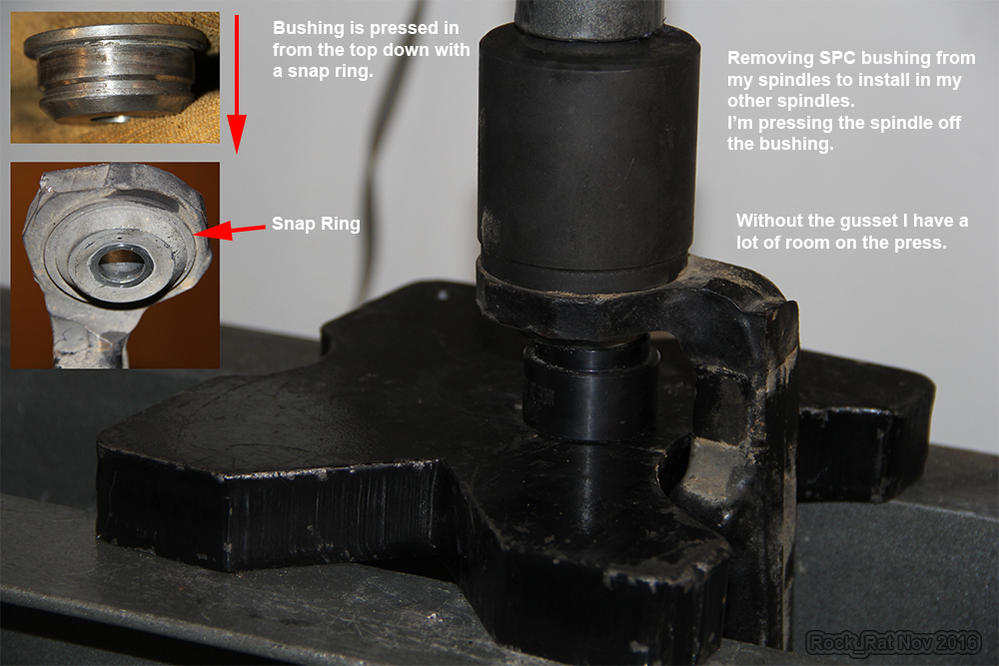

  1. I had no problem removing the bushing from my old spindle once I removed it from my truck (no gusset installed). I just pressed the SPINDLE and it came right off. Keep in mind these are SPC bushings that press in from the TOP not the bottom as in the OEM UBJ’s. (See photo and it will make sense)

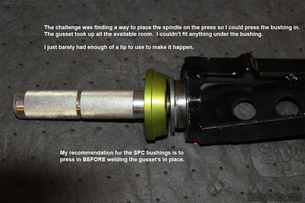

  2. Next step, grab my re-built spindle and install bushing. Here's where the problem was. The problem was finding a way to support the “NEW” spindle on the press to press in the bushing after the gusset was installed. Two problems here:
  • No room to place a receiving cup UNDER the bushing because of the angle of the gusset
  • Not enough surface on the spindle to place on the arbor plates.

Make sense? :shrug: Take a look at the first two pics I posted and look at these.

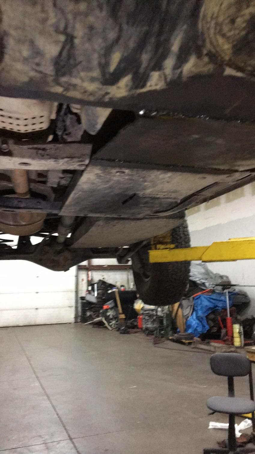

Built trans skid today, have built the tank,transfer,and trans skids so far.

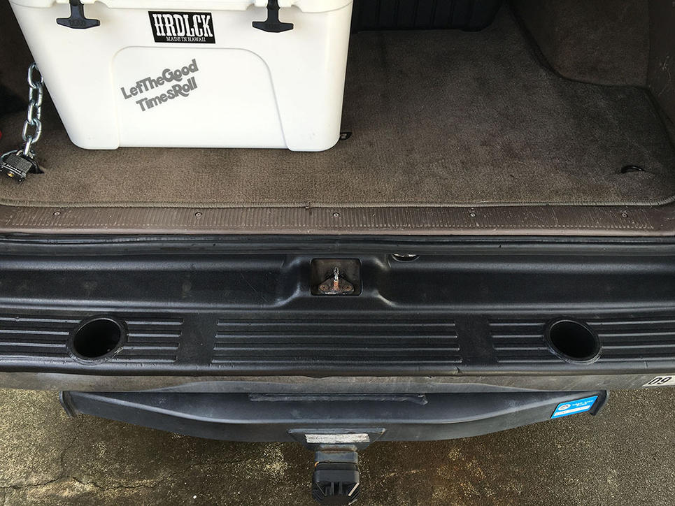

Put some cup holders on my bumper today. Comes in handy here in Hawaii. Thanks [MENTION=65614]Antman[/MENTION] for the idea!
