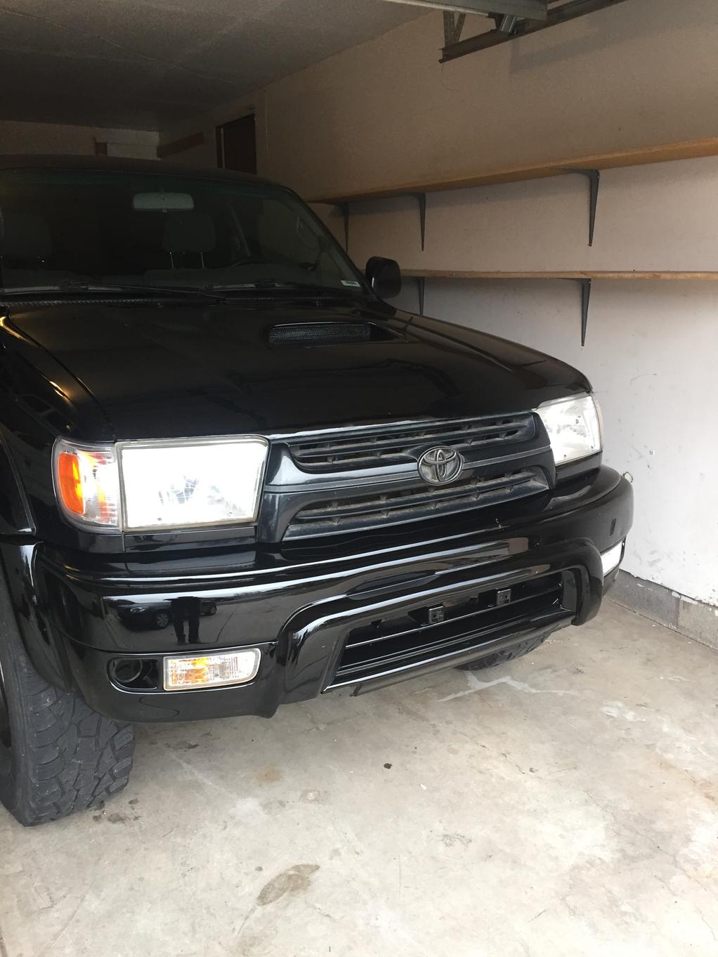

Painted the front end (hood, bumper, headlight filler panels) to get rid of 245k miles of rock chips.

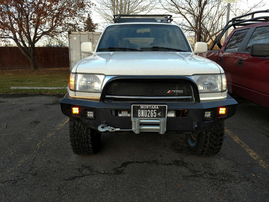

New tires and addition to my blinker mod

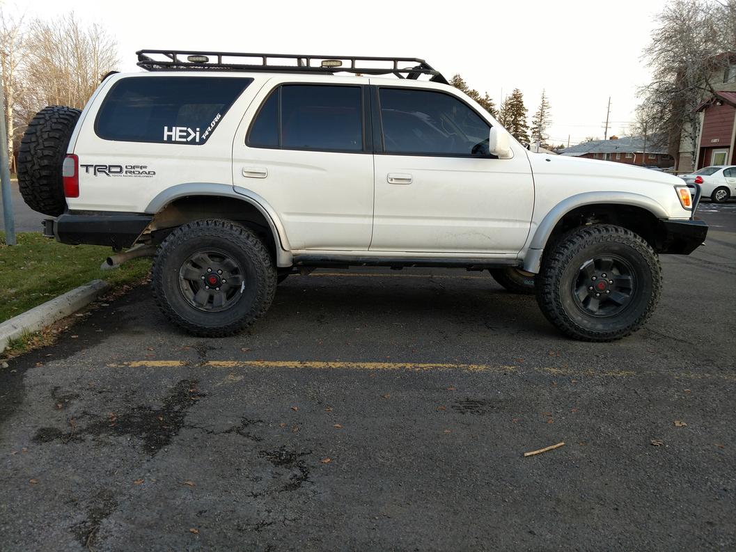

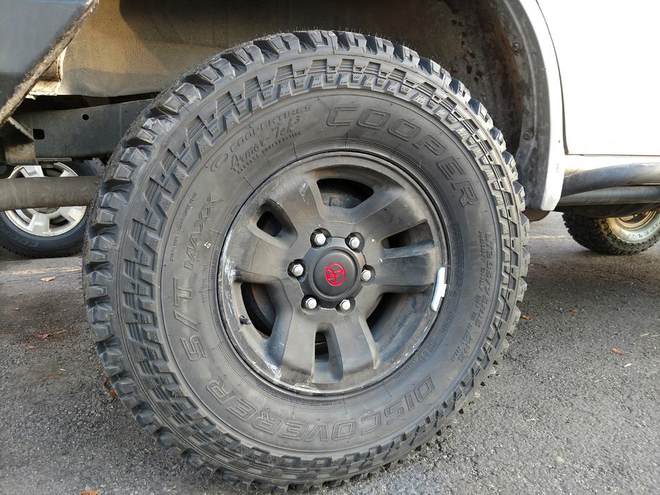

Got my new Cooper ST Maxx 285/75/16s installed with a random spare of the same size that the tire shop just had laying around.

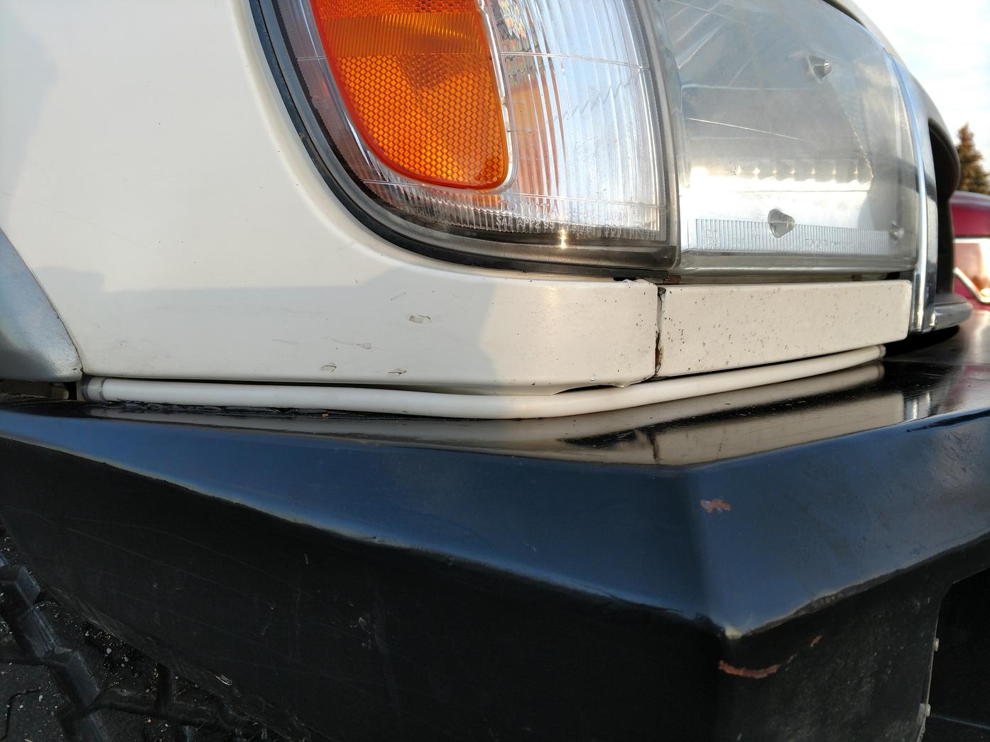

Also added to my already existing blinker mod.
I already had replaced the corner lights with 1157 switchback LED bulbs with a standard 1157 socket. It seemed that people were not really seeing my blinkers very well for whatever reason so I dug deep into my garage and found these 600mm white/amber LED strips that I ordered over a year ago that I was going to use for my blinkers but never did. I used "Right stuff" to adhear the strips to my plate bumper and just spliced the wires into my existing wiring for my corner lights.
Passenger side shows what the amber looks like aka the blinker and the drivers side is what it looks like on the first click on the lights aka the driving or parking lights. When lights are off they only flash amber like a normal blinker and when I have the lights on they flash white amber white amber ect...

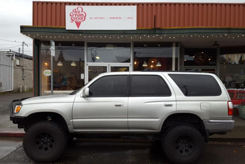

Got my lift installed! WOOT!
King 2.5 Extended Travel Coilovers, SPC LIGHT RACING UCAs, MStudt' front sway bar extended links, Sonoran Steel 1.2 rear lift with Tokico shocks. I am digging it. I took it for a little road trip down to Tacoma with my special lady friend to celebrate with some tasty beer and some delicious chili dogs and brats at The Red Hot.

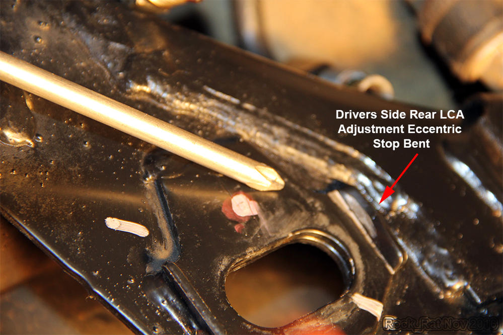

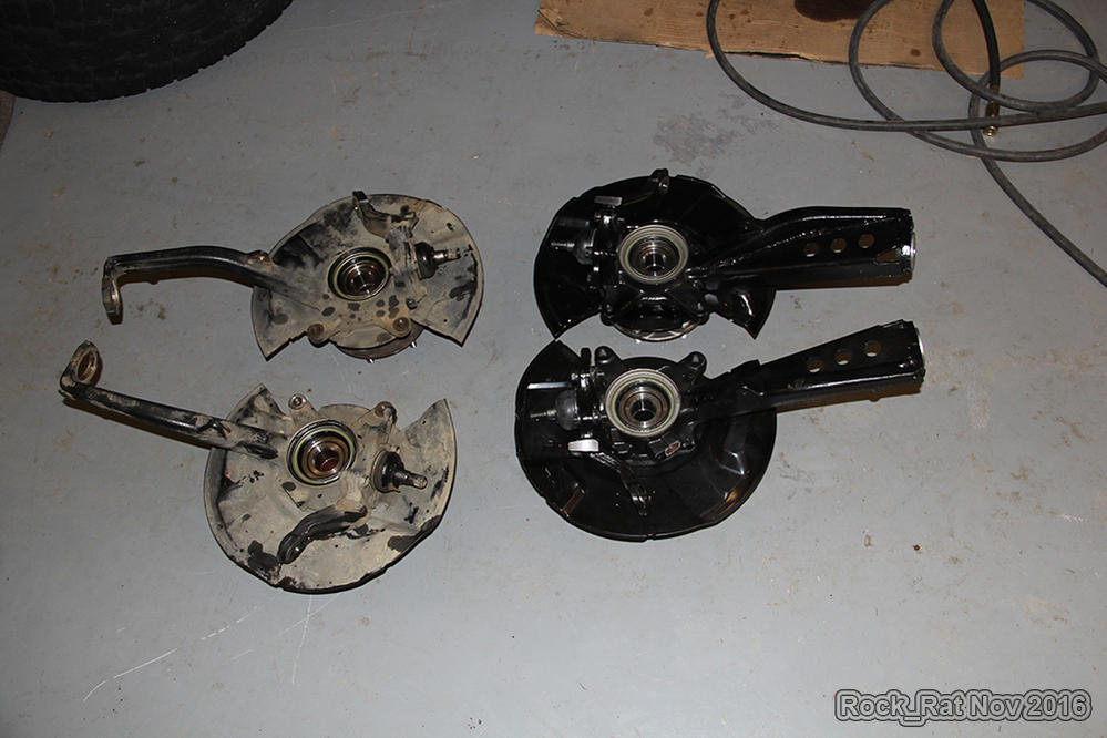

So Monday night after work I began my entire front suspension re-build, new LCA's with whitelines, new spindles with gussets. ITRE etc... What prompted me to begin this was the noise I heard in my drivers side front end every time I turned the wheel. Further investigation revealed a bad ITRE. Funny thing is I replaced those about two years ago. Befuzzled, I began the teardown and the rebuild...

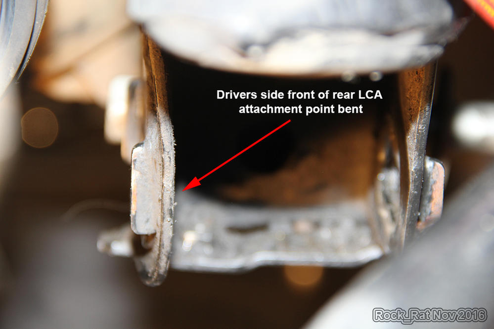

When I went to install the drivers side LCA last night, I noticed the inboard stop/tab where the rear adjustment eccentric goes was bent. Looking at the mounting bracket from outboard to inboard I also noticed the front of that bracket was bent rearward.
That explained why my drivers side tire was rubbing on the rear of the fender.
The only reassuring thing is, I know I can bring this back into alignment as was proven in Wenatchee.
Well hey, for what it's worth I now have most everything back together and I have a set of spindles for [MENTION=7105]Scramble[/MENTION] sitting in my garage. I'll finish it up tonight.

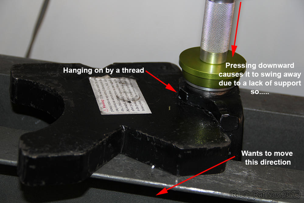

Check out the last two photos to see how I re-installed the SPC bushings! Scared the daylights out of me. Was expecting the whole thing to go pop!
Notice how bent the inboard stop for the alignment eccentric is.

The forward part of the rear LCA attachment is also noticeable bent. I'm thankful that it can be brought into alignment. Hugo, over in Wenatchee did an awesome job. Once complete I'll bring the rig to Portland to get it aligned. There's a good shop over there.

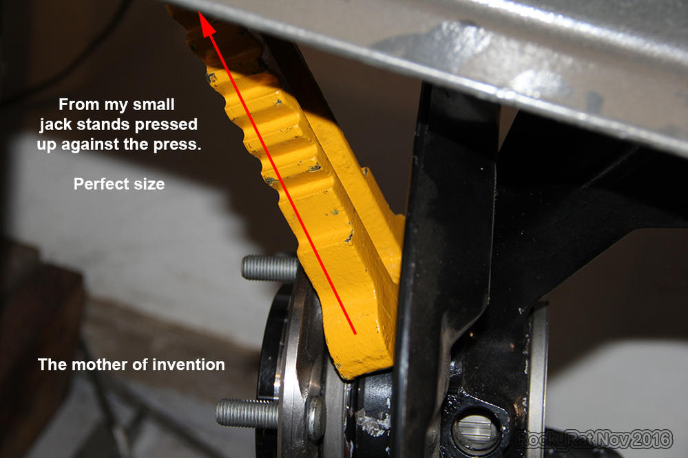

Hey [MENTION=7105]Scramble[/MENTION] , I now have your spindles sitting in my garage. It was VERY tricky installing the SPC Light Racing bushings into the new spindles with the gussets attached. Something to think about.
No room to put a cup behind the bushings with the gusset installed. Lesson learned. I knew it pressed in from the top but never really thought about how difficult it would be to put on the press.
I'm not sure what I would have done without my other set of jacks lying around. They were the perfect size to use to press between the spindle and the press. Again, something to think about before you weld your gussets on.

[MENTION=116467]Rock_Rat[/MENTION] fwiw an alignment shop screwed up my stops a few years ago and they paid to fix it.
Since they were paying I got some heavy duty alignment stops from total chaos. They've held up great so far. They can them cam tab gussets.
TOTAL CHAOS FABRICATION
Glad everything is almost back together.
Thanks for the link! This is good to know. So I'm wondering how they can install the rear cam plates without removing the steering rack. It looks like it will need to come out again to remove that bolt. I'm hoping I don't have to tear into the front end again for quite a while. Added to my future to-do list...
