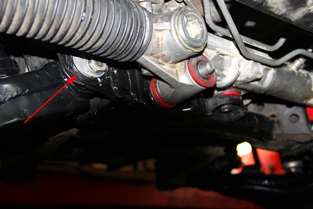

Thanks for the link! This is good to know. So I'm wondering how they can install the rear cam plates without removing the steering rack. It looks like it will need to come out again to remove that bolt. I'm hoping I don't have to tear into the front end again for quite a while. Added to my future to-do list...
Since you've got to remove the cam bolts anyways I don't know how you'd do it without at last loosening the rack.
You might be able to bend the tab back up and weld behind it. They're not strong to begin with, and after they're bent I bet they bend easily.
Mtbtim and infamous just did a video on changing LCA bushings. He was able to remove the rear camera plates by loosening the steering rack, undoing the rack boot and rotating the plate down. After that he was able to wiggle them out without damaging anything.

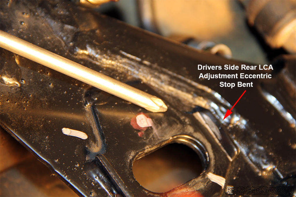

Tried to bend it back but it's way too strong. Used a big ball pen and punch etc. Wouldn't budge. I think I need to put some heat on it. The good thing is the eccentric didn't "need" that tab for the alignment. It was pushing up against the outboard tab. Quick clarification from you. It looks like they replace the old cam plates with new ones...correct?

Thanks. Not my first rodeo with a steering rack. I pulled mine this time just to take a look at the bushings and my under carriage. I could've just loosened it up and slid it backwards like you said. They're not bad to either remove or loosen. It's about a 30 minute job with OTRE disconnected. Honestly, the thing I hate the most is the sway bar just so you can torque the center bolt. Swaybar clamps suck, even from the top. Plus with a lifted truck you have to deal with the diff drop to get the torque wrench in there. The rack itself is easy.

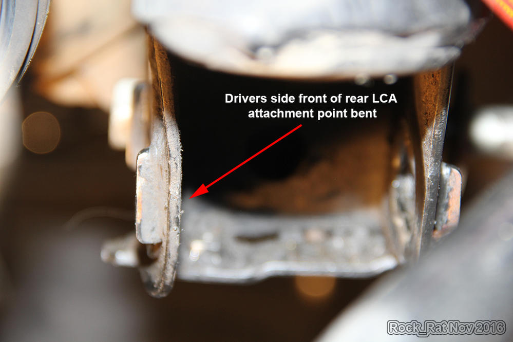

When I went to install the drivers side LCA last night, I noticed the inboard stop where the rear adjustment eccentric goes was bent. Looking at the mounting bracket from outboard to inboard I also noticed the front of that bracket was bent rearward.
That explained why my drivers side tire was rubbing on the rear of the fender.

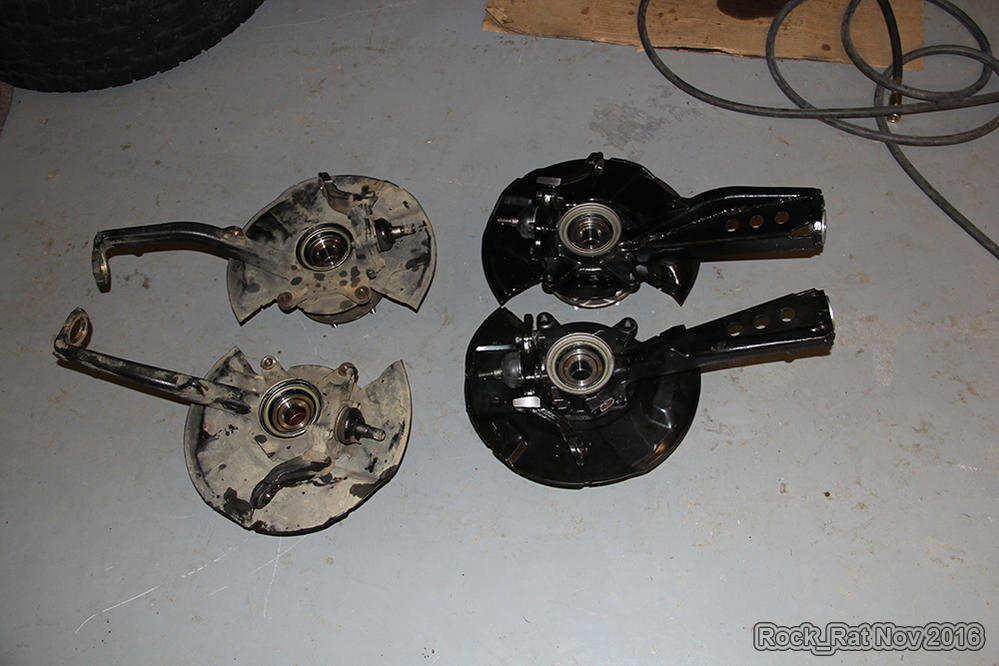

Well hey, for what it's worth I now have most everything back together and I have a set of spindles for [MENTION=7105]Scramble[/MENTION] sitting in my garage. I'll finish it up tonight.

Notice how bent the inboard stop for the alignment eccentric is.
The forward part of the rear LCA attachment is also noticeable bent. I'm thankful that it can be brought into alignment. Hugo, over in Wenatchee did an awesome job. Once complete I'll bring the rig to Portland to get it aligned. There's a good shop over there.

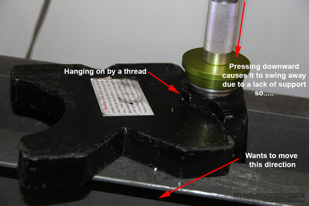

Hey [MENTION=7105]Scramble[/MENTION] , I now have your spindles sitting in my garage. It was VERY tricky installing the SPC Light Racing bushings into the new spindles with the gussets attached. Something to think about.
No room to put a cup behind the bushings with the gusset installed. Lesson learned. I knew it pressed in from the top but never really thought about how difficult it would be to put on the press.

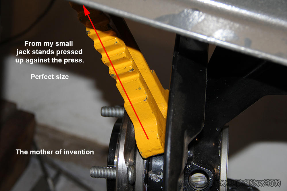

I'm not sure what I would have done without my other set of jacks lying around. They were the perfect size to use to press between the spindle and the press. Again, something to think about before you weld your gussets on.

You did however managed to press in the bushings into the new spindle with gussets ? Why new spindles ? ( I'm welding my own with everything on it. Minus the LBJ....)
