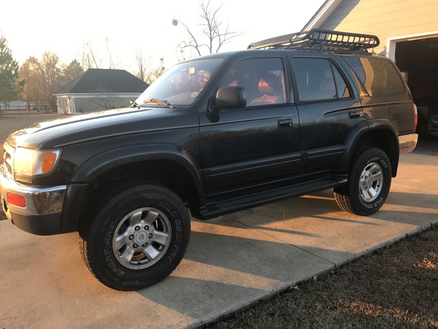

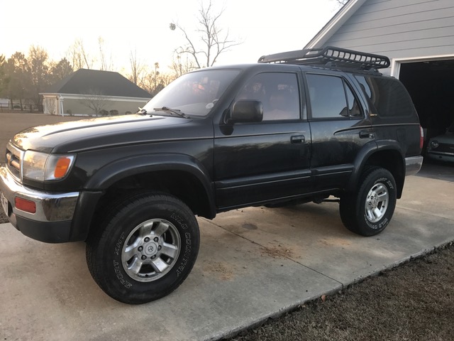

Finally got the running boards off. Wife's comment was that she'll have a hard time getting in and out.... We'll see, maybe sliders are next.

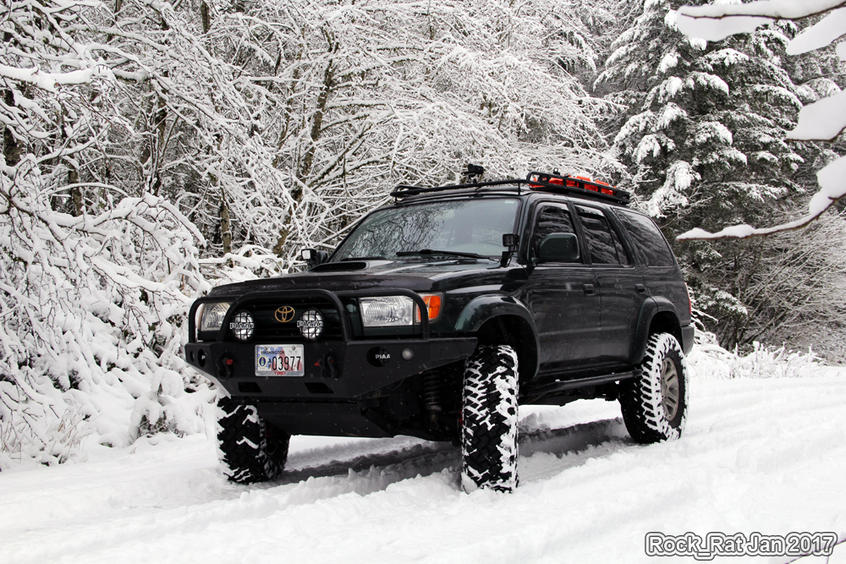

I must admit, I absolutely love my Nitto Grappler Trails. They're E rated, 33's on 17" wheels and 1 1/2" BORA wheel adapters. Never once did I think about needing chains as I have in the past. Here'a few teaser pics of my road.
I have a similar photo from 2006. Amazing to see the transformation that's taken place over the years and the reliability.
Another photo heading back to my house.

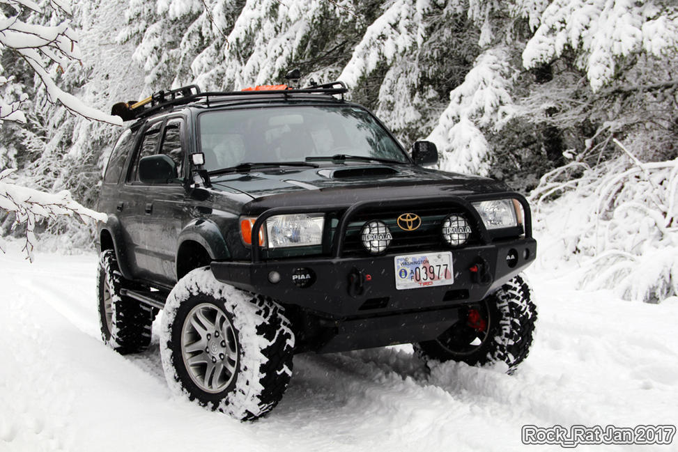

I was half expecting to see a few downed trees across the road, but it was pretty clear. Lovely drive. I actually went out and up another 1000' to see how our roads around the area were.

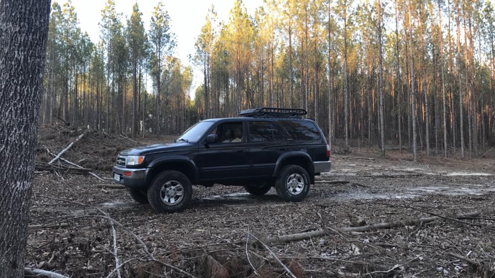

More suspension exercise. So this weekend, a good cleaning, oil and transmission fluid change are in store for her. With the running boards off, she looks even better in the trail!

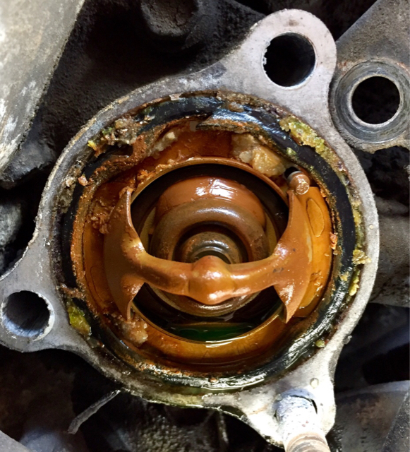

Replaced this beauty:
(Thermostat)
...Cleared codes P0125, P0130 & P0133.
...Little things mean a lot.
...Those codes returned eventually.
I replaced the upstream O2 sensor last summer, so that's not it.
Cleaned MAF & throttle body recently.
Thought there may be too much back pressure, so today I did this:
Original muffler, 191k miles.
Replaced by Magnaflow 12586.
Reset ECU. See what happens.
...Little things add up.
