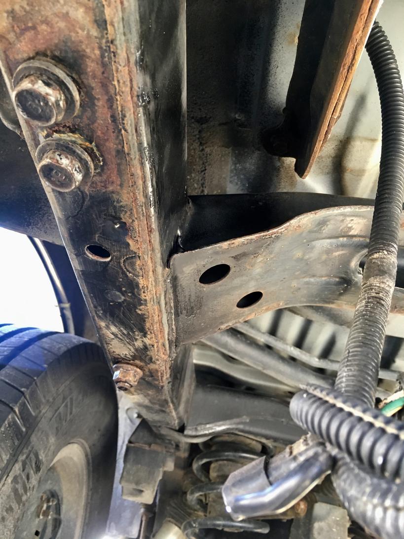

After removing the hitch I had to spend some more time with sandpaper and rust converter under the back end. Here's the before shot:

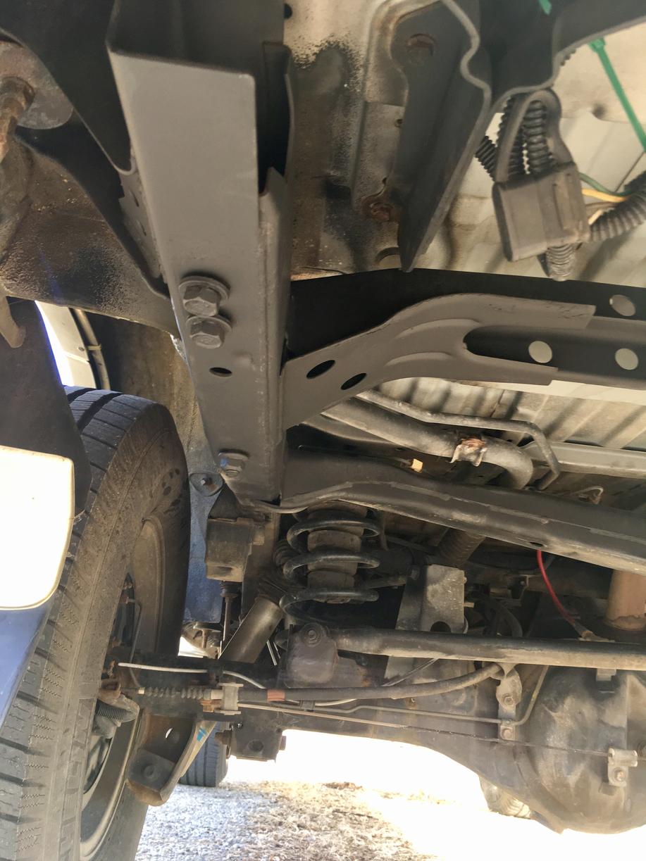

...and the after shot:
Looks good! This will be on top of my "to-do" list after some other general maintenance things I have planned. This gives me the hope and motivation I need to just get down there and do it. Nice to know that mine isn't a lost cause and it can look that good before spring!
