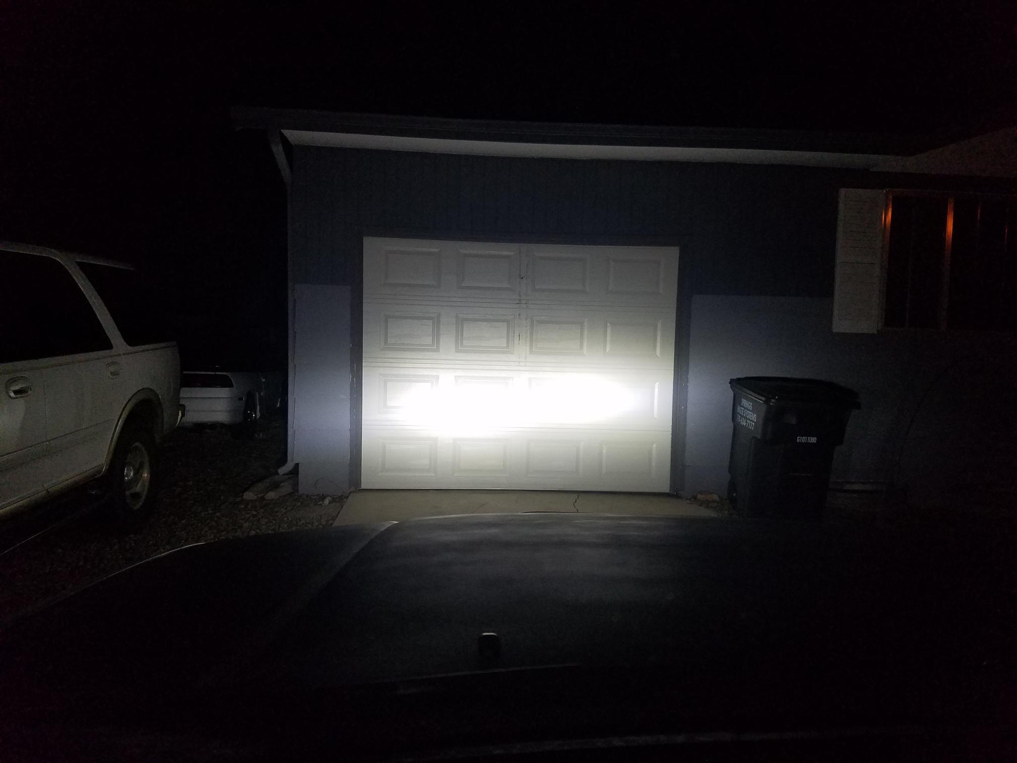

Adjusted the cheap led bulbs. Left one a bit lower to avoid blinding. I parked my rig in road and drove by in wife's truck to see how bright and they didn't seem to blind me at all. When I first turned them on wife freaked and said this had to be illegal. Ha. So far no one flashed me and if I left halogen brights on i got immediate flashes.

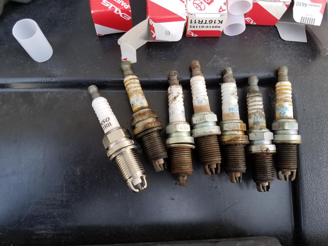

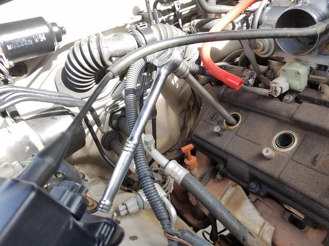

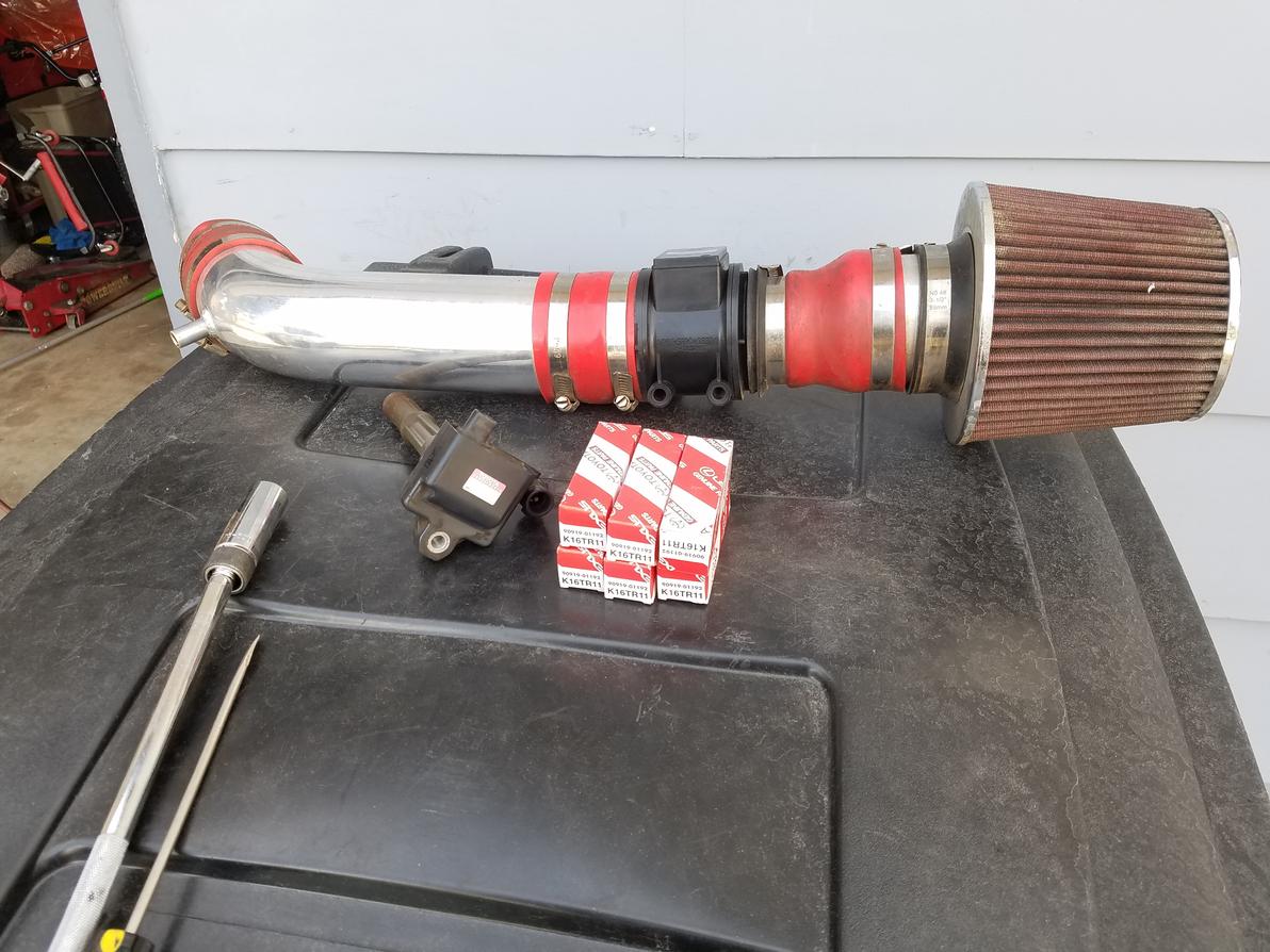

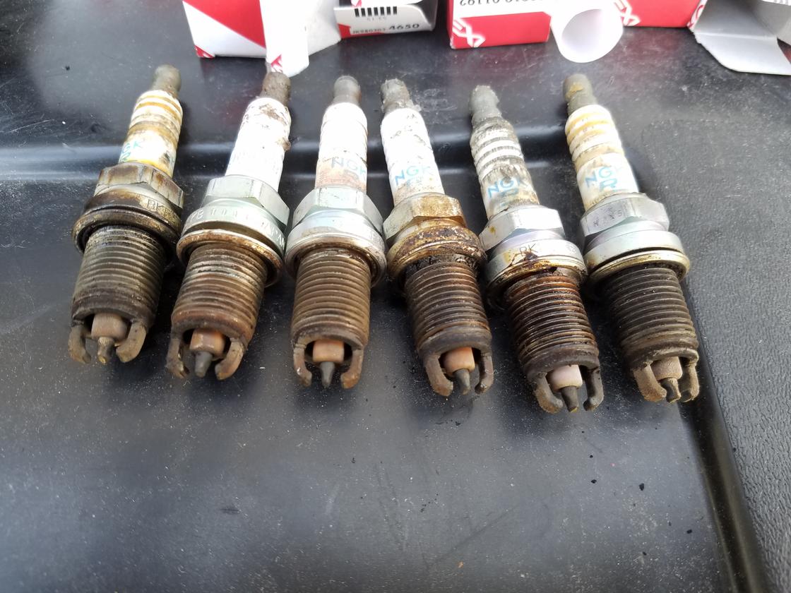

Did the spark plugs. The rear cylinder on passenger side was seized. When backing out it tightened up and stopped. Sprayed with pb blaster and backed it in and out over and over. Ended up using 1/2" ratchet and prayed to toyota gods it wasn't misthreaded or broke. It came out and all was good.
The really clean tipped plug smelled like gas. Wonder if that's my misfire. Noticed high rpm misfire but no CEL. Time to test drive.

How many miles on those plugs?
