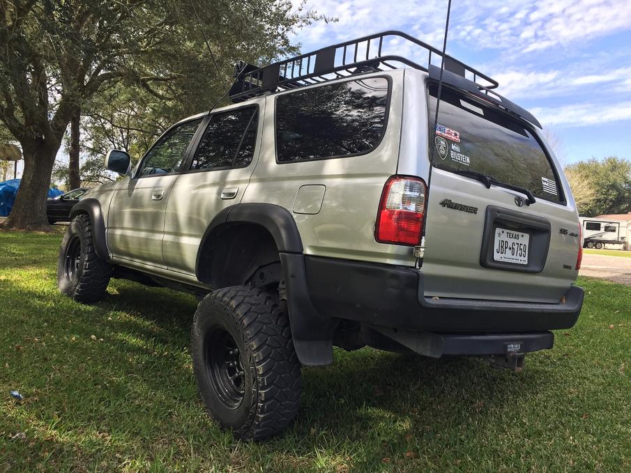

I think it looks rad. Go to the last page and see my rig with fully bronzed-out wheels. Mine look way better in person, and the dirty truck with faded paint doesn't add much to the photo, but the wheels look great! haha

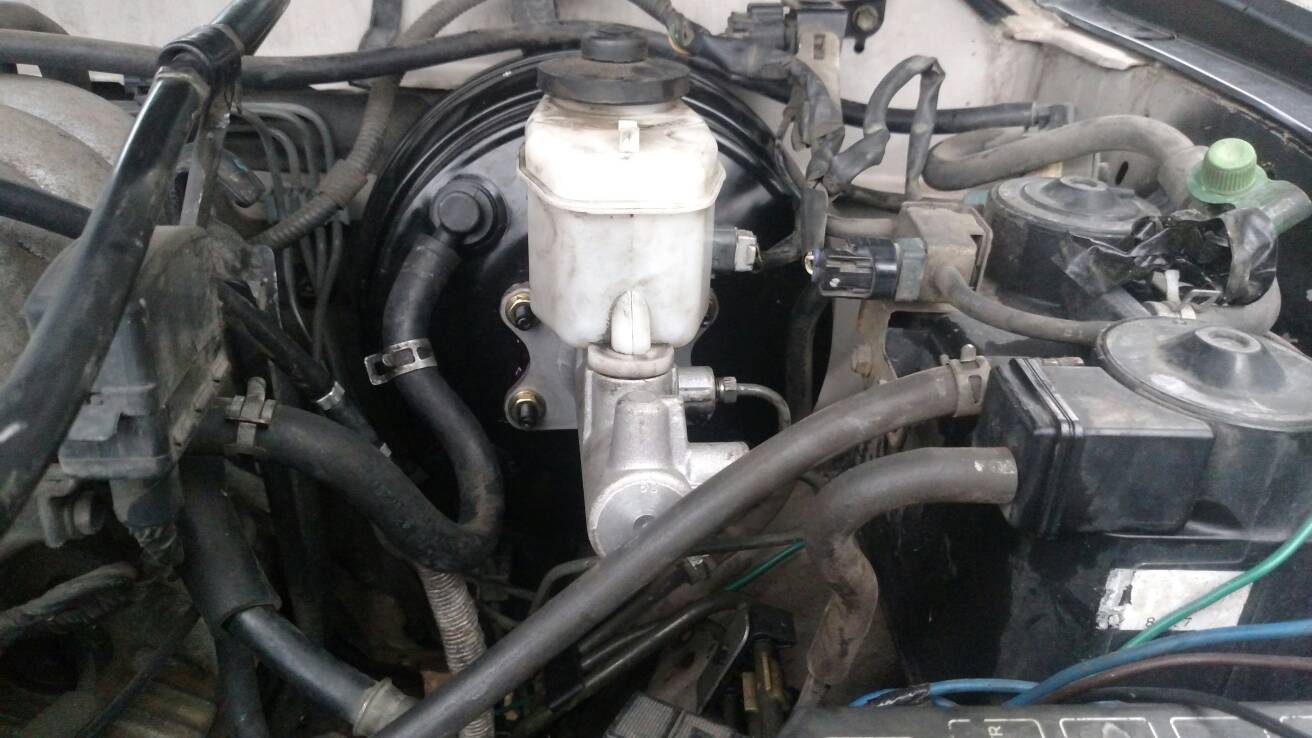

Upgraded to 97 t100 1ton brake booster and master cylinder. To help with tundra 231s. Way better brake pedal now. Write up in my build thread if anyone is interested.

thanks for this. I am still putting together parts for my TBU. Might have to add this. I am also replacing all my brake lines. I wonder how many people complain about soft pedal after doing a TBU and keep their 16+year old rubber brake hoses. They can swell with increased pressure if old, like an artery about to burst.
I used the non ABs master
Not sure on part numbers. I'll definitely be going with stainless flex lines for the front. I need to do pads and turn the rotors soon, so I'll be doing it then. Never enough time in one weekend to do everything my truck needs lol.
Build thread: http://www.toyota-4runner.org/showthread.php?t=219718

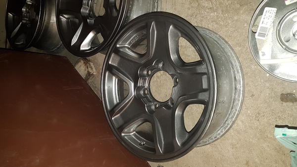

Like the looks of the gold. I'm working on mine right now with the duplicolor dark grey, letting them harden up in the furnace room.
