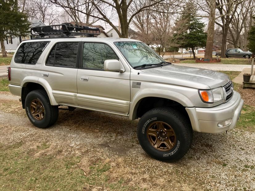

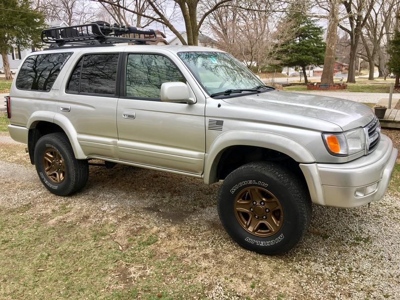

Painted the wheels
Finished up painting all 5 (including full size spare) wheels. They were in pretty poor shape before, with peeling clear coat, chipping paint, dings and scratches, etc. I used isopropyl alcohol to clean them thoroughly, followed by some 320 grit sandpaper to get the major offenders, more isopropyl, masking, then three coats of Rustoleum metallic primer + paint in "Rustic Mist" color, and finished with two coats of Rustoleum crystal clear enamel. I'll have these professionally powder coated next time I buy new tires, but these ones have enough tread to last another year or more and I didn't want to continue to have them look so shabby until that time.
