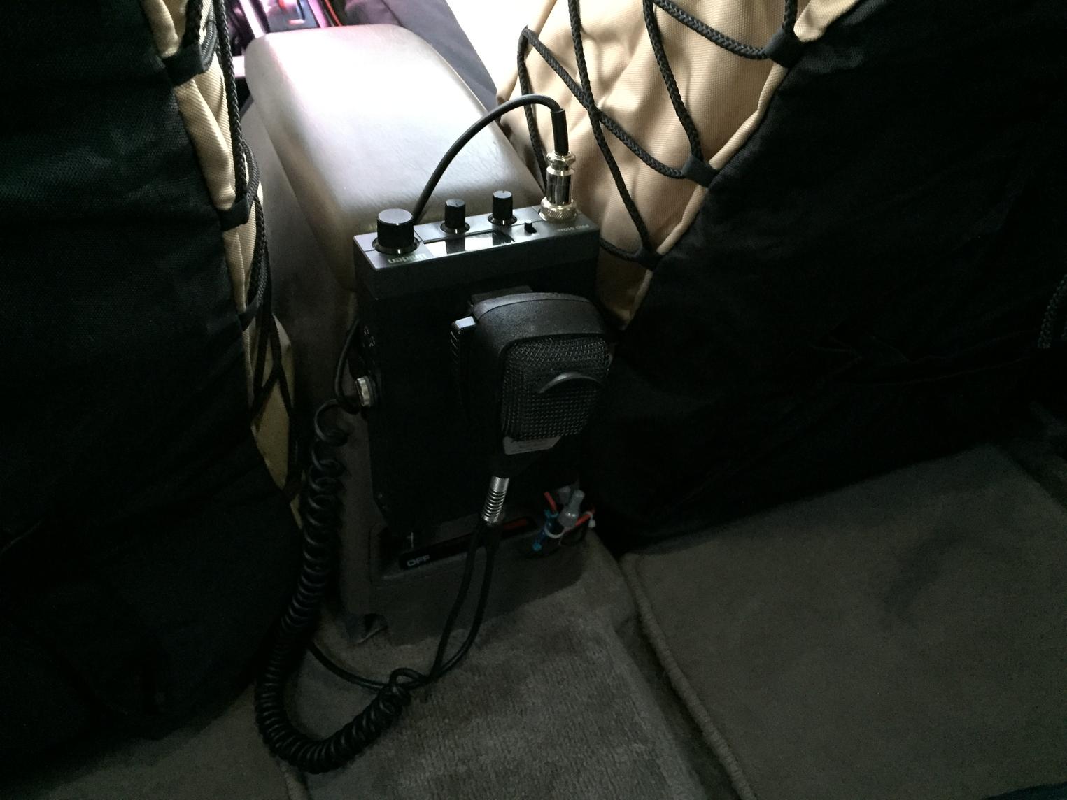

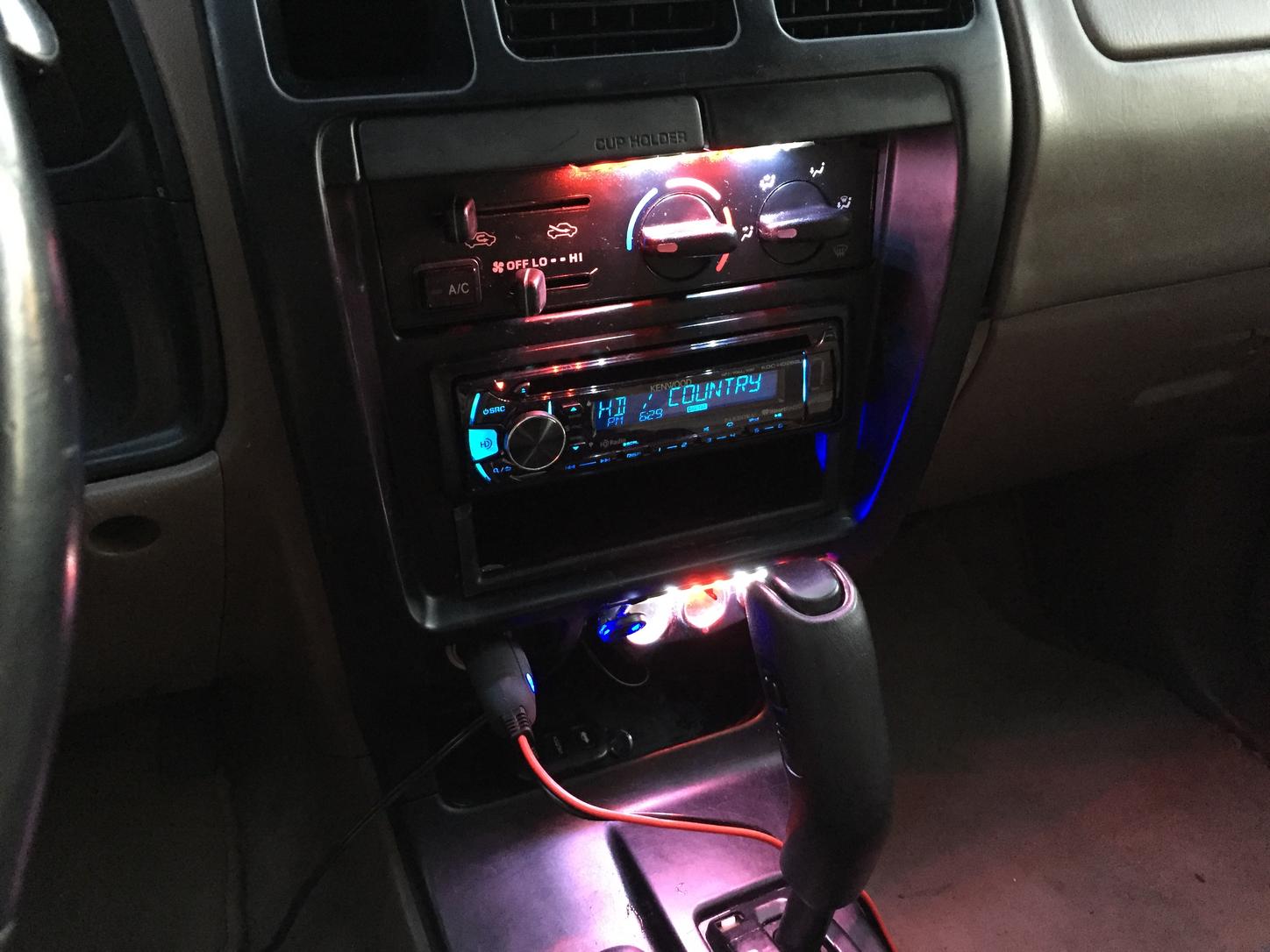

Finally got a picture of the Kenwood stereo and subwoofer. Then mounted my Uniden 510 CB Radio on the back of the center console. I used the existing holes for the backseat drink holder. I went with a K30 magnetic mount antenna.
