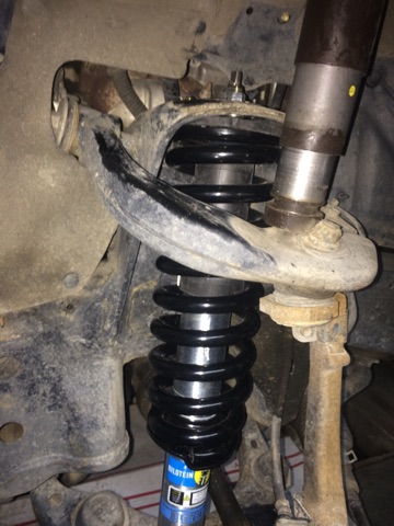

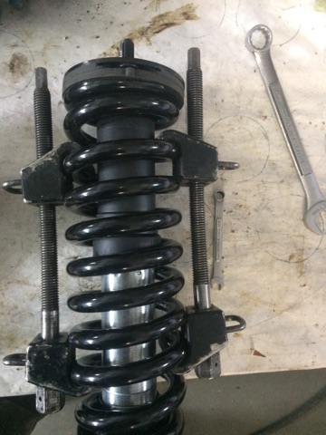

LOL....sucks to follow that...but alignment day is Thur., so I put on my 880/5100 4Runner fronts on bottom perch. Super easy thanks to the great people on here!!! Added some KYB Strut Mounts and it all went together as expected. Need to drive it before I update how much lift I gained.
Oh yeah BILSTEIN DOES NOT PROVIDE ALL THE NEEDED PARTS FOR THEIR 5100 FRONTS. They make you spend even more money and buy the parts yourself.

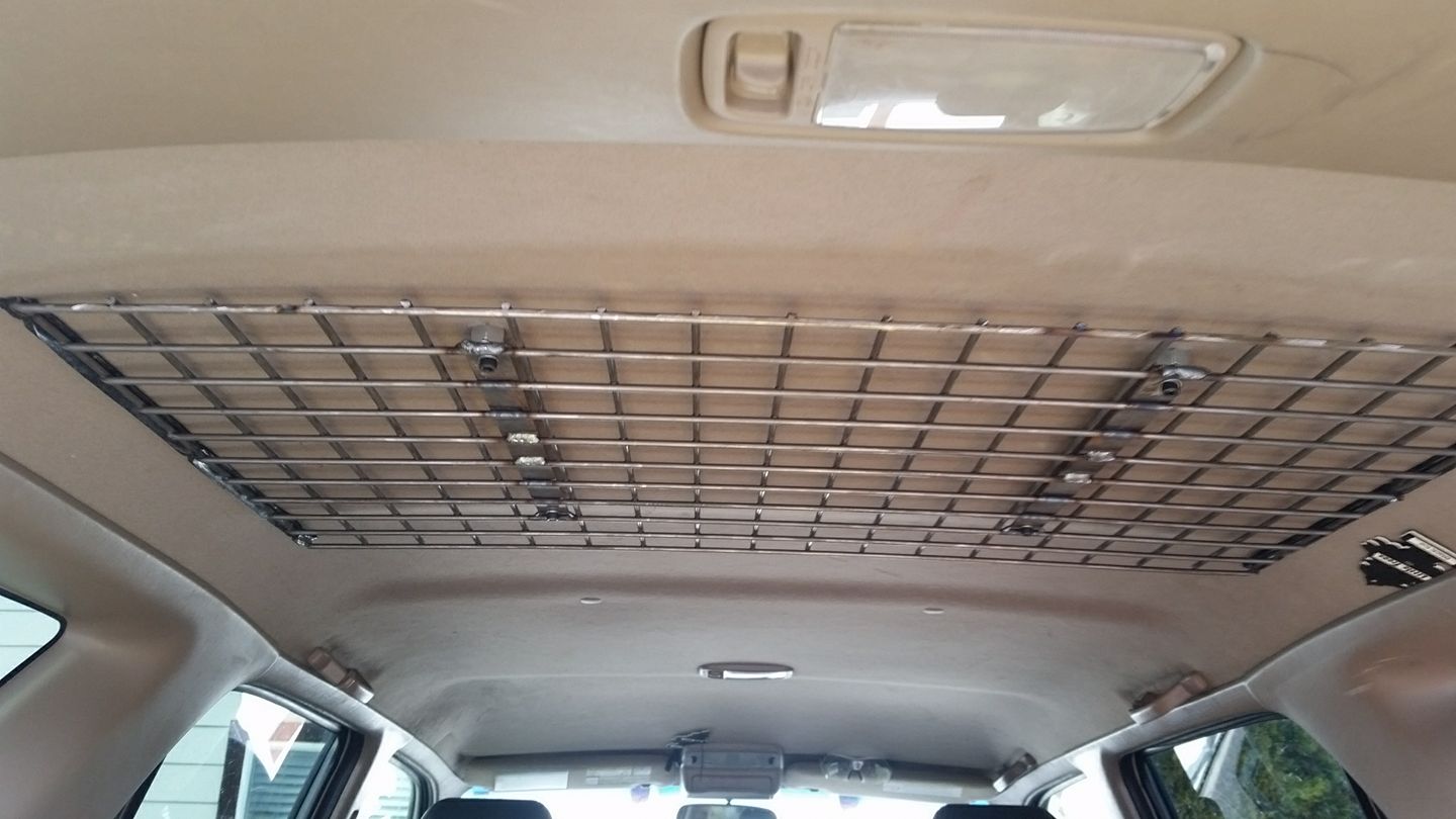

Since Saturday, I build a roof rack, rebuilt and installed some CVs, cleaned up some wiring, and installed some lights. Pictures in my build thread starting Here.
What extra did you need to purchase for the fronts? Do you have Tundra or t4r specific?
Is that screwed in to the roof, or just through the headliner? Been wanted to hang some stuff (cargo net, lights), but wasn't sure if the headliner could support it or would just sag.
I used M6 riv nuts in the existing holes for the 4 rear headliner clips. Had to drill out the clip holes a little. But the stock clips still fit if I want to take it down. I didn't want a net swinging in my line of sight. First thing I mounted to it was my fire extinguisher - I can't even see it in the rear view mirror.

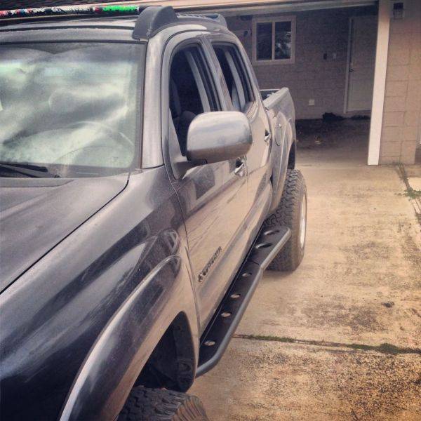

I just got an e-mail from BAMF that my sliders shipped today!
I ordered them on Black Friday! LOL :rockon:
Ordered with kickout & fill plates like these.
Bilstein for the 4Runner.....Bilstein does not provide the needed grommets and washers for their fronts. They actually expect you to use your old worn out crap. WTF???? TOTAL BULL CRAP!!! No one else does that and they charge top dollar for their stuff. Knowing what I know now....for my situation...if I was doing it over...I would have gone Rancho or KYB.

Wow that's crazy. I had a feeling I was missing something. Now I can't assemble before hand to make it easier. Unless I can purchase the items somewhere local.
