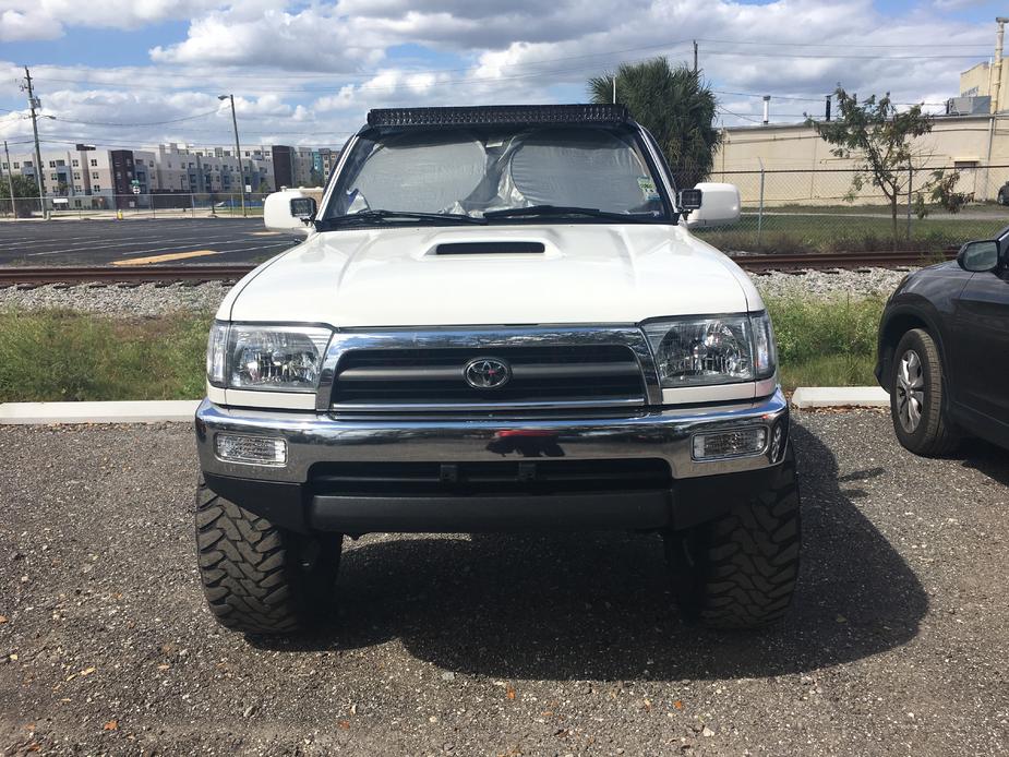

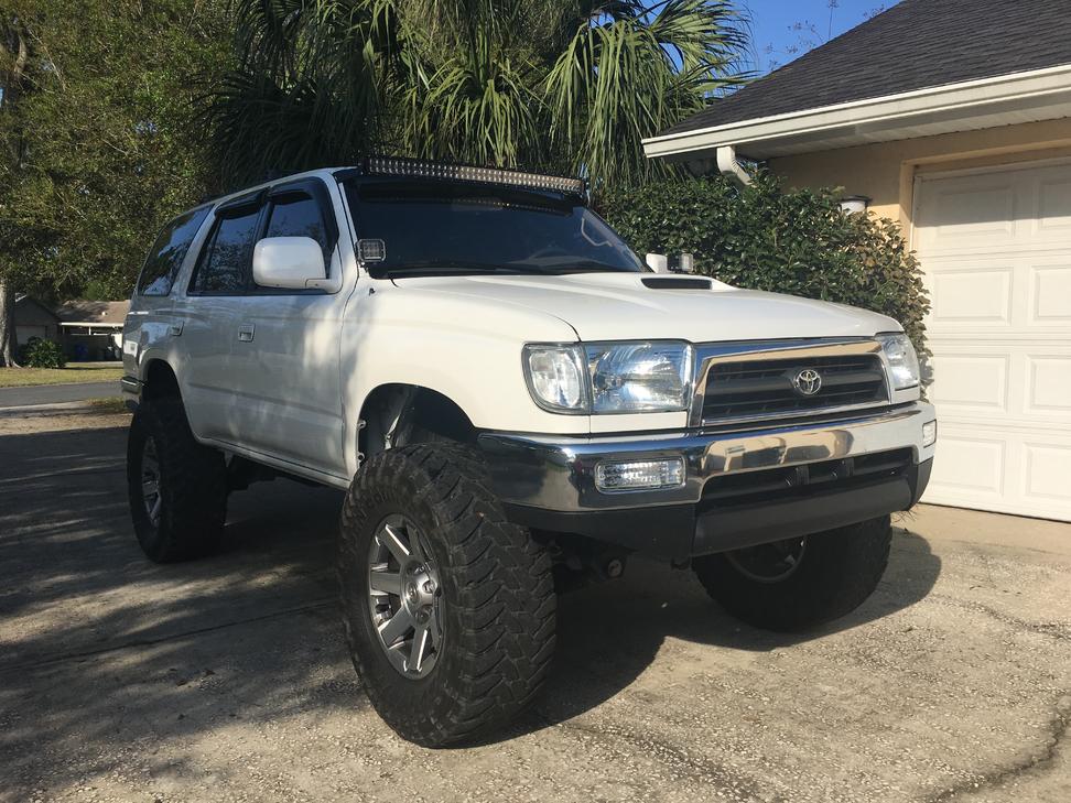

What brand of bracket did you use? I am curious how the lightbar mounted up and any other details. Thanks!
I ordered this light bar from Amazon
LED Light Bar Nilight 20 Inch 126w LED Work Light Spot Flood Combo Led Bar Off Road Lights Driving Lights Led Fog Light Jeep Lights Boat Lighting ,2 Y https://www.amazon.com/dp/B00WE47FVM/ref=cm_sw_r_cp_apip_QySHFfJqlKTWY
I ordered this wiring harness/switch from Amazon
Nilight Off Road ATV Jeep LED Light Bar Wiring Harness Kit 12V/40A Relay On/off Switch ,ONE Year Replacement https://www.amazon.com/dp/B0155W7EDS/ref=cm_sw_r_cp_apip_n7ny3arHGkaEK
Then I mounted it to the underside of the the license plate mount that is in the bumper. I bought nuts/bolts from Home Depot and didn't have to drill into the bumper. Here's the best close up pic I have
Then I bought this license plate bracket from eBay
https://www.ebay.com/itm/301935846193
Cheers
Cheers
thanks.....added to my project list
Is is steady there, or does it bounce around much? Thinking about mounting in the same place.
It is very steady, but, the light is angled ever so slightly upwards. I maxed out the position on the mounting brackets but still wasn't able to get the angle zeroed out. It's not noticeable when looking at it from the front, but if you get down eye level with the light looking from the side you can tell

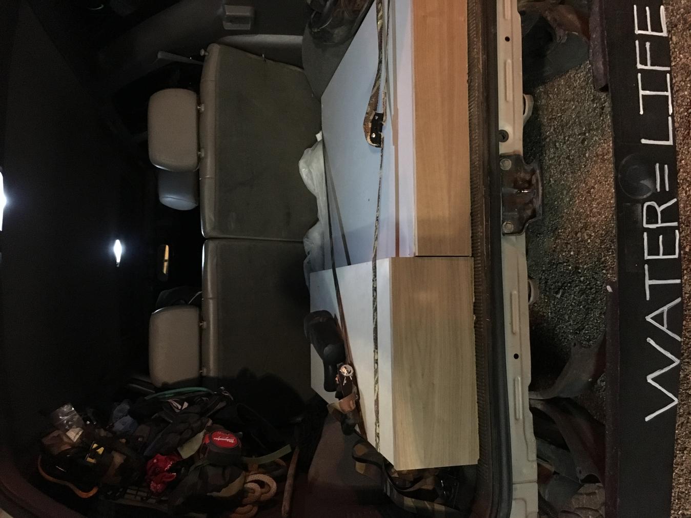

My friend and I built these tonight. So far super awesome.
I'm going to build the brackets to bolt it down soon.
I'm making a box for the back. I was thinking of bolting it down but then the carpet will compress a little over time and it will loosen up. Plus then you'll have permanent indents on the carpet. Instead I am using turnbuckles and chains to tighten it up in every direction (down, front, back, left, right), attached to the black D rings. I bought a few extras and put one in the middle of the back near the hatch. I'll put some fabric under the lower pieces of wood to even out the pressure it puts on the carpet. I've done the bottom layer and this thing so far is SOLID.
