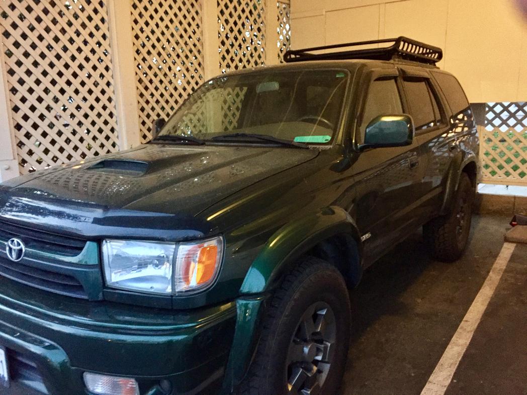

Added a cheap Rola rack today and 99 tail springs in the rear to level out the stance.
