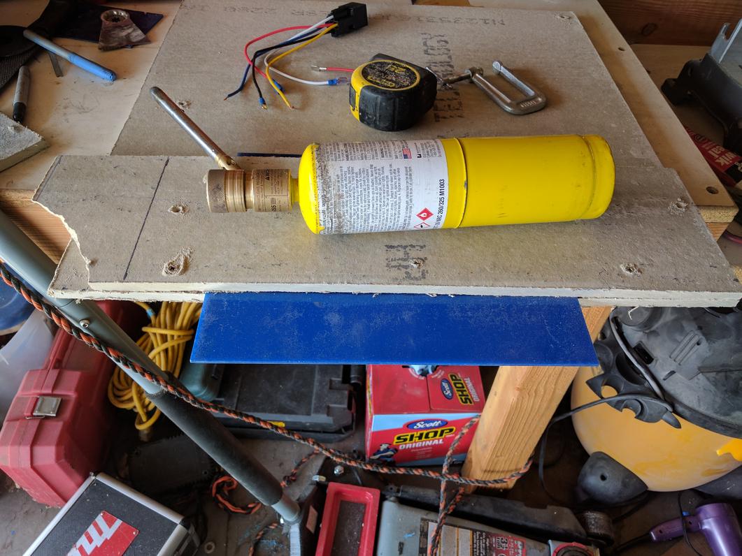

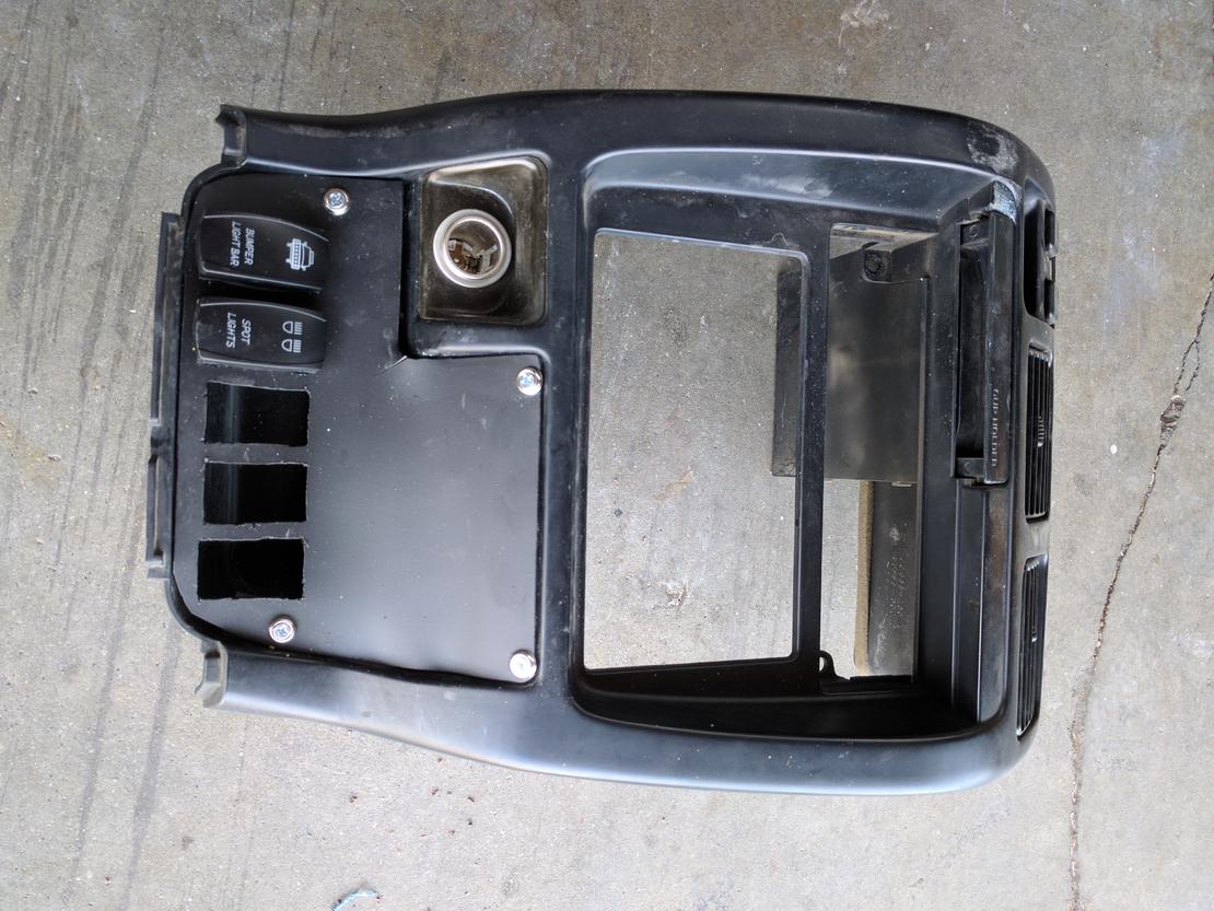

Testing out my acrylic fab skills. I've never even played with this stuff before. It's a bit tedious but it formed a lot easier then I was anticipating. I'll paint it black so it blends before the final install.
How did you reshape the acrylic?
Sent from my SM-G930T using Tapatalk
I used a grinder with a metal cut-off wheel for the outer cuts. I used my plumbers torch to form the plastic. I used my multi-too to cut the Carling Switch holes then cleaned them up with a file.

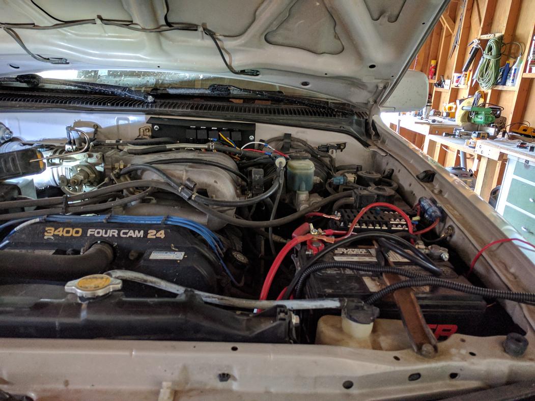

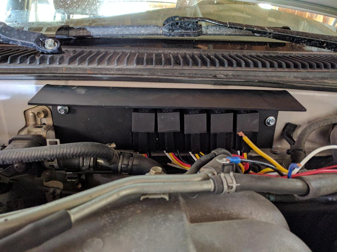

I kinda got inspired by [MENTION=57546]4-Ripcord[/MENTION] and his fuse/distribution set up. So I've got in way over my head with wiring. I really only have to get the winch and bumper lights hooked up but figured since I'm in there I might as well pre-fab it all. I might skip put on his fancy firewall pass-through though and drill a smaller hole and fill it with silicone when I'm done.

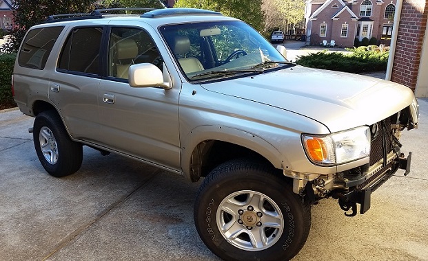

Installed OEM replacement antenna mast: The end of the old antenna plastic strap appeared to have broken off. After removing everything to get to the motorized assembly, I opened it up and found that a 12" piece of the old antenna had broken off inside, so I am glad I took off the quarter panel flare and shroud over the wheel to get to it. What a PITA fix to a seemingly small, reasonably predictable problem! Clips, shroud grommets, plastic brackets for the 2" flare, flare trim pad (runs along the flare where it meets the body), and antenna itself total inc shipping was $174. OUCH! But I am proud of the fact that my 4runner antenna works like new now, no idea why I feel that way.
Anyways, I am going to get a new coat of OEM color paint and clearcoat. The original flare trim pads had all faded to white, so I decided to go ahead and pull off all the flares prior to repainting, and will be replacing the old trim pads rather than just having the body shop paint the old trim pads and flares while attached to the body (since the paint would eventually crack along the trim pad seams over time). The the trim pad color I ordered was "champagne", and appeared to be an exact match for the 4runner original color, Dorado Gold.
I also checked the breather valve on the diff and it was not seized up, which was stunning given all the mud I've cleaned off the bottom of this 4runner.
Shrockworks bumpers (front and rear), sliders and skid plates are on order, cant wait for that stuff to arrive!
I uploaded a pic of how she sits today.

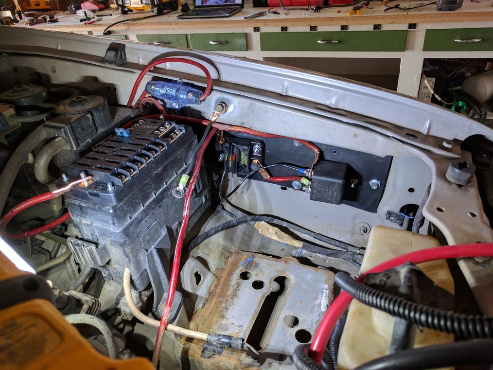

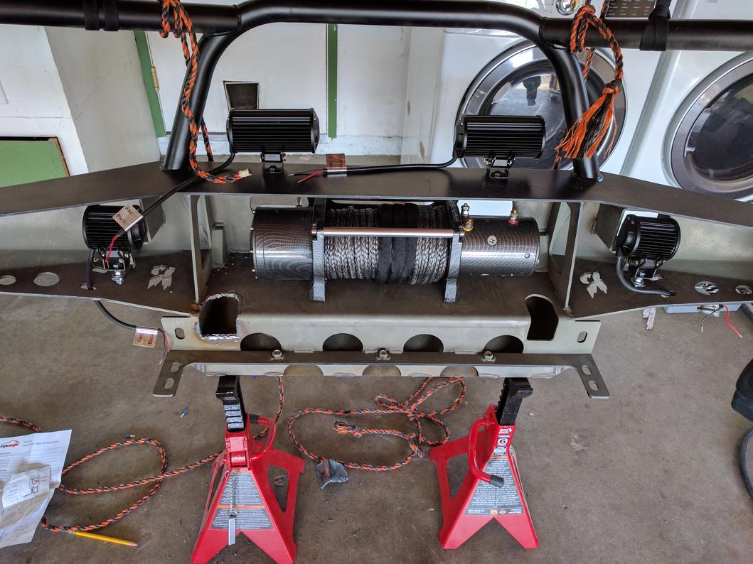

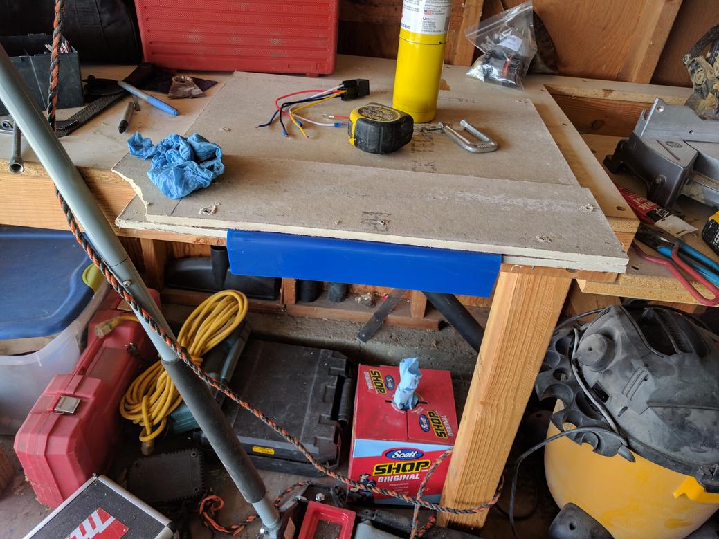

Finished up a few things. Wired the 15 buck wireless controller to my winch control box. Cut some mounts for the electrical stuff using that acrylic. Primed and painted the mounts.
Got the main electrical done with a breaker and relay that stuffs nicely behind the battery. I still need to clean it all up but it's still in testing phase. Made a mount for all my 40A relays then mounted it on the firewall just below the hood. Finished the 3/4 amber LEDs in the factory filler panel. Played with my filler switch panel to replace that useless cubby hole and ashtray. WTF is with an ash tray light any way? Ripped apart the drivers side trim to gain access for the firewall passthrough. It's gonna be cut in right where the clutch would be. Then realized I didn't have my hole saw kit with me. Finished hooking the battery back up and tested everything. Blinkers work great and look pretty good too. The wireless winch controller works like champ. At least the small remote does. The larger controller doesn't work but that's what you get when you use cheap crap. I'll call Amazon and get a replacement on it's way.
I want to give a thanks to [MENTION=10169]TheDurk[/MENTION] for all his electrical diagrams he posts here. I verified pos and neg on the LED's I used before I pulled the battery to do the electrical work. After I hooked it all back up and started the rig I had no blinkers. None, zero, zip. So I check everything and it's all wired correctly. I'm going into full Mattdown(my wifes name for my meltdowns) mode when I get on the net. First hit google returns is a thread TheDurk posted that flasher/blinker circuit on. I quick look and it dawns on me. The hazards aren't even plugged in because I have the center console apart to make my switch plate. Derp. I'm an idiot. So I plug them back in and everything works again. Thanks TheDurk. Much appreciated man.

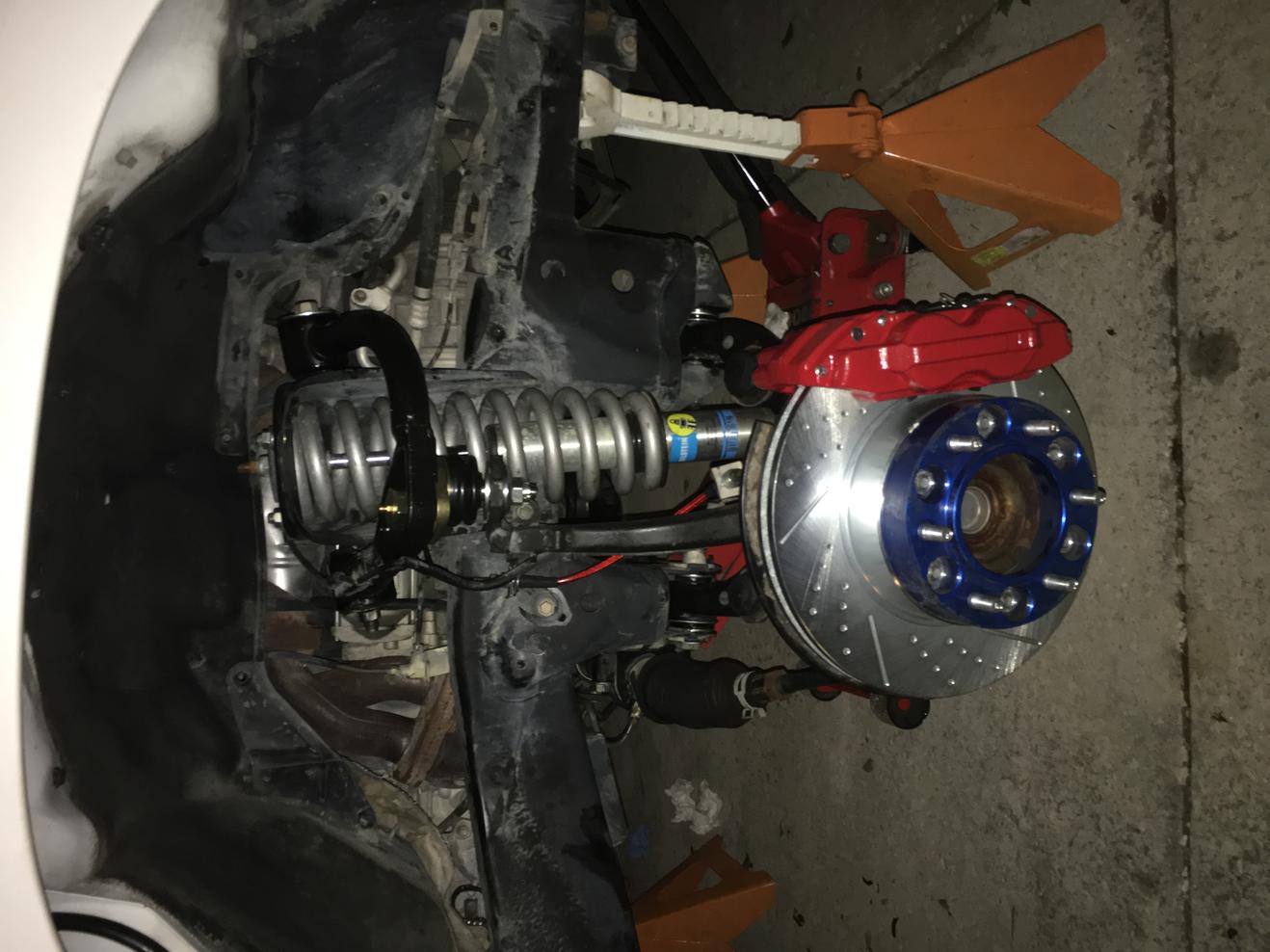

Over the weekend installed:
SPC UCAs
Whiteline Polyurethane LCA Bushings
Energy Suspension Steering Rack and Front/Rear Sway Bar bushings
Power Stop Tundra brake swap with the towing brake pads
Wheelers Red Stainless Brake Hoses Front/Rear
4 new front sway bar links for the Front and Rear. The rears dont bind up anymore now that the inks are longer
Got it aligned today (picking it up tonight) but even with the alignment roughed in the truck felt completely different and so much better.
The brakes are phenomenal. Its great to not have the brake shimmy and they bite hard I could put myself through the windshield if need be lmao
Next project is to drill and tap for new bolts to hold my skid plate on and beeline my inner fenders
(Sorry for the $hitty pic it was 1:30 this morning when I finished up. Definitely should have started on saturday)
