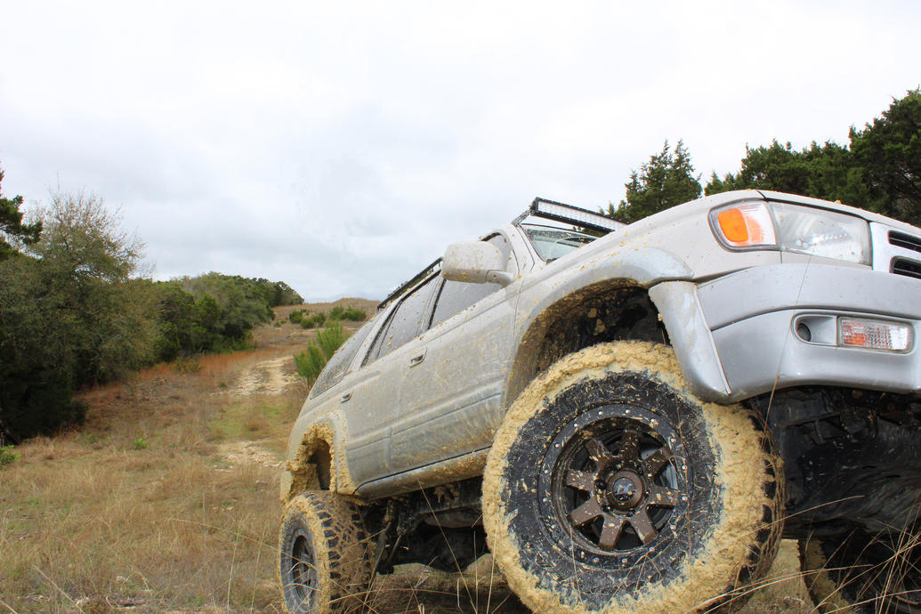

Get her dirty:p
Damn it. I was so set on 265/75 but now I'm having my doubt. If I remember correctly you never re-geared. So do me a favor to help me out. Go drive up a grade that you know and give me your feedback on how much doggier it actually feels then the 265/75's.
The rigs looking really good man. Keep it up.
I have not re-geared. I have not had much drive time on these things yet. Only like 20 minutes or so. They are nice to look at though. Having said that, I like 265/75/16s just fine. That is what I am most used to though. With 265/75/16s I didn't have any rub, the speedometer was accurate, acceleration was good (for an SUV), and I could fit a full size spare underneath the vehicle.
The 285s will have to earn their keep. LOL. I think it might be one of those things where you can look at a million pictures, read account pros and cons, but for me, I think it was just something I had to check out for myself. So I am giving it the old college try.
I will let you know how driving goes this week man!

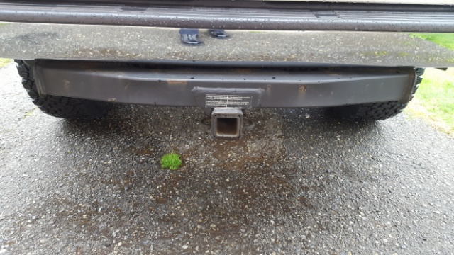

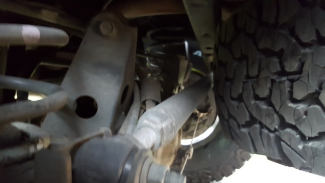

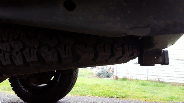

I can fit my 265/75/16 BFG KO2 under the vehicle. I think the determining factor might be the particular tow hitch you have. My mounted tire does not interfere with my pan hard trac bar, and I am using the larger SS bar vs. OEM.
Have any pics of your hitch and or fit?
Here are a few pics showing my hitch and tire clearance.
As you can see in the pics, my tires is almost, if not touching the main body of the receiver at the insert area. Tire clears the sides. Tire clears the rear area pan hard trac bar. I haven't tried to put the tow hitch receiver in to town anything, but as long as it doesn't insert past the hitch body, it should not interfere.

The above pictures are the factory hitch - which is what most guys here have and what will normally be used as a 'will it fit' standard.
-Charlie
