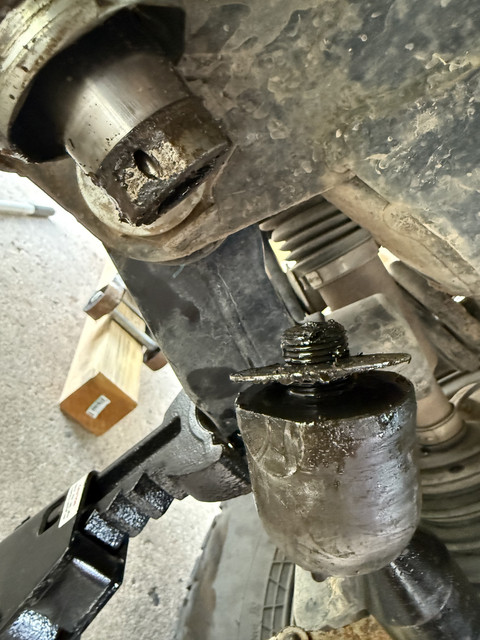

Went to straighten my steering wheel by adjusting the outer tie rods. Previous owner says he “got it perfectly aligned except the steering wheel being crooked. Turned one side 6 turns in and the other side 6 turns out. went to back it out of the driveway and one side popped right out!
Friendly reminder to hammer down the edge of the inner tie rod washers to the flat spot on the tie rod itself, after it’s tight. That would’ve prevented this from happening!! Although, it took like 10-15 turns to screw back in so it may have almost happened on its own!! Especially seeing the grease all over the threads, i suspect it was partially unscrewed already.
anyway it’s all back together the correct way and the wheel still isn’t straight but it’s better lol
