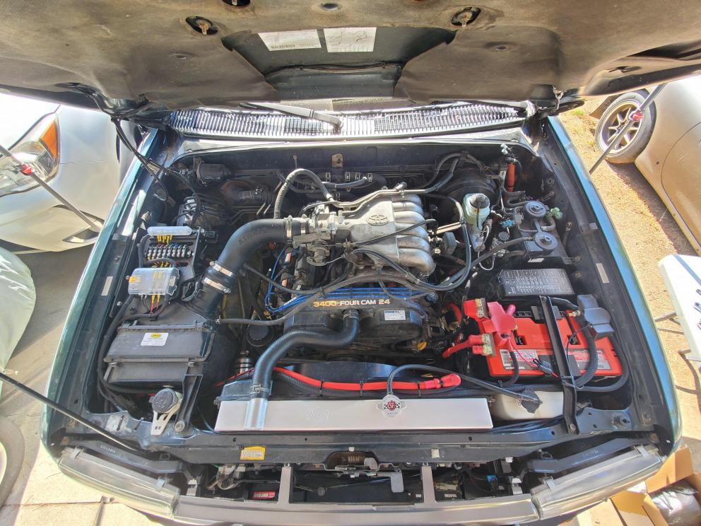

Well after 3500 miles, I swapped out the Eibach coils for the slightly beefier Toytec lift coils. This allows me to run the same lift (~3") without having to set preload and my added weight Addicted Offroad bumper. Again, using the jack method and having done this 3 times now in the last 4 weeks, its a pretty quick job. Got it done in under 2 hours.
Ride quality is much better with the Toytec coils and no preload. The Eibach's felt good as well without preload and I think any spring will feel much stiffer and more harsh by adding preload so I wouldn't recommend that if you dont need it.

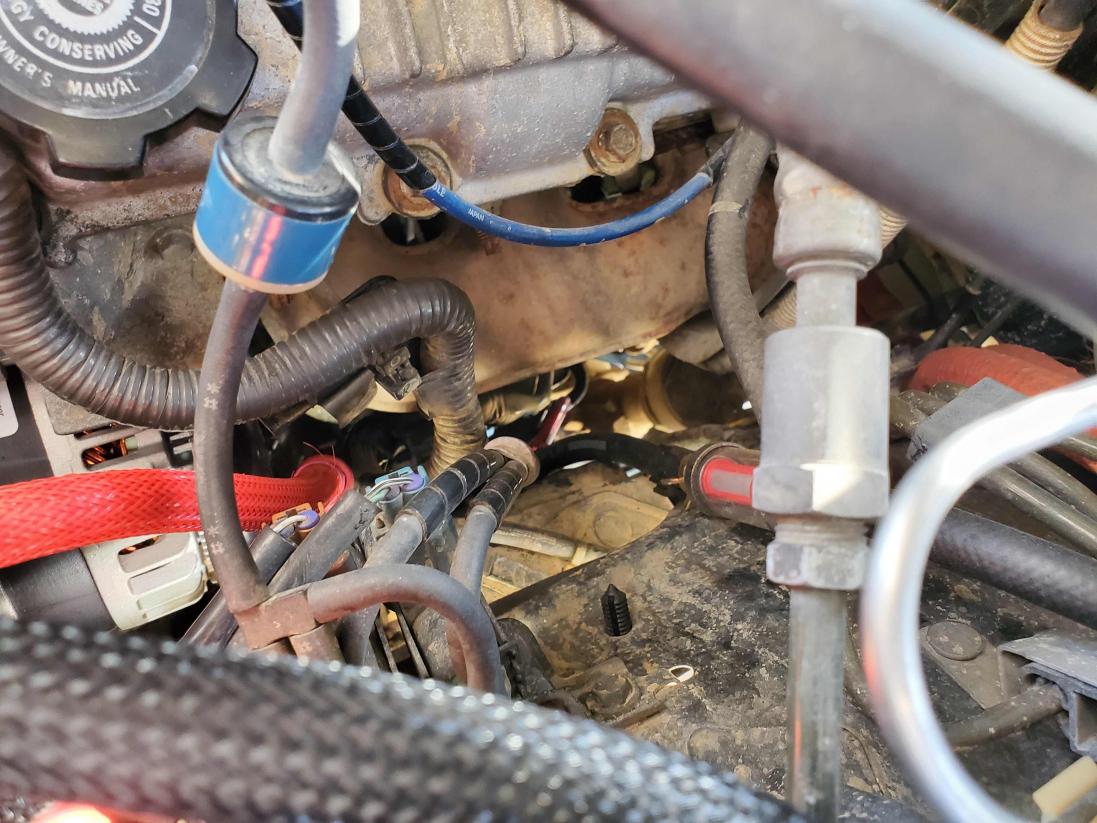

The oil leak is back but thankfully its not the VCs and its just a front main seal that seems to be the culprit. I'm almost over due for another TB change so in around ~15k or so at 250k miles, I'll probably do the 2nd TB change on this car and we'll see if I can truly have an oil leak free vehicle for a bit.

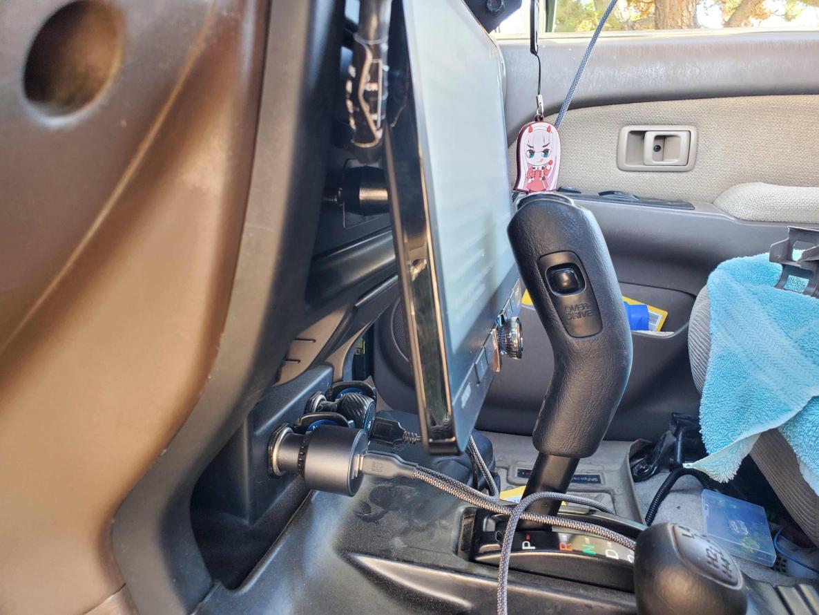

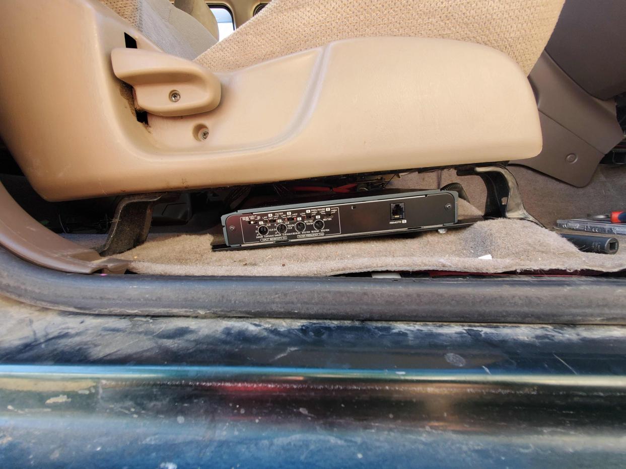

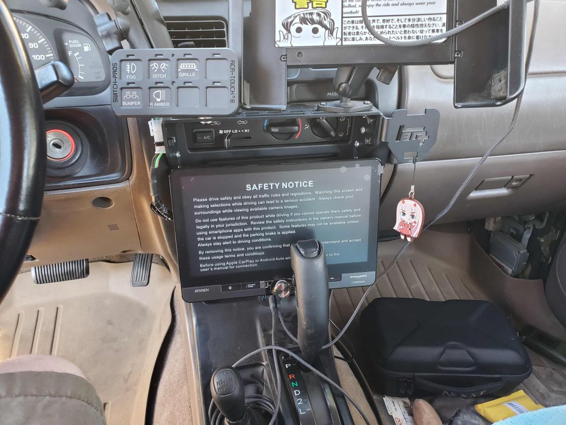

Today I started on the stereo install. Started with the head unit as I knew it would take the 2nd longest. So since I go places where I have no cell service (Spotify won't work and I don't have a subscription yet) it needed to have sirius xm on it. And also the expandability to add a front and rear camera (that will be a later date). So I set with a jensen 10.1" floating screen. I knew the screen is pushing the limits regarding fitment. Wanted the 8" screen but it didn't have sirius xm.
So fiddled with it for a while and was able to get the head unit pushed back 1/4 of an inch, which got me about 1/4 inch clerance from the shift lever. I'm also using the teq offroad accessories mount seen in pics. So that limits the up travel I can go with the screen.

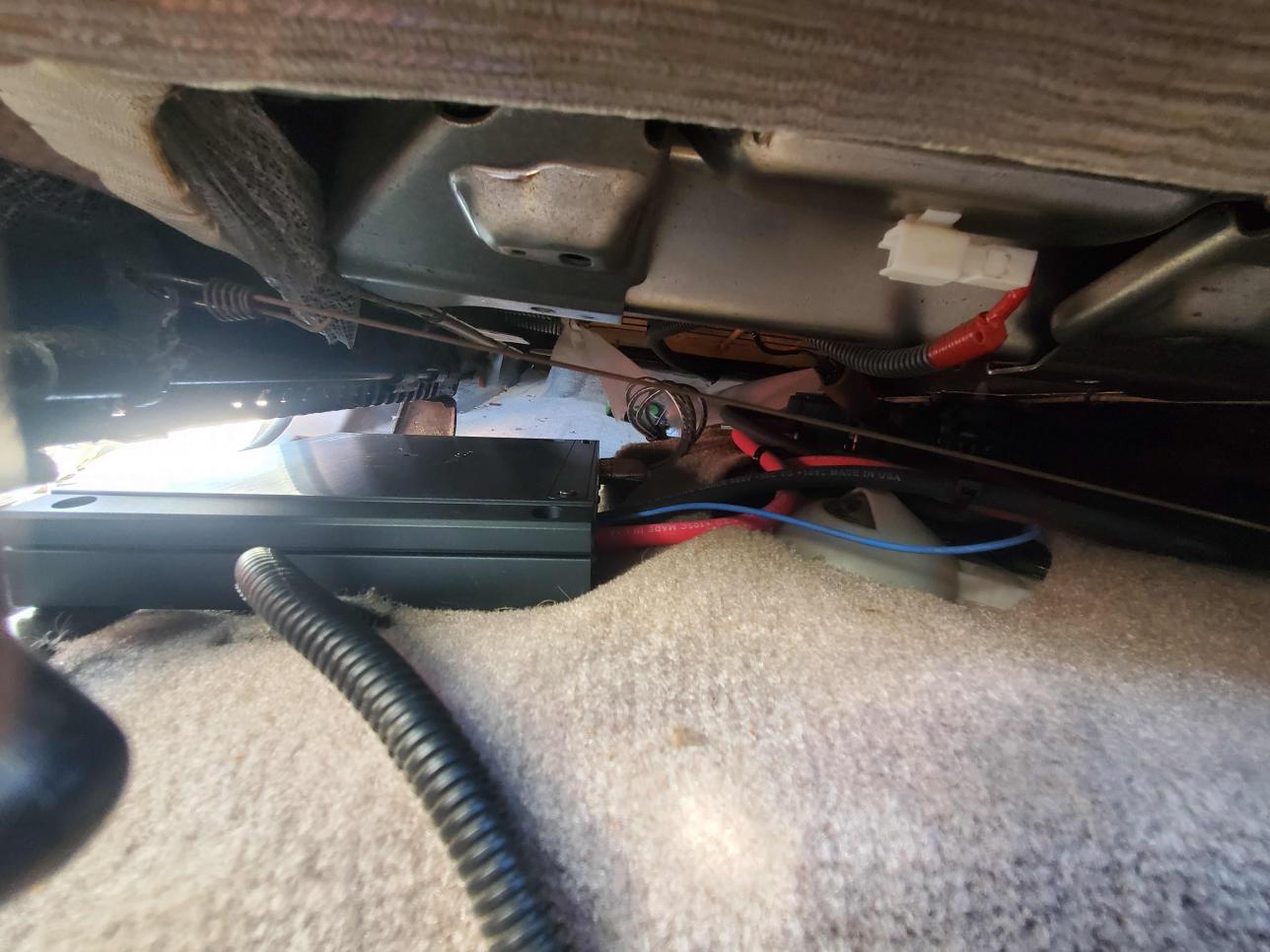

Made a amp mount using the seat bolts and allowing me access to all the tuning nobs and switches. Done.

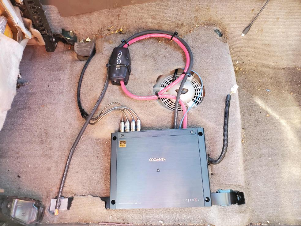

So with that done, I moved on to running the rca cables for the 4 channel amp and sub. Done, easy. Ran the remote turn on, done. Now moved to the power wire for the amp and sub, sigh, lol. Well it went right where the clutch pedal would be. Used a gland nut to seal everything up. Done. Ran the wire (4awg) to the distribution block, done. Ran the ground for the amp, crap, I don't have a end that will fit both 4awg wire and a m10 bolt. So cleanned up for th day and will continue tomorrow.

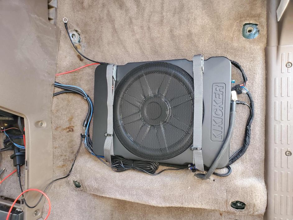

Tomorrow will be the speaker wires, the powered under seat sub (drivers side), and speakers. Front 6.5" components and rear 6.5" 2 way with mounts I need to make. And will vacuum under the seats for the first time is 25 years lol.

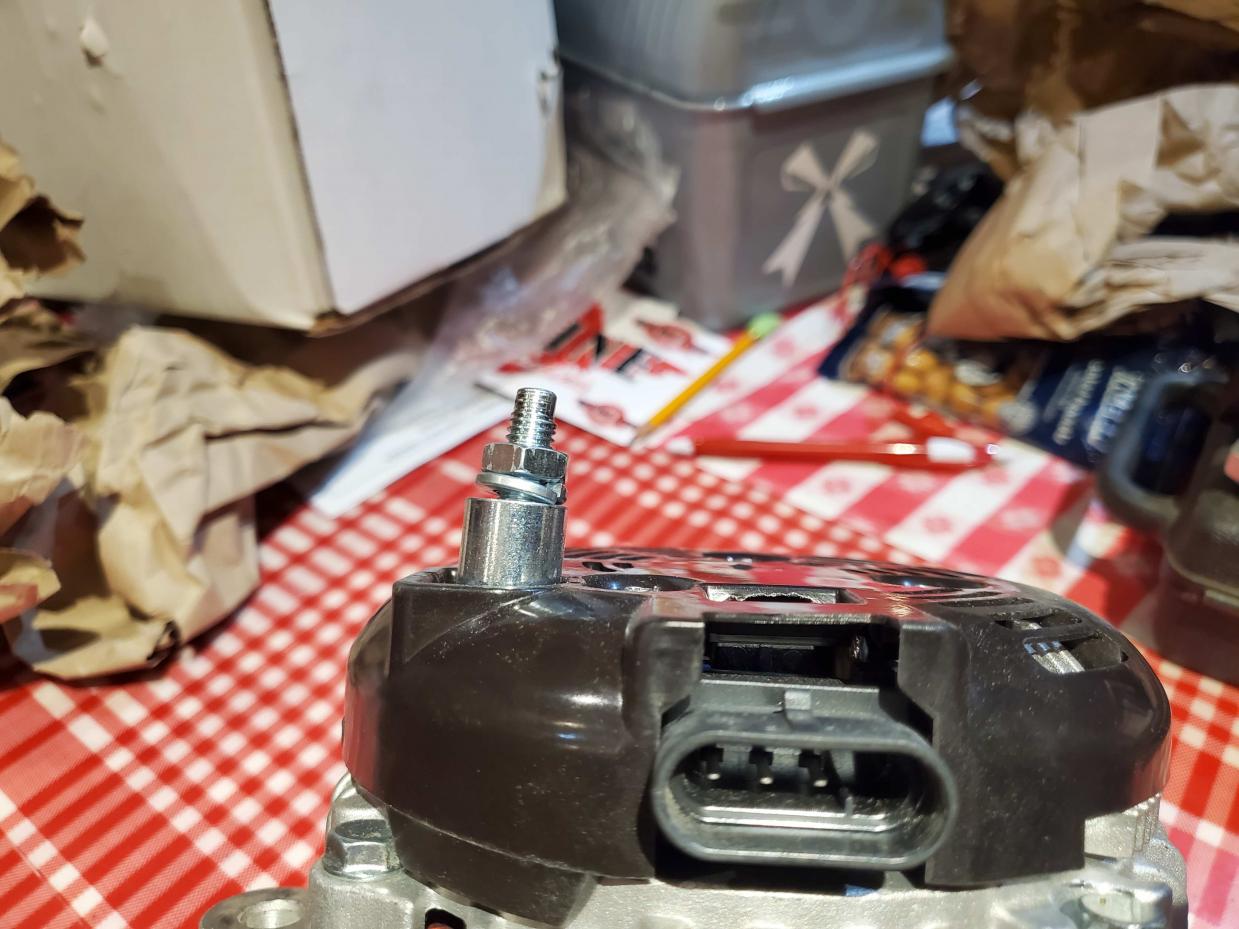

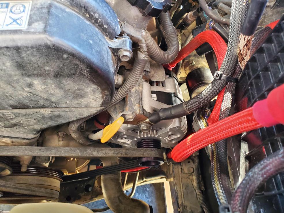

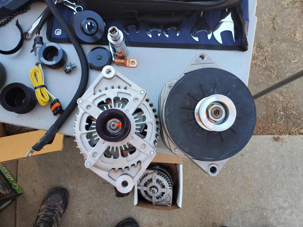

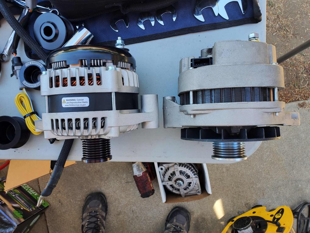

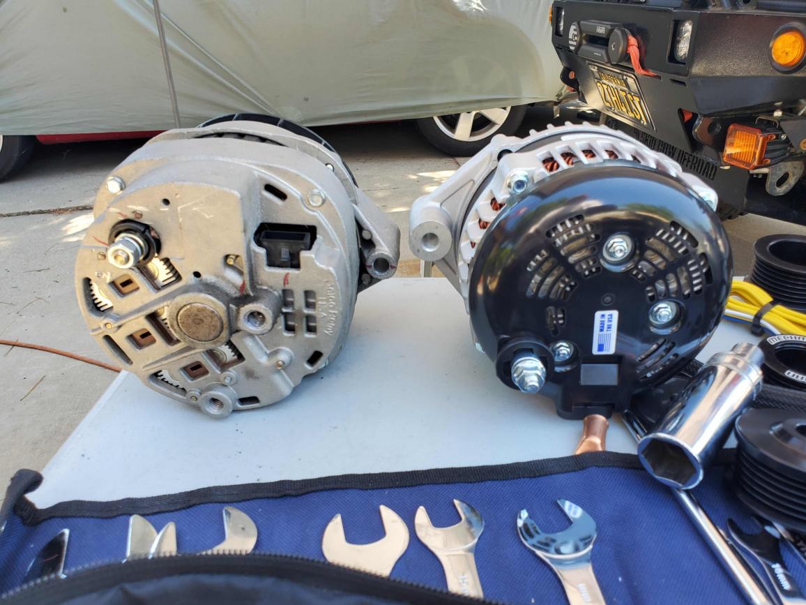

Also my cs144 alternator diy rebuild is failing, yay! So ordered up a mechman 250a alternator, and added an extended warranty.
[MENTION=660839]picantesauce[/MENTION] I too did that with my old trans cooler, turned it into a ps cooler. Now I'm running a tube type cooler as it didn't fit with the new set up.
Which reminds me, after I took all the e-fan stuff off and put the clutch stuff back on, for some reason my trans runs 30 degrees cooler now?! I mean I'll take it, I didn't touch one thing on the trans cooler. Only radiator. But the csf radiator is thicker where the mounts are compared to the koyo and oem. So it pushed the shroud 3/8 - 1/2"" further out, or the fan is now 3/8 - 1/2" further in the shroud. Or the fin design on the csf is very efficient and allows more air to pass. It's wild. And I have no idea why other then these 2 things.

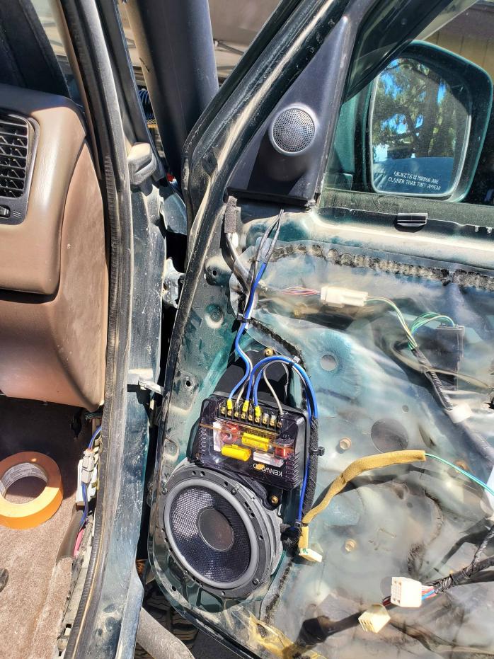

Yep taged the screen moving the 4runner tonight lol. Ok that was a major PITA. My God the speakers took way to long! Funny thing is the rears went the quickest. They are a 6.5" and had to cut lots of door panel to fit them. But I diy'ed the adapters for the rear out of a cutting board. The fronts were from a guy on ebay. They were decent but didn't fit my 6.5 components so I had to use a 1/4 spacer as well. The crossover was a pain. As kenwoods x-overs are huge. But final pic is them installed. I need to get some longer screws for the rear and front.
Didn't get the sub installed today. Ran out of time. Ran all speaker wire with a connector at each door harness if the need ever arises. I set the amp gain to 14.85v (what the speakers rms dictates). That is all I have done, no fine tuning. I will set the tweeters to a -3db as they are a bit to high (titanium domed). But damn, it is clear and bassy exactly what I was wanting. The sub should blend it perfectly.
To add salt to the wound, my new alternator came in, beat up box, and you guessed it, broken B+ post, fudge.

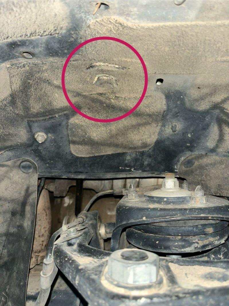

Or more clearance with a hammer... What do you have for front bump stops right now? As long as you have some compression travel left in your front shocks, why limit up travel?
-Charlie
Perhaps, but the accompanying BANG suggested it needs to be slowed
down a bit compared to the 275K factory bumps. The SPC arms and their
relocated UBJ aren't doing me any clearance favors either.
Oh - and yes the x-Axis joints SUCK. All 4 of mine clunk and I'm trying to
formulate a way out of them. Buy Nice or Buy Twice...

Haven't been on here in a while, but I have done a few things. Firstly, I replaces my cs144 alt it was dying or had died with a mechman ad244 250a alternator, hairpin stator dual fans, more efficiency. I talked with them and they said 250a is max you can go with a 4 rib serpentine belt. It was tested to put out 150a at idle and 275a at max output. The last week the voltage has been rock solid. Cold charge is 14.8v and hot is 14.6v. It is a bit smaller then the cs144 too. With some maths I selected a 44mm pulley, putting the alternators shaft speed at ~2040 rpms at idle and redline (5500) ~18700 rpms. Perfect.
