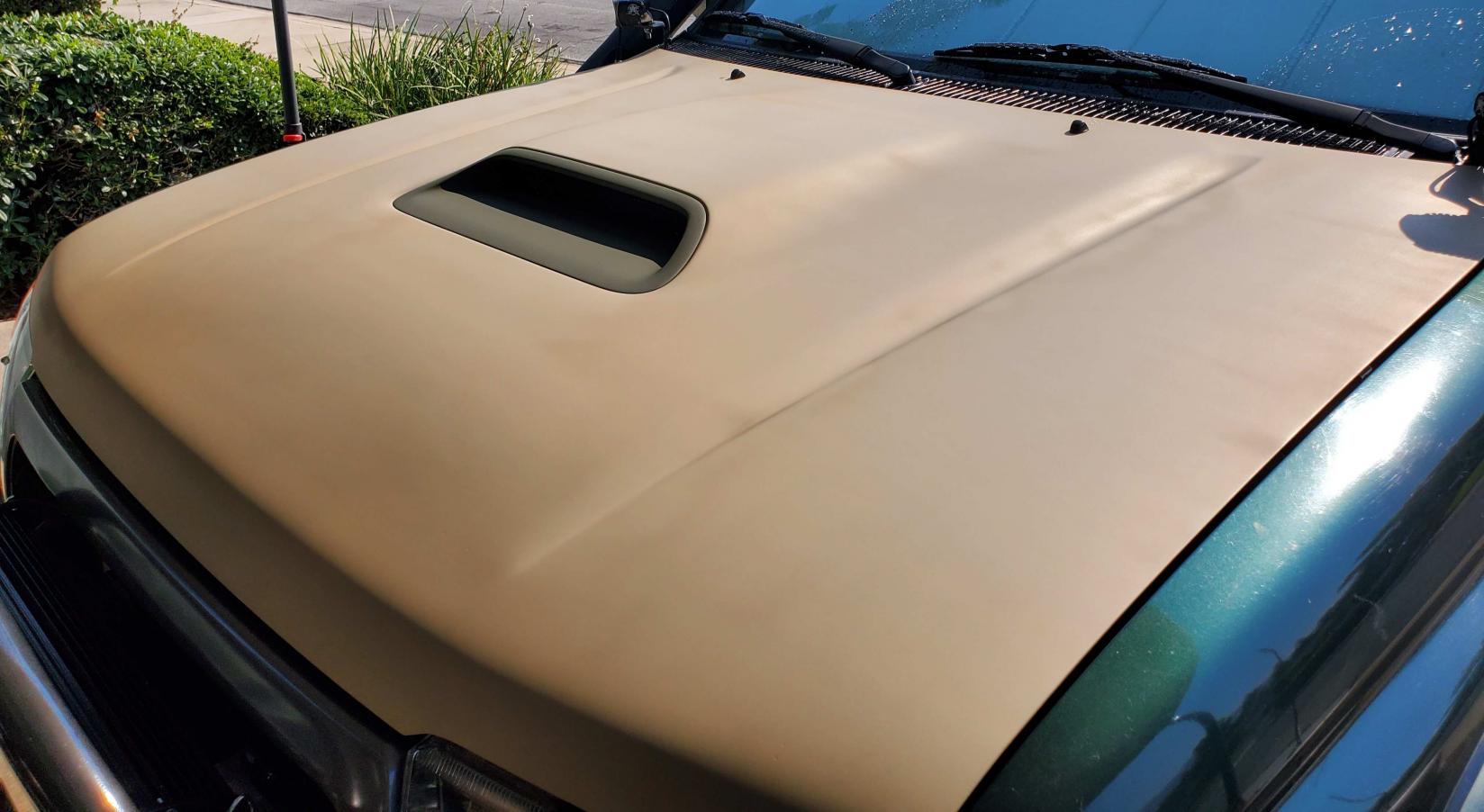

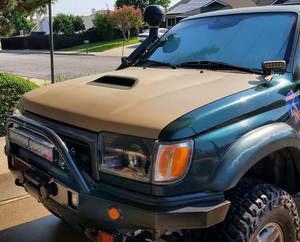

Well I repainted my hood in flat khaki and the scoop in flat od green (took the little grill out and painted it flat black) and proceded to break every clip holding the sound deadning on sigh, and 3 of the 4 studs unscrewed out of the scoop. Turns out, the khaki color looks awful and came out like crap too (spray cans go figure). So once again I'll pull the hood, sand down and this time use an actual spray gun. I was just trying to save some $. Sigh. Oh and it will be sprayed in flat od green this time. But that will be another time as I'm on a tight schedule for this staycation.
are you experimenting to see what color to paint the entire car. I think it looks odd being so different
[MENTION=124615]3bears[/MENTION] No, just repainting the hood and roof as the clear coat is gone and the paint is bad. I agree too the color is to different and doesn't match good at all.

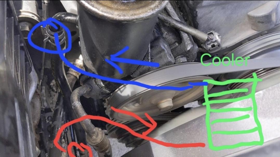

Also, had a spare transmission fluid cooler kicking around. So, I installed that as a power steering cooler.
Care to scribble up a diagram showing how you plumbed it?
Sure. This is the best I could come up with without having to get off my couch.
Basically, the cooler (green) is just plumbed in between the hard line coming from the steering rack (red) and the return line on the PS pump reservoir (blue)
If you need any actual pictures of the install. I'd be happy to get those for you if you need it.
Never mind, I misunderstood your sketch. You spliced the PS cooler into the return (low pressure line), and didn't touch the high pressure line. All good :).
