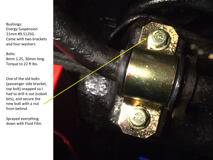

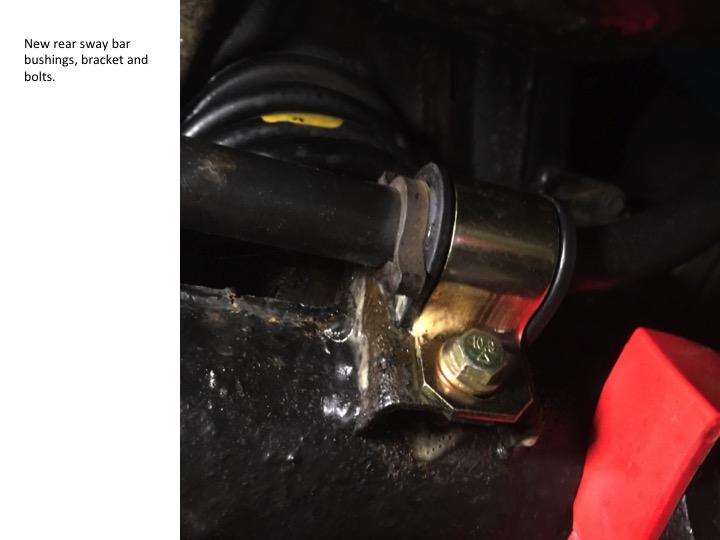

Replaced rear sway bar bushings
Replaced my rear sway bar bushings yesterday. What should have taken 30 minutes took 4 hours because I had to drill out one of the old bolts that snapped. The new brackets and bolts are nice and shiny!

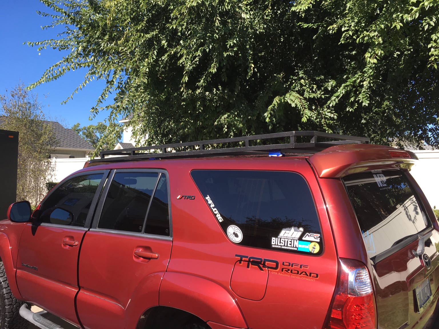

Today was a product weekend for me and my truck. I ended up going up adjusting my bilsteins in the front a little higher. I did a look over on my suspension and I found out my lower rear shock bolt was missing and I couldn't find any local, so I had to order one. I bought a roof rack off craigslist and did a test fit, I need to have new mounts welded on and make a new wind diffuser but for the price I couldn't pass it up.

Ah man, that's what I want my rack to look like. I can't find anywhere around here with the metal mesh for the flooring. very nice!

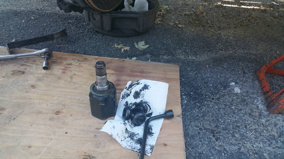

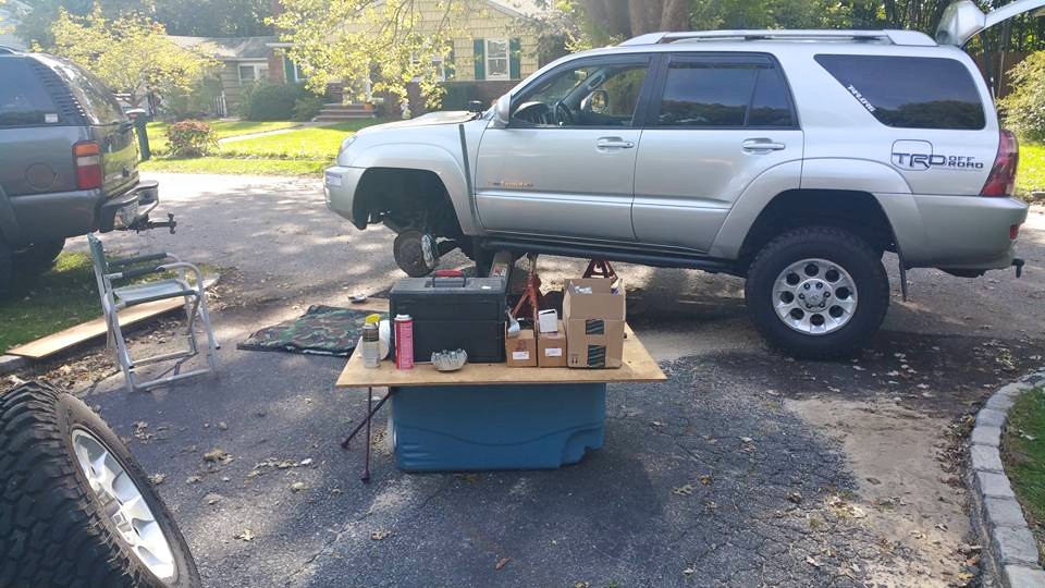

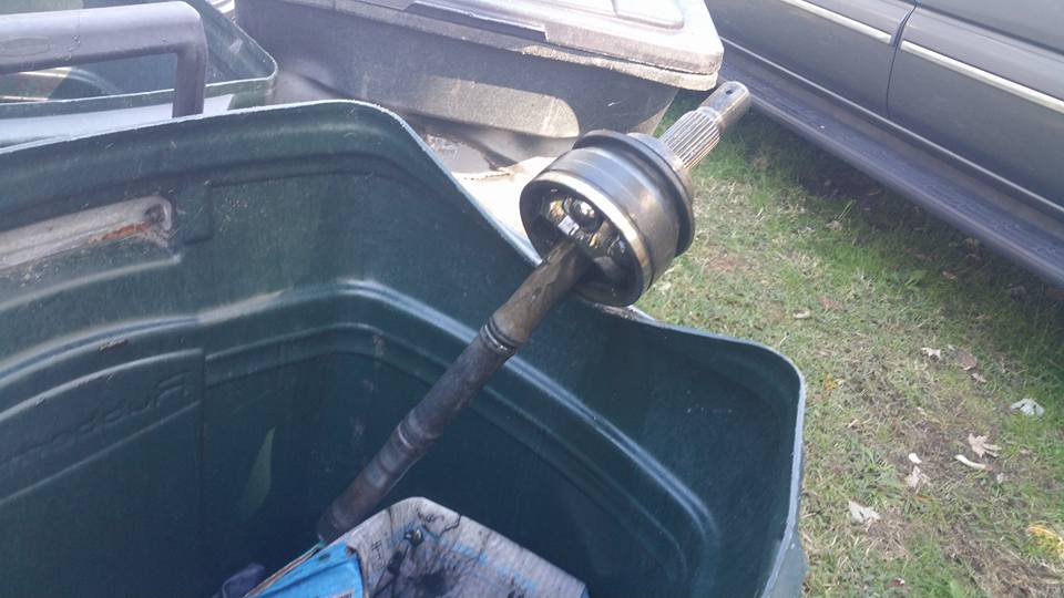

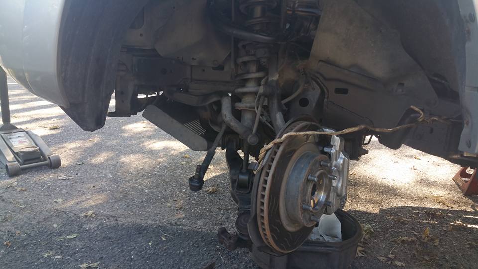

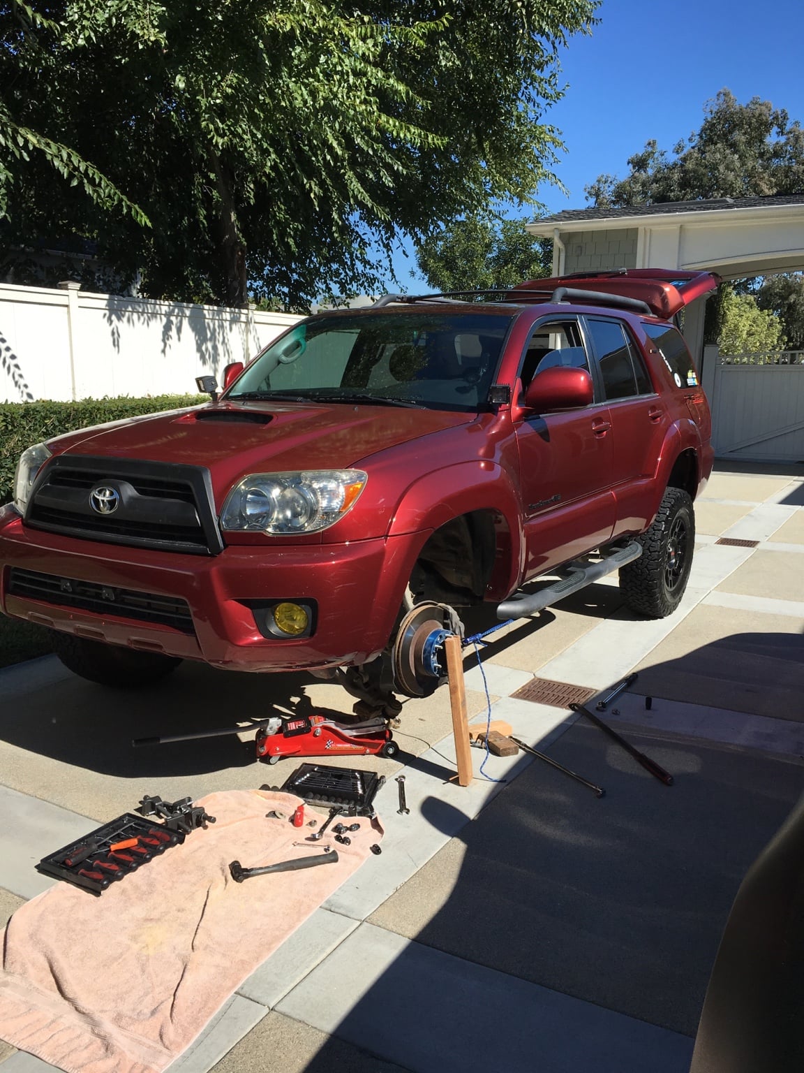

Got a lot accomplished today with the help of some friends.
removed, regreased and re-booted driver and passenger cv axles.
Installed two new down stream 02 sensors.
changed front diff fluid to mobile 1 synthetic

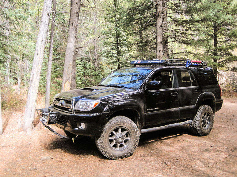

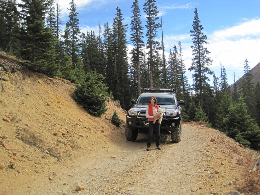

Geneva City Trail
Took my Truck up to Geneva Creek, lots of Rocks, Creeks, and Climbing.
Snow up on the peaks. Tested out my Smittybilt winch, it was pulling hard, figured out my Wife had the brakes on! DUHH

Not a bad looking rack. I almost want to pick up a welder and figure out how to weld. I've got about 20-30 feet of 1" square tubing sitting in the garage, maybe more, that was for a project one of my mom's friends never finished. I'm pretty sure I could make a nice rack out of.

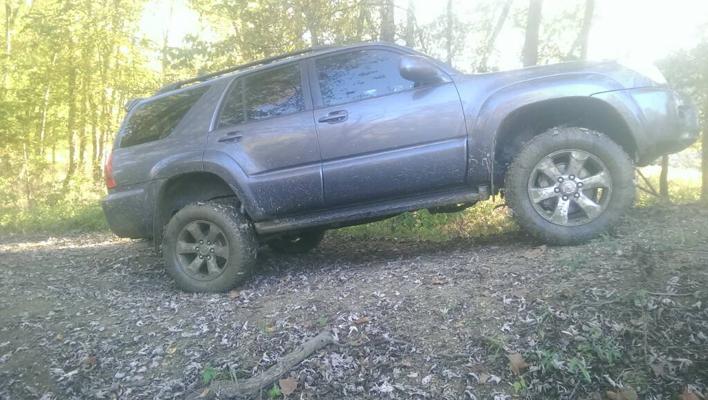

Adjusted my alignment a bit, bombed some gravel roads, then took the mall crawler through some mud holes and up some rock steps with another yota buddy. I was impressed with how well it did on these all terrains with 44psi.

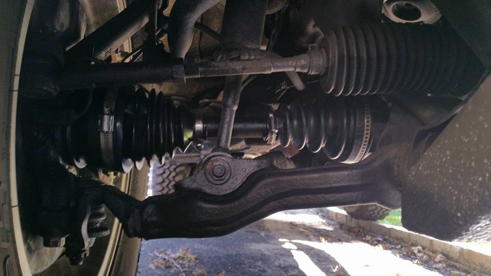

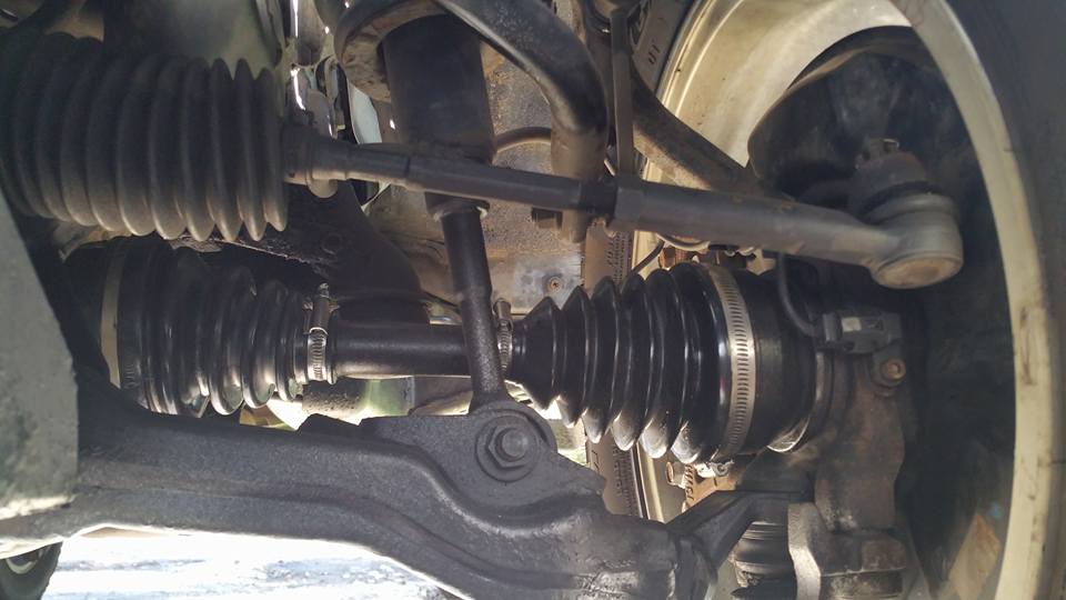

Just checking on my CV reboot job from yesterday, making sure nothing is leaking or the clamps did not shift after about 75 miles put on it. Everything looks good to me.

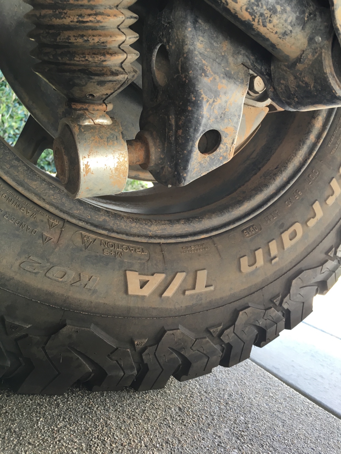

Nothing crazy but wanted to make sure the new tires don't rub when the suspension droops or compresses.
The do rub slightly on the upper control arm when hard over.

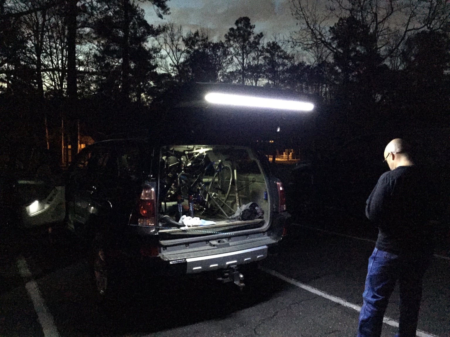

I don't. There's a good 8' at least. I have one under the hitch as well. They do okay when backing the trailer etc. For area lighting I love my hatch light.
