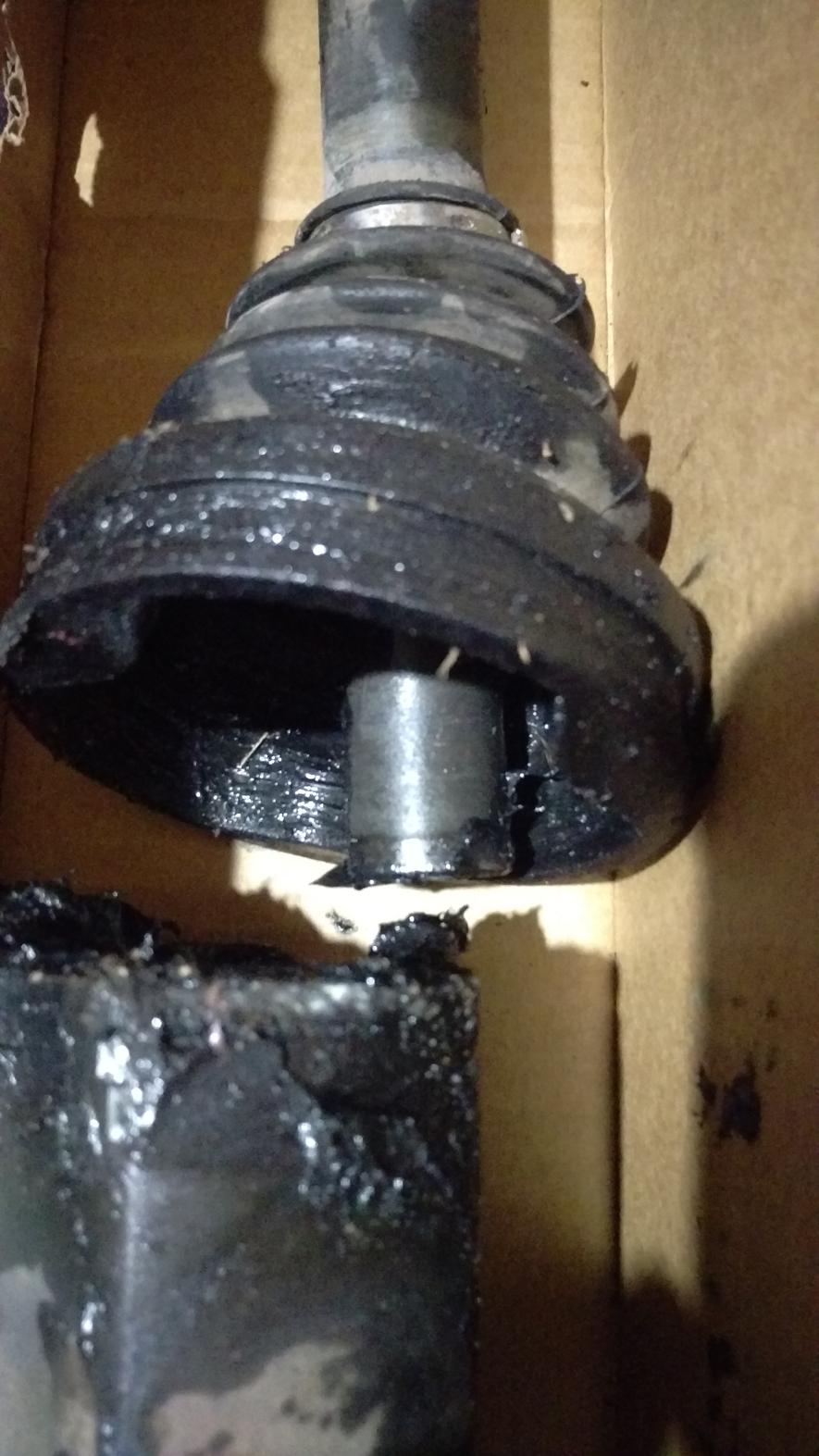

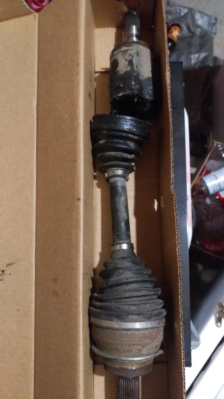

Replaced my broken cv axle! Sheared that sucker clean off! uploadfromtaptalk1444703835036.jpguploadfromtaptalk1444703856988.jpg

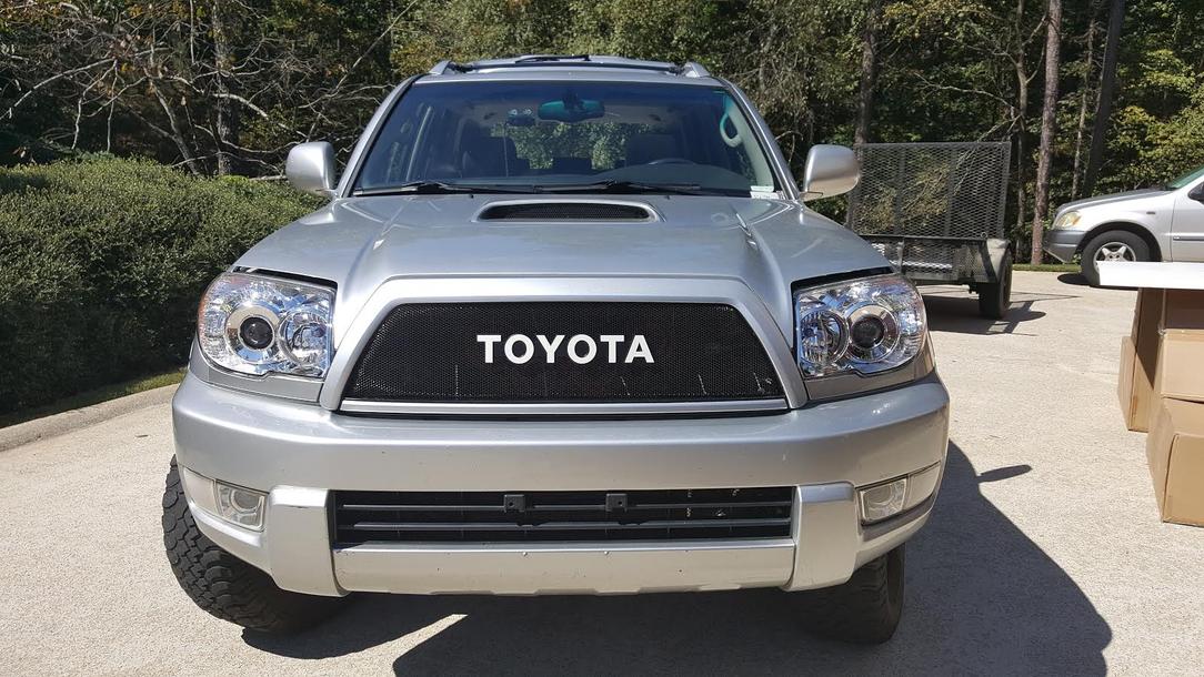

Finally finished this... the hood actually closes now.
2006 headlights and 2006 Satoshi on my 2005....
