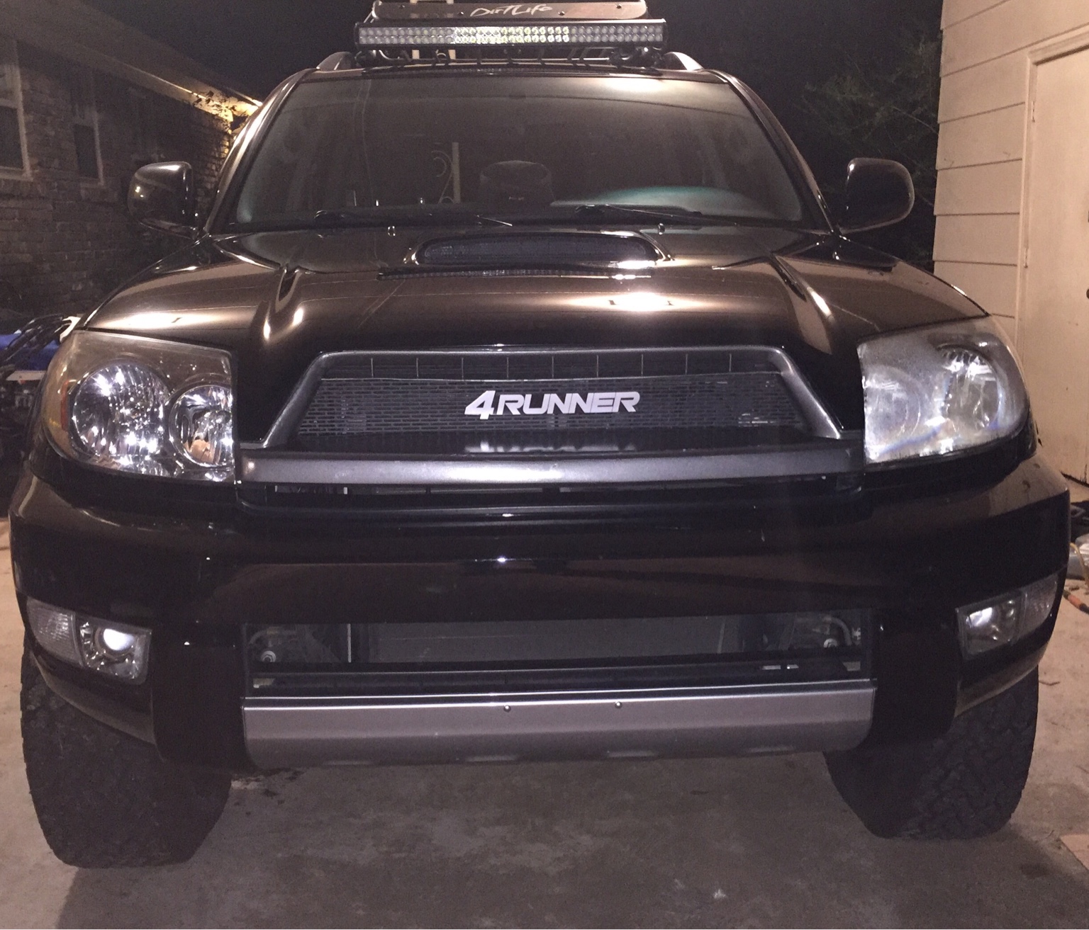

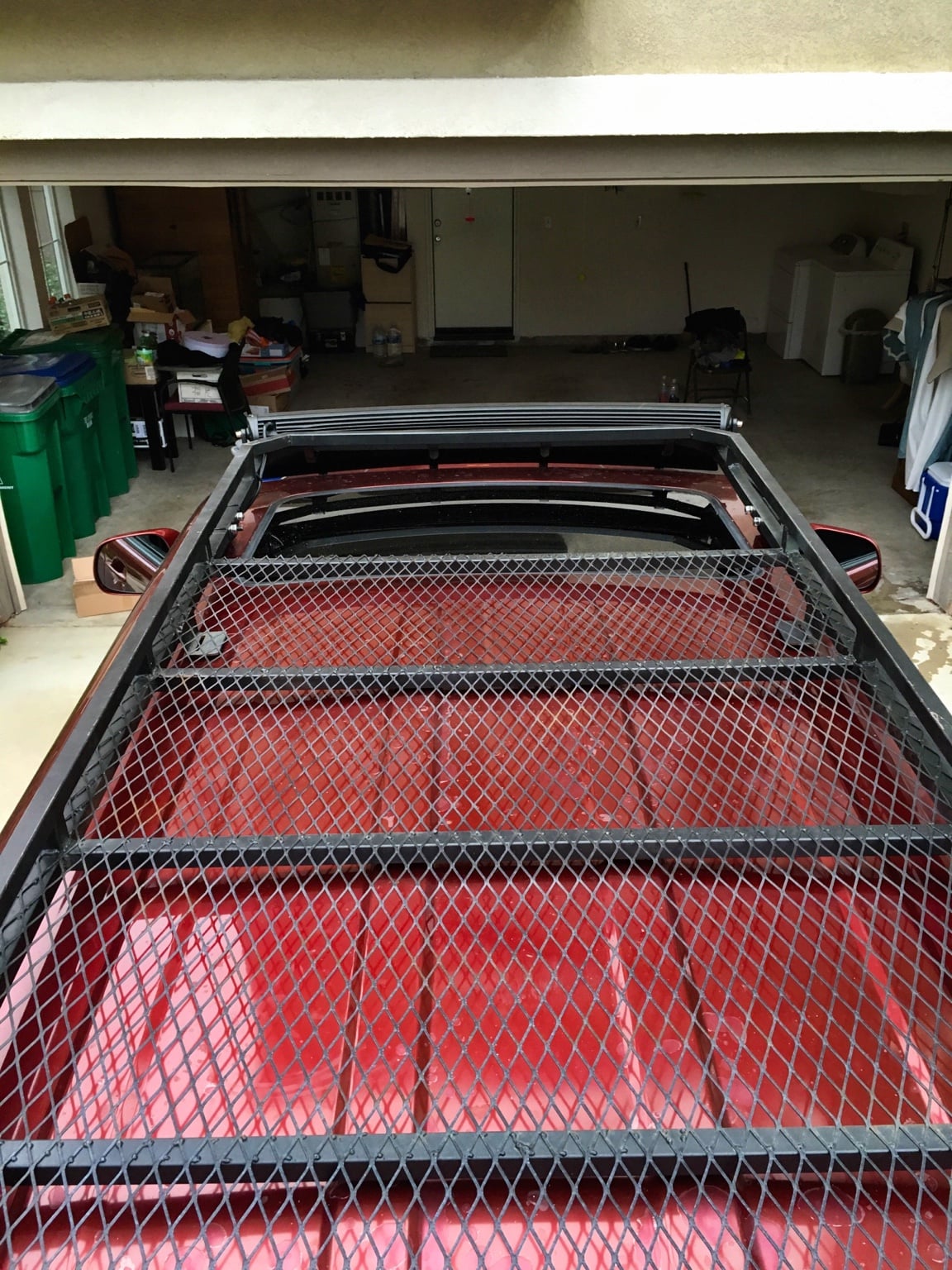

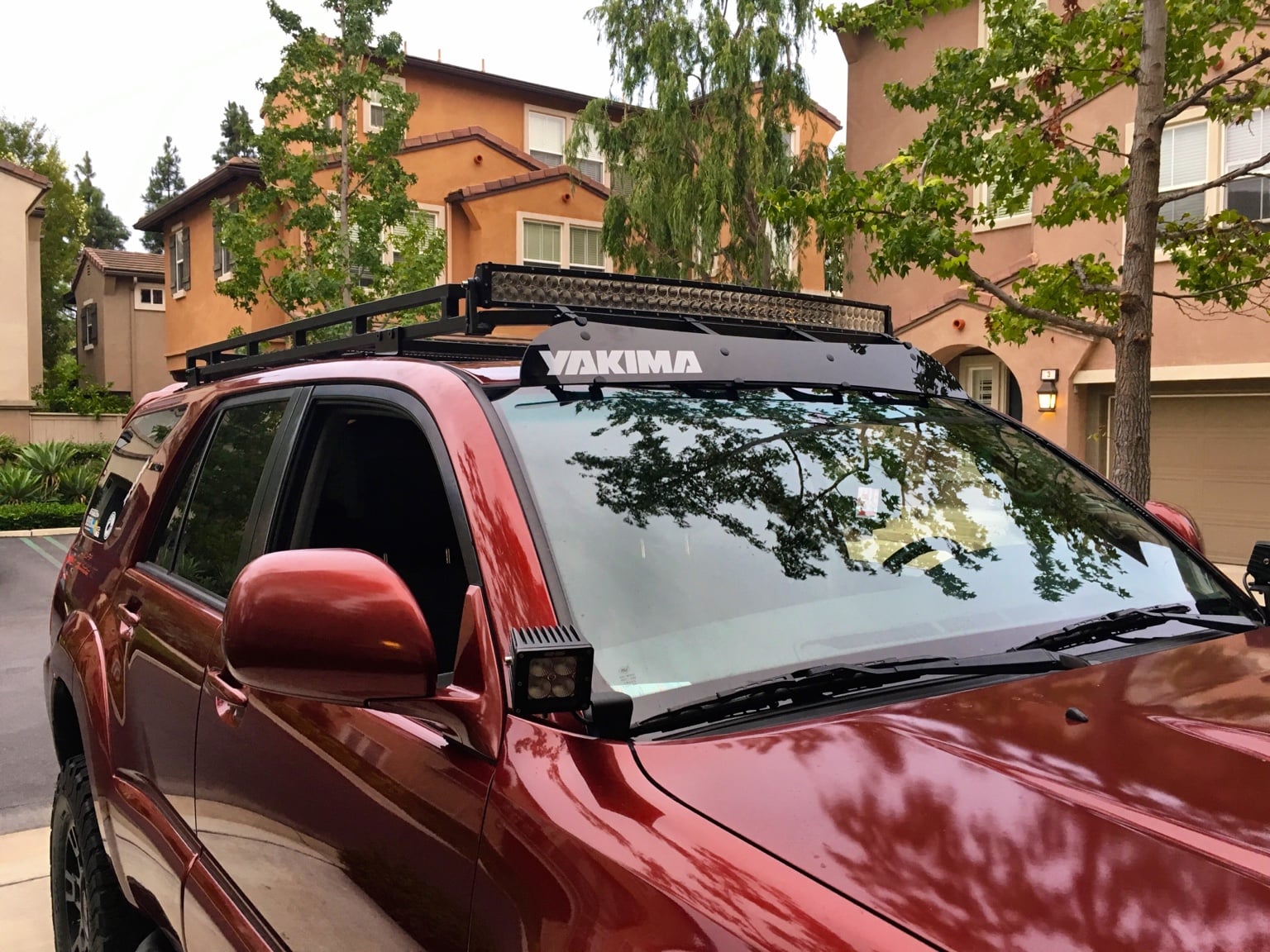

So I decided to call into work today and finish installing my roof rack and light bar. I have a ton of sick time and vacation so I figured why not. I had been working every night after work trying to make the brackets and I ended up buying an angle grinder to speed up the job. It still took me all day today but it turned out great. All in: tools, roof rack, material, and light bar I probably spent $500.

Looks good! How's the wind noise?
Looks awesome man! What are the smaller lights in front ??

So I drove it with just the rack and wind deflector and there little to no wind noise. When I installed the light bar there was a little more but it's more of a rumble and when I close the sunroof shade it isn't that noticeable.

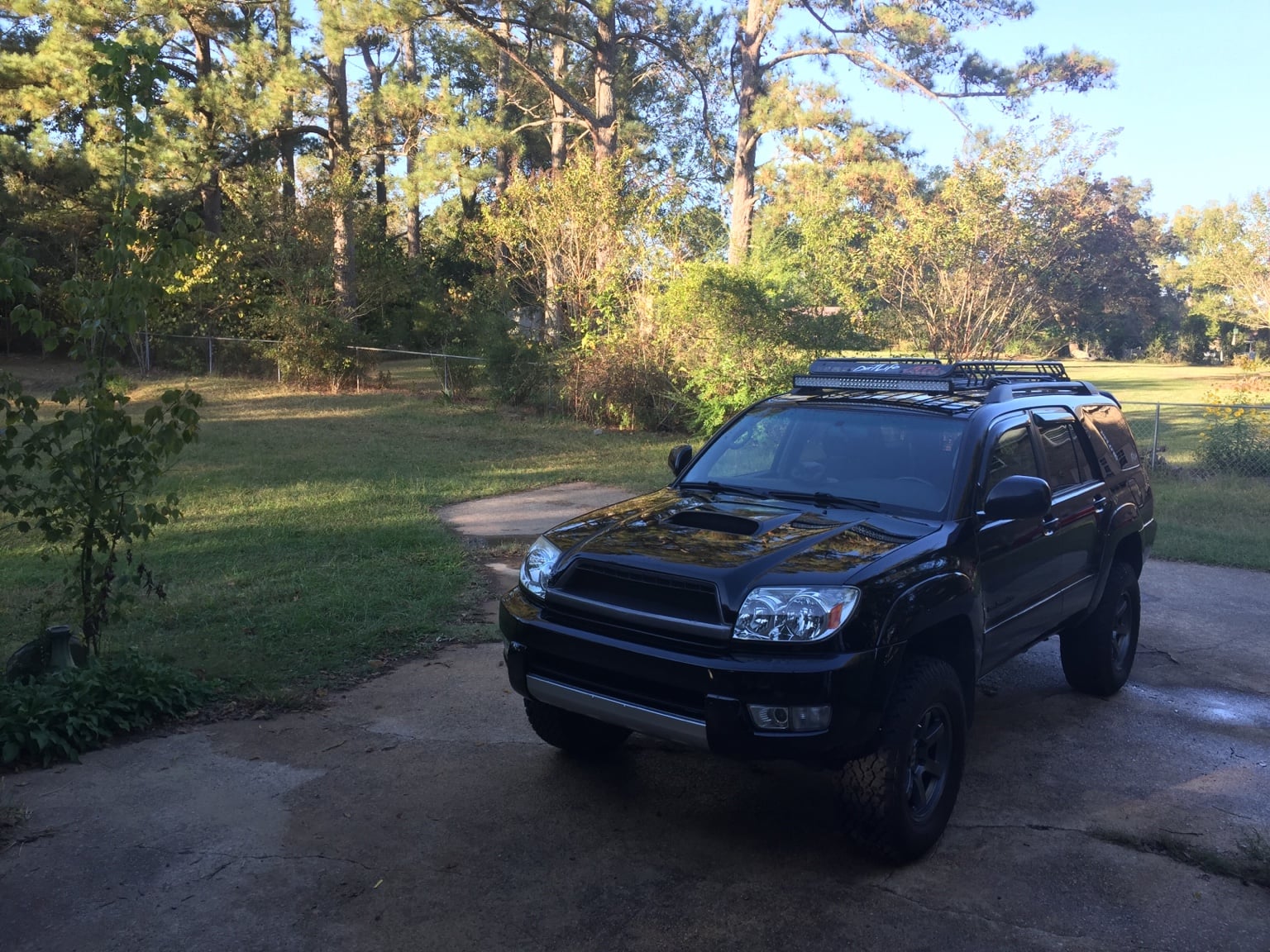

Did a small body lift and got the grille back in. Crappy paint job. Light bar, driving lights and let grille to follow....
Thats freaking awesome looking!

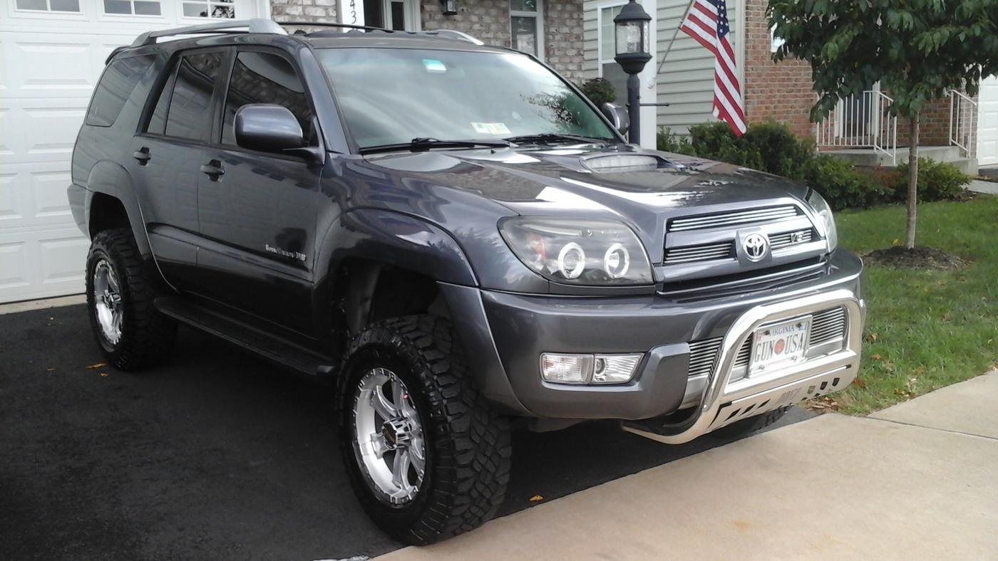

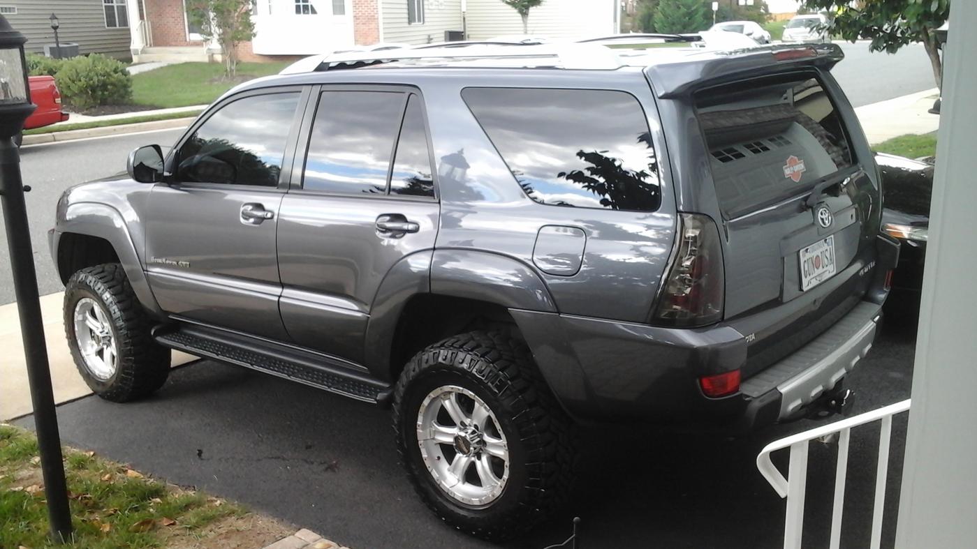

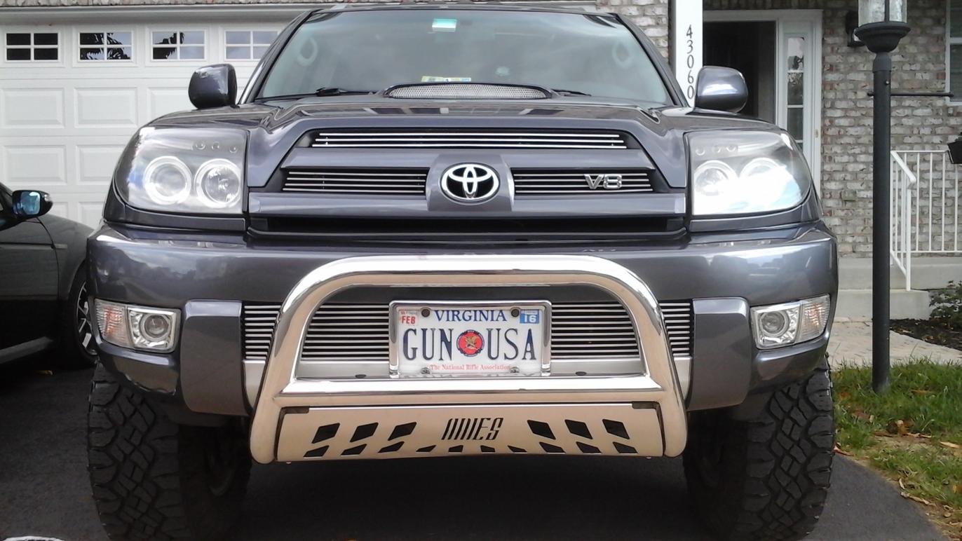

Oh! And I gave 'er a bath

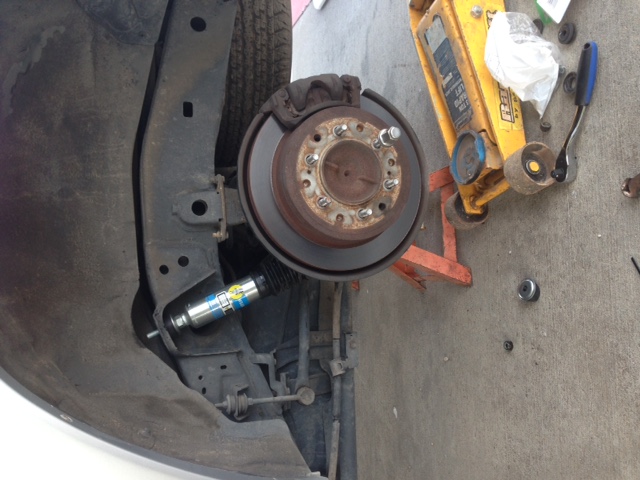

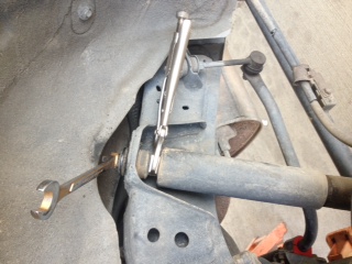

Suspension day
Finally got a floor jack, and jack stands to replace my leaking rear shocks;
-Bilstein 5100's all around now
-Moog front and rear sway bar bushings and connection linkages
Two jack stands and a floor jack for the rear shocks - 1hr
19mm spanner
17mm spanner
Vise grips and allen set for preventing the top part of the shock from spinning when removing the 17mm nut PITA!!!
Bushings and linages did not require the truck to be jacked up (highway road imperfection slop gone) - 1hr
Tools
-17mm spanner
-12 and 14?mm sockets
Also, dash was replaced by Toyota last week.
TRUCK DRIVES LIKE NEW:guitar2:

Could you share how you made the brackets? (including the materials that you used). Also, is there padding under the brackets?

Could you link me to the linkages you bought? I think I need that!
