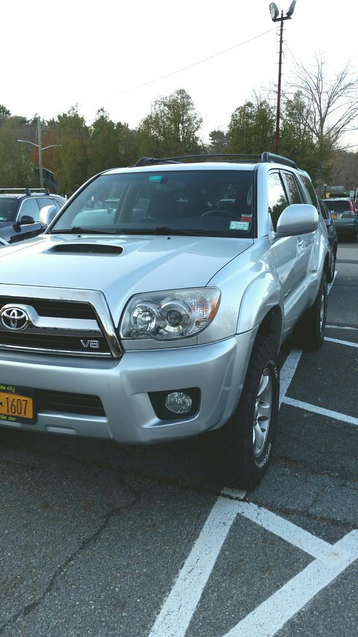

For those that don't peruse the SoCal section. Went and played with the SoCal T4R guys this weekend up in Green Valley Lake-> White Mountain.
Took XREAS out, put in Moog FJ coils and 5100s all around, and new sway bar bushings too.
Hope they settle down some, it is really taller than I had hope. I'm happy with how even it looks. Thanks to everyone on her who contributed. I could never have done it without you all, and the info on this site!

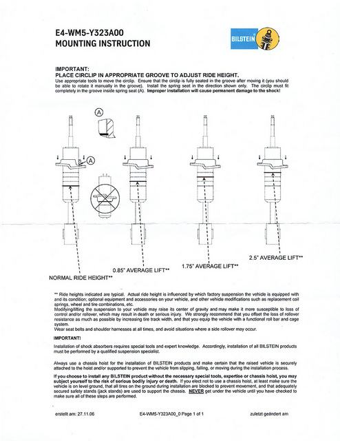

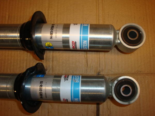

STOP!!! you are unhappy because your 5100 front spring perches are upside down. You need to remove your shocks and springs and flip the black 5100 adjuster things. You should not be able to see all 4 notches in the shock, does that make sense?
Should be like so:
Should be like so:
i see people putting those things upside down too on the OME ones. I though i was doing it wrong lol
Should be like so:
I did catch that!!!!
Thanks!!!!
That would have been disaster!!!!

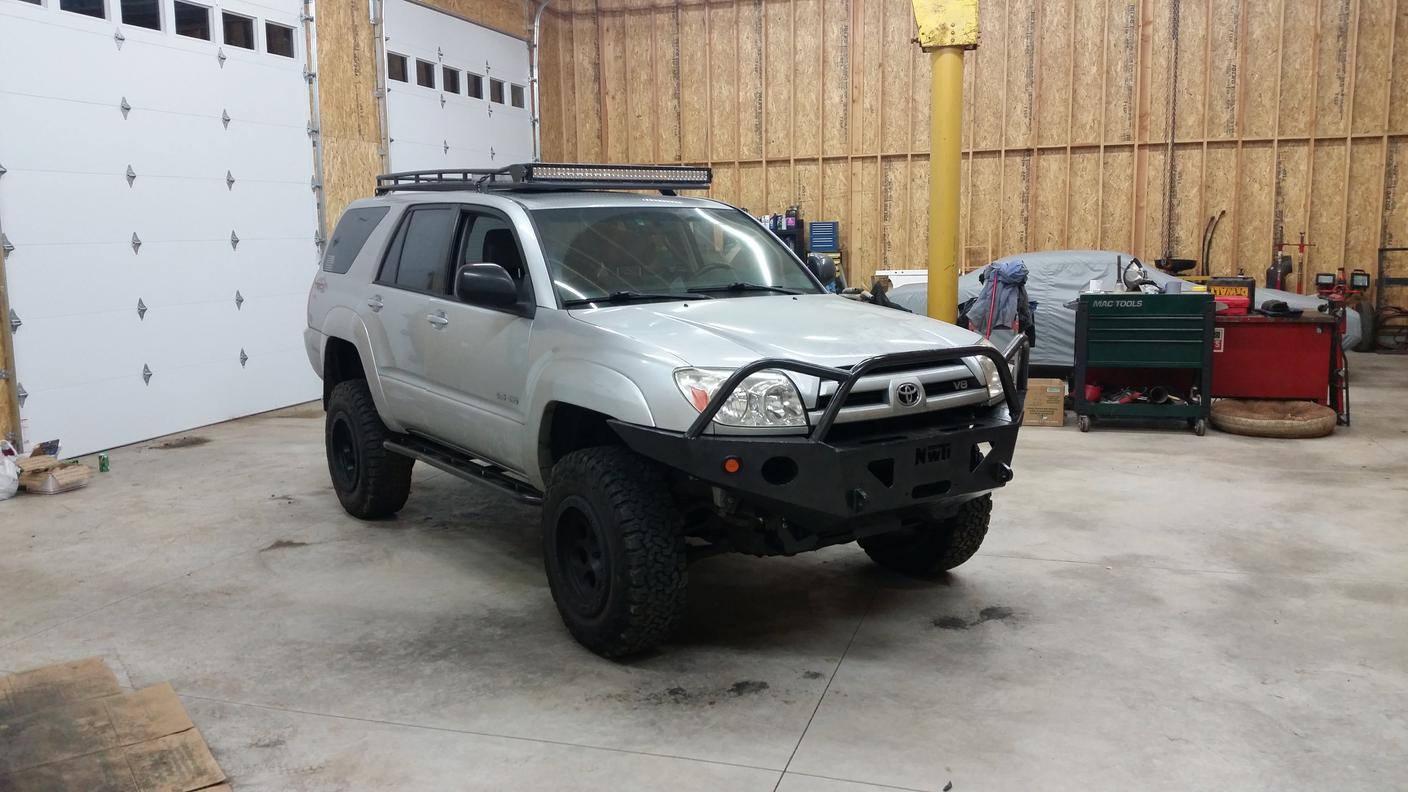

Not technically "today" but this weekend added my 1" body lift, Stubbs sliders, welded up a local plate bumper kit, installed my 40" light bar, cobra 75 CB, Scion head unit, TPMS disable mod. all in all, just under hours each for two people in three days. Need to take a little bit more time smoothing up the bumper and getting a better paint job on it.

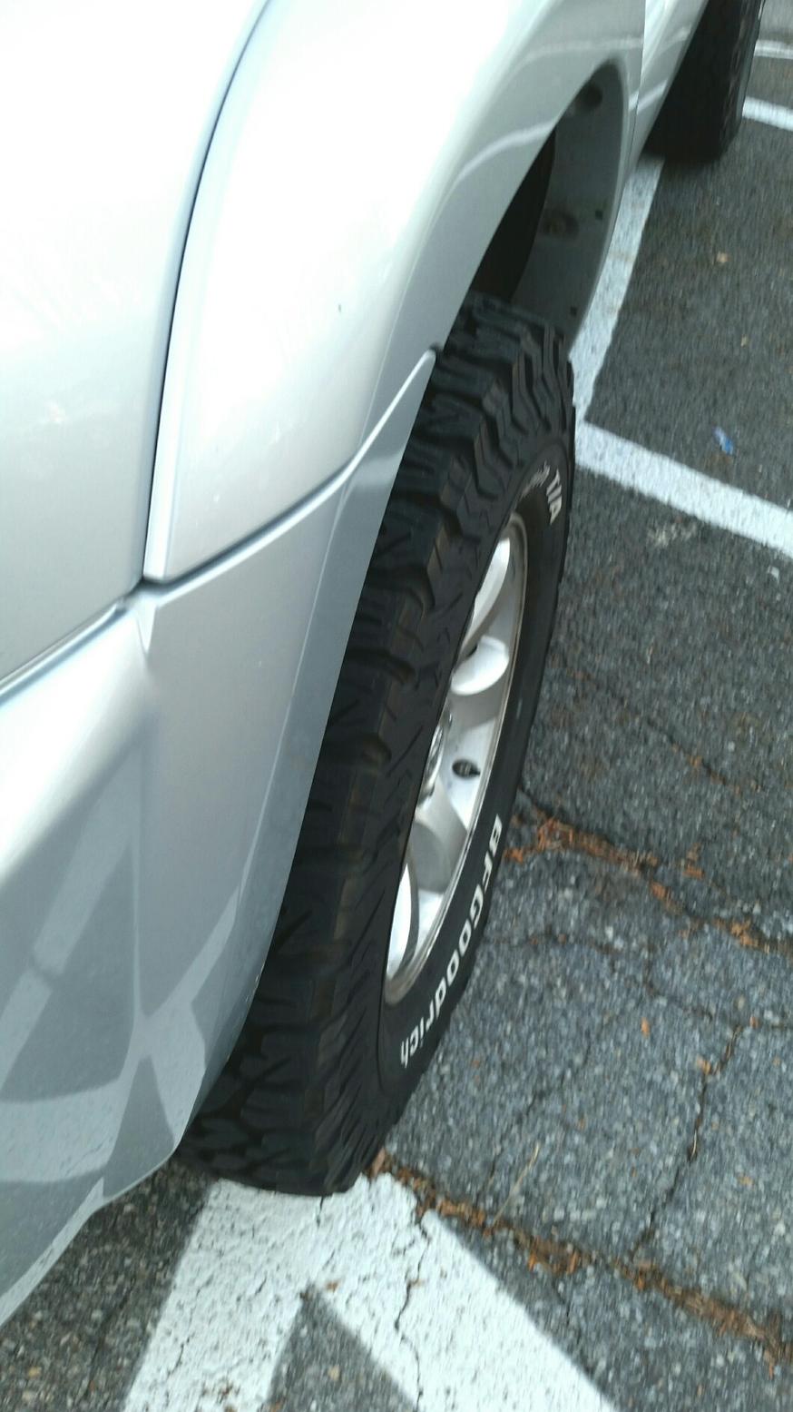

Spidertrax 1.25in Wheel Spacers

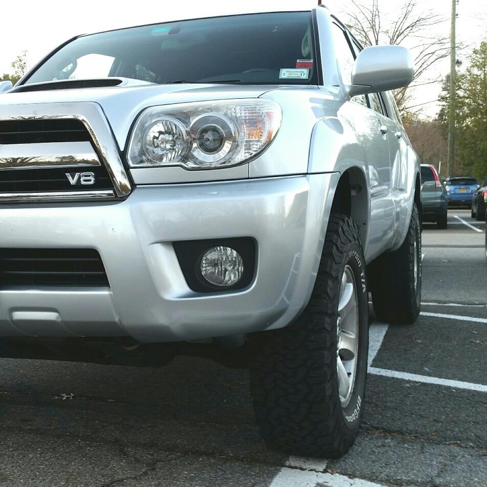

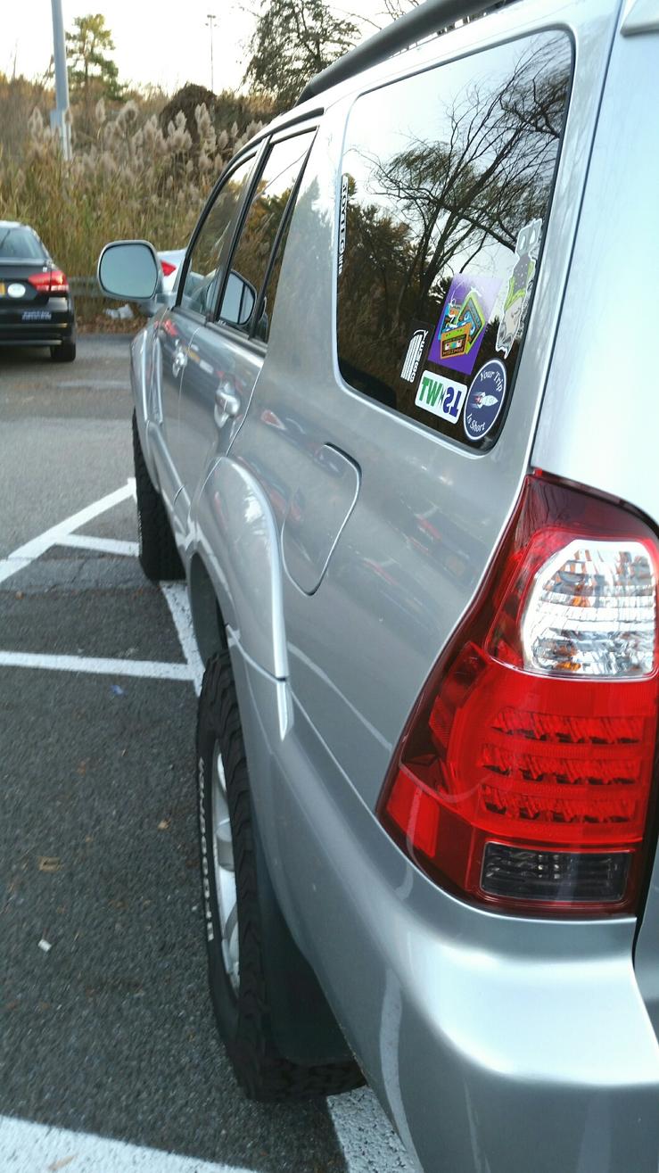

Finally installed Spidertax 1.25in wheel spacers at all four corners. The 275/70r17 BFG All Terrain KO2 tires rubbed a little bit on the front inner fender liner prior to install. The spacers have increased rubbing significantly. Seems like it can be fixed by pushing the fender liner forward. I believe drilling new holes and using the existing screws to secure the liner is the way to go. If you have done this or something similar, I would appreciate photos and/or suggestions on how to proceed.
