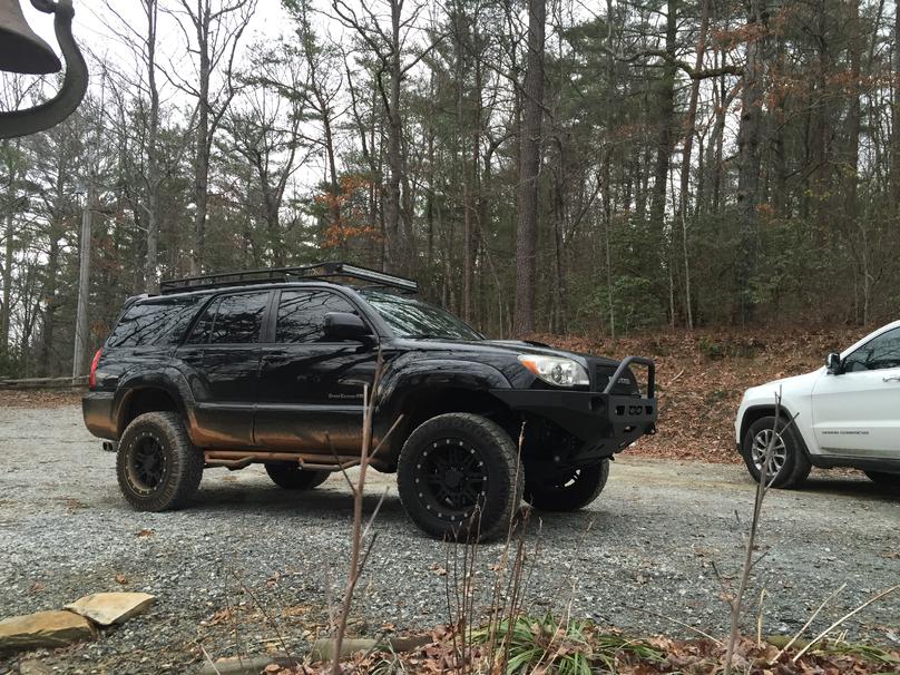

Rock Sliders
Had a local guy weld up some sliders for me. I wanted to keep them low profile but still protect the doors a little bit. I'm very happy with'em!

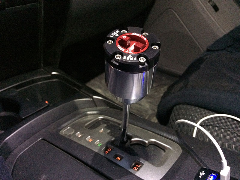

I don't normally mess with stuff like this but the leather one gets dirty off-roading, so I think it's worth it! Low range offroad makes this perfect aisin hub clone for the shifter. The only snag was their threads are M12-1.25, and the 4Runner is M8-1.25. A simple threadsert fixed that!
