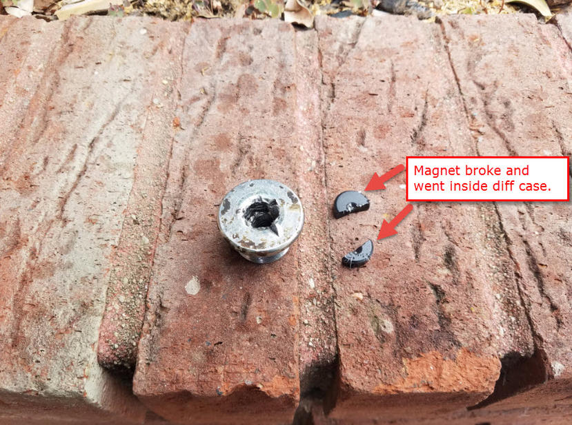

Had to drill out my front diff plug. Stupid thing was stripped. I must have torqued it too much last time I tightened it.
Got it out with a lot of cussing and drilling. Then more cussing and used an extractor.
Then lost the magnets in the diff case. SO... flushed it twice and used another magnet to fish the magnet pieces out. ugh... what a pain...
but it is done.
I just had the same issue. However I welded a nut on the end so I could get some extra grip with a ratchet.
Glad you got it out!

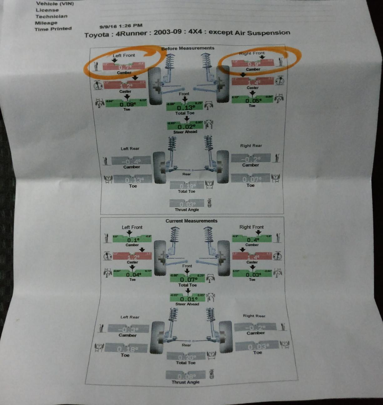

Got an alignment and balance since the camber was visibly off and car shakes at highway speeds, and was wearing the outside edge of the front tires significantly because of it. Not too happy with these final results though. The car has a 2.5" spacer lift and stock UCA's.. should the camber be able to reach 0.0? I want these tires to last as long as possible. Caster seems not perfect either but it drives ok, but doesn't stay in its lane as well as my other cars.
All opinions appreciated!
(Work was done at Toyota dealer)
Dealer did this? They were able to get your caster in spec when they should have prioritized camber. With stock UCA's and lift you can haz one or the other, not both.
Look again.
The caster never changed in the before and after. It's red and same numbers above and below.
The camber did. It was red before and green after.
Look again.
Right. Meaning they never set camber only toe. But, what I'm saying is if they bring the camber in spec, pretty sure the caster will be out.
Edit:
Nevermind, I looked at it wrong. Good catch.
They did prioritize camber, with caster being secondary at least this is what he told me). I watched over it the whole time and he said he maxed out the camber, then adjusted the toe. He said camber was good enough. What is the ideal range for caster? Goal for camber is just 0.0, correct?
I had my alignment done yesterday as well. My caster is the same on both sides. Around 2 I think. Forgot the sheet at home today. My camber is +.4 on both sides. Drives great. Was a little nervous with the red screaming at me on the sheet when they finished the alignment but from the research I have done I shouldn't see any issues for tire wear at .4
Everything else was in green. The front spacer lift was still in spec except for the caster.
Please correct me if I am wrong on any of this. I will upload my alignment sheet when I get home. Getting new tires installed in a couple hours so if I need to revisit alignment shop I will.
