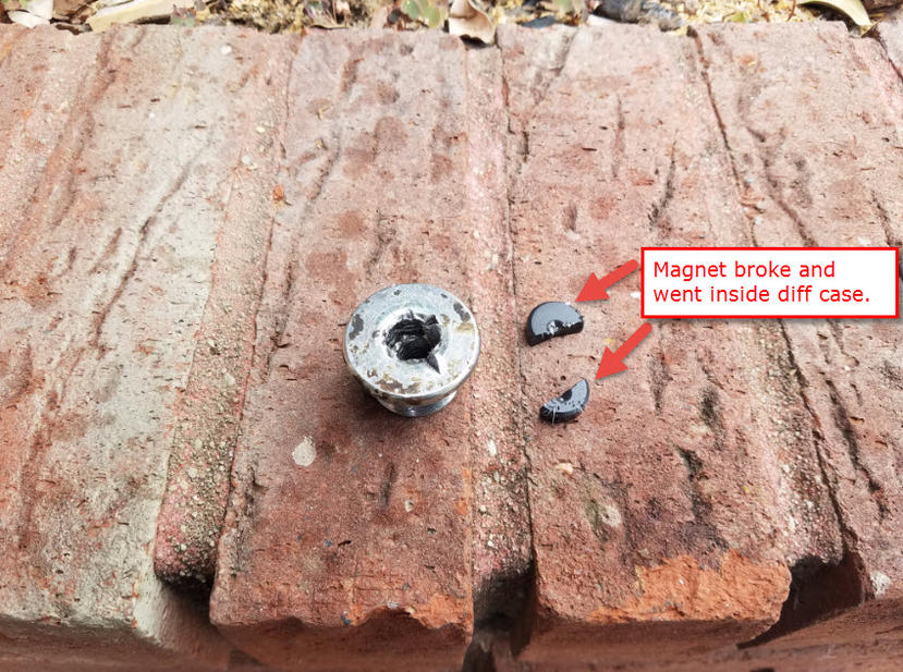

Had to drill out my front diff plug. Stupid thing was stripped. I must have torqued it too much last time I tightened it.
Got it out with a lot of cussing and drilling. Then more cussing and used an extractor.
Then lost the magnets in the diff case. SO... flushed it twice and used another magnet to fish the magnet pieces out. ugh... what a pain...
but it is done.

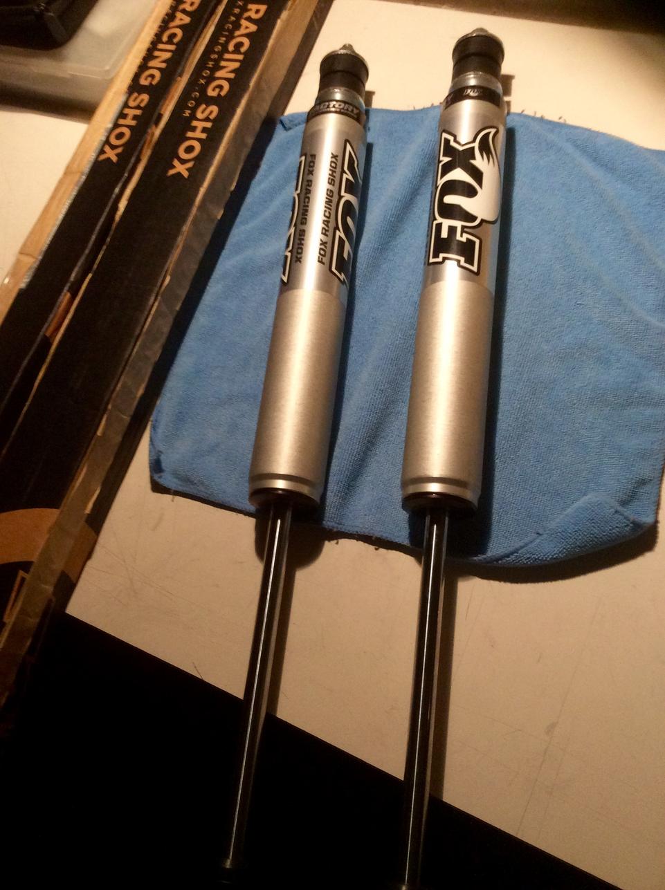

After breaking one of my fox shocks last week ...I Got some new replacements delivered today I went with fox factory series 3"-5" inch lifts 26.15 ext and 16.06 coll with 10" inches of travel.

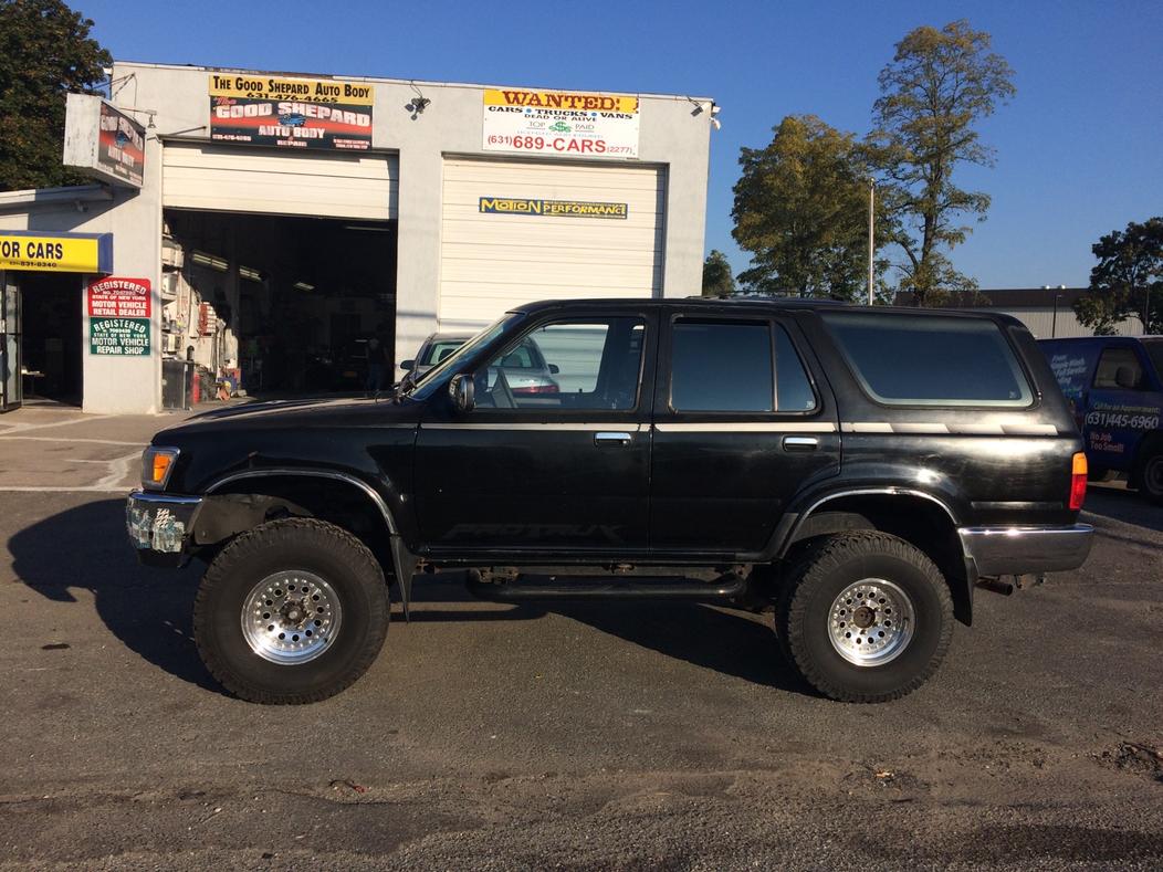

Dropped mine off at the body shop today. Minor touch-up on the tiny bit of rust in the dings and getting some satin black paint laid down. Also getting that bumper bolted back on finally. Now I wait for the finished product.
