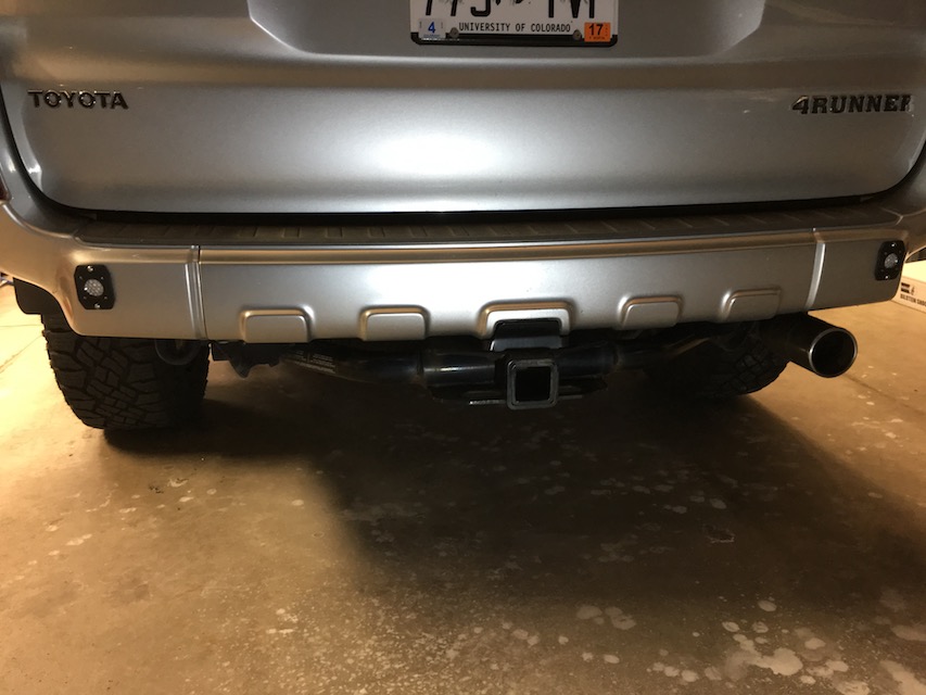

Installed some Rigid Ignite backup lights.
Output shots at night?

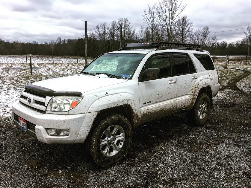

Had to give Walter White a little workout on the trapline today. Everything is good so far and the melting muck barely slowed him down.

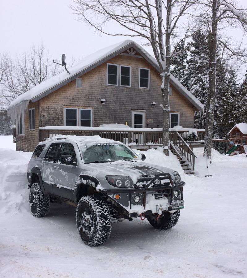

Another snow day. Played with the kids in the snow. 12" of fresh snow last night. Our snowfall total for the last 7 days is now 54"!!
