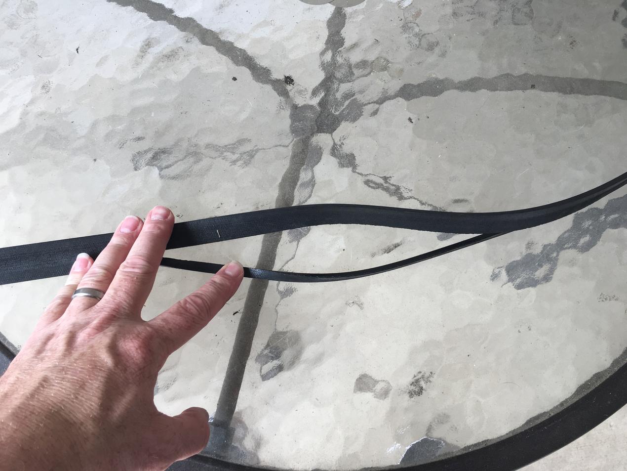

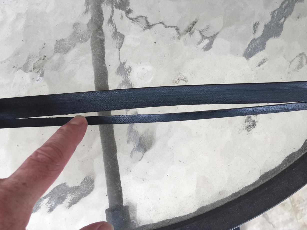

I have had a "squeaking" for a while and decided to replace the pulley on the tensioner. Some of the noise is gone, but I think there are more pulleys to replace. But it appears however, I got to the belt just in time.
How many miles do you think that belt was on for?
