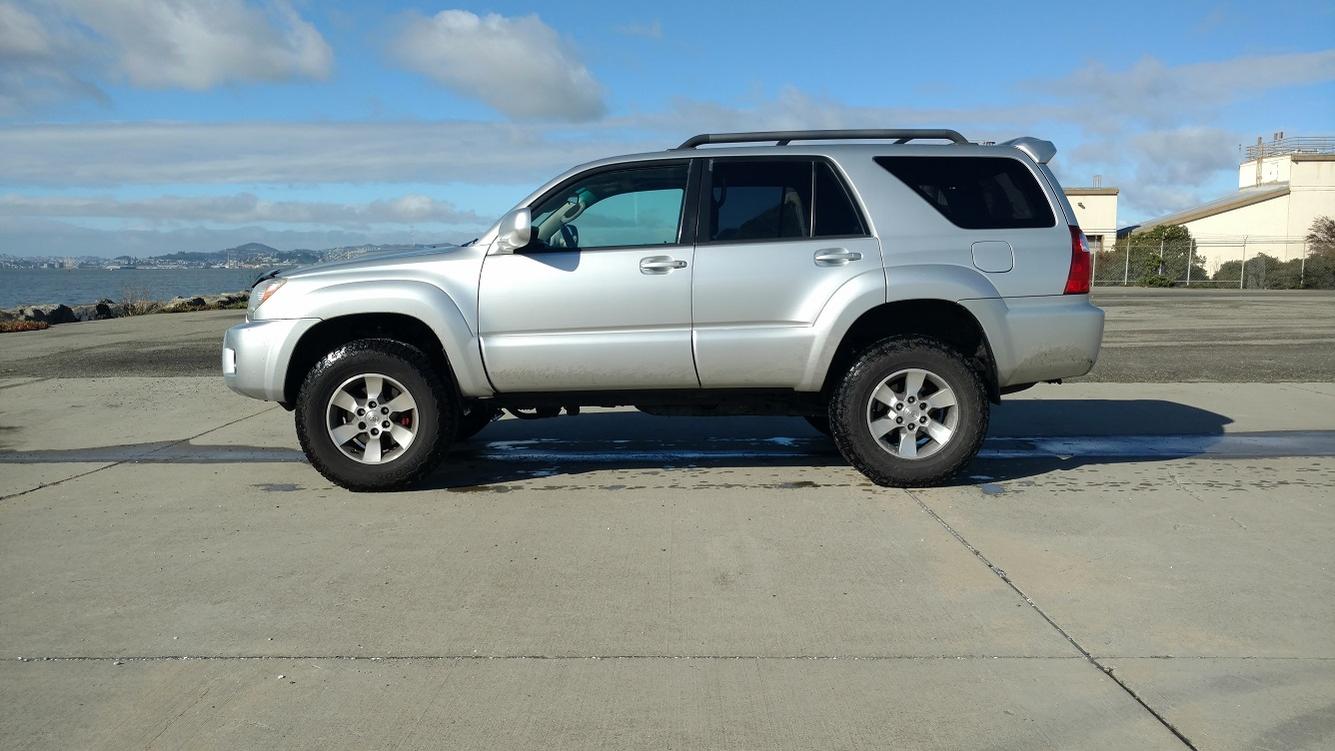

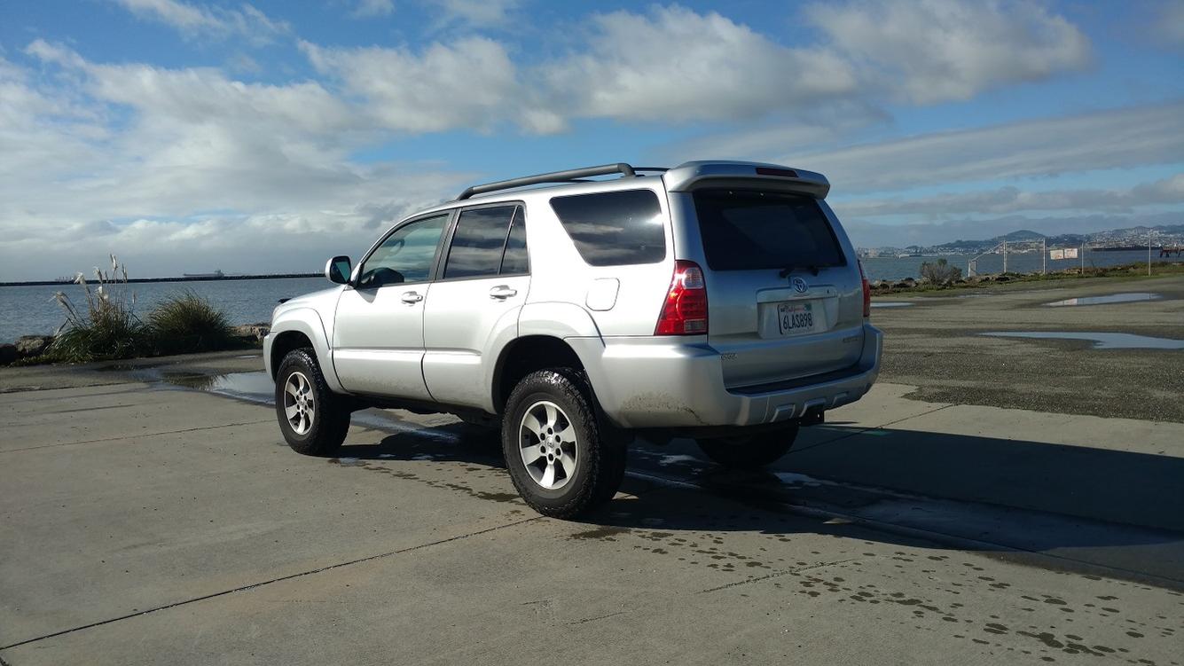

Installed some rear coils
dobinson 59-559s. for an FJ, 30mm lift/220# spring rate..dont mind the rake should settle a bit. big improvement..:flame:

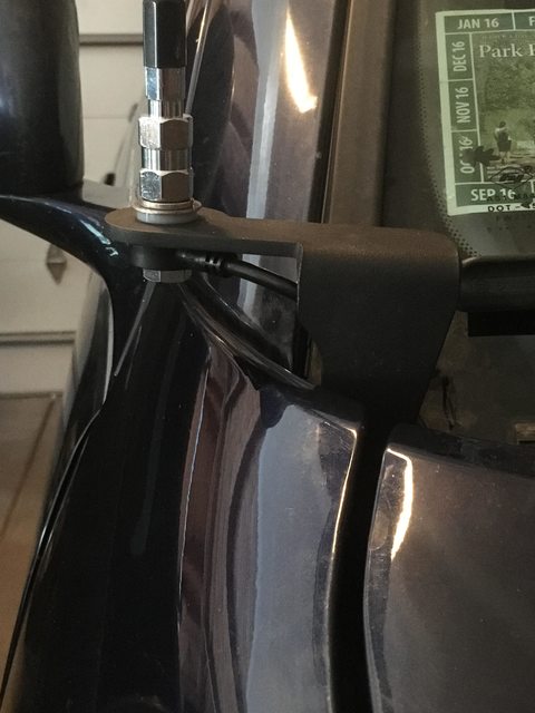

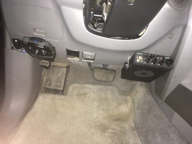

I wrapped up CB Install with Uniden 520 Pro XL, Firestik Firering Coax, 3' Firestick Firefly antenna, and a CBI Antenna bracket.
Initial SWR
Ch 1 = 2.2
Ch 20 = 1.3
Ch 40 = 2.3
Going to retune in a better location, but I'll take it for my first CB Install.

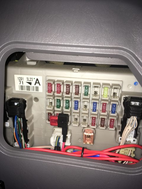

Tap a fuse - I had open fuses so I decided to tap an always on fuse.
The under dash business...
CBI Antenna Mount with Firering and antenna installed

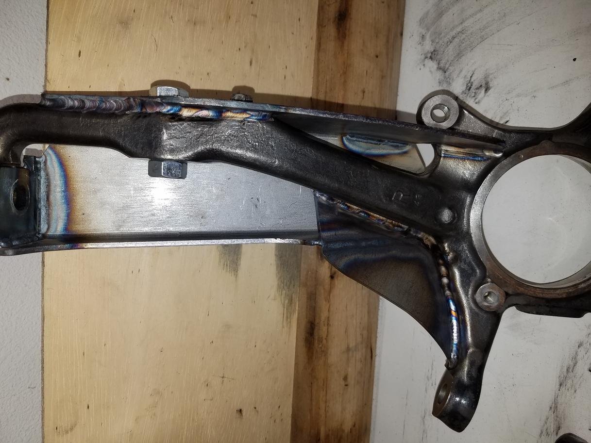

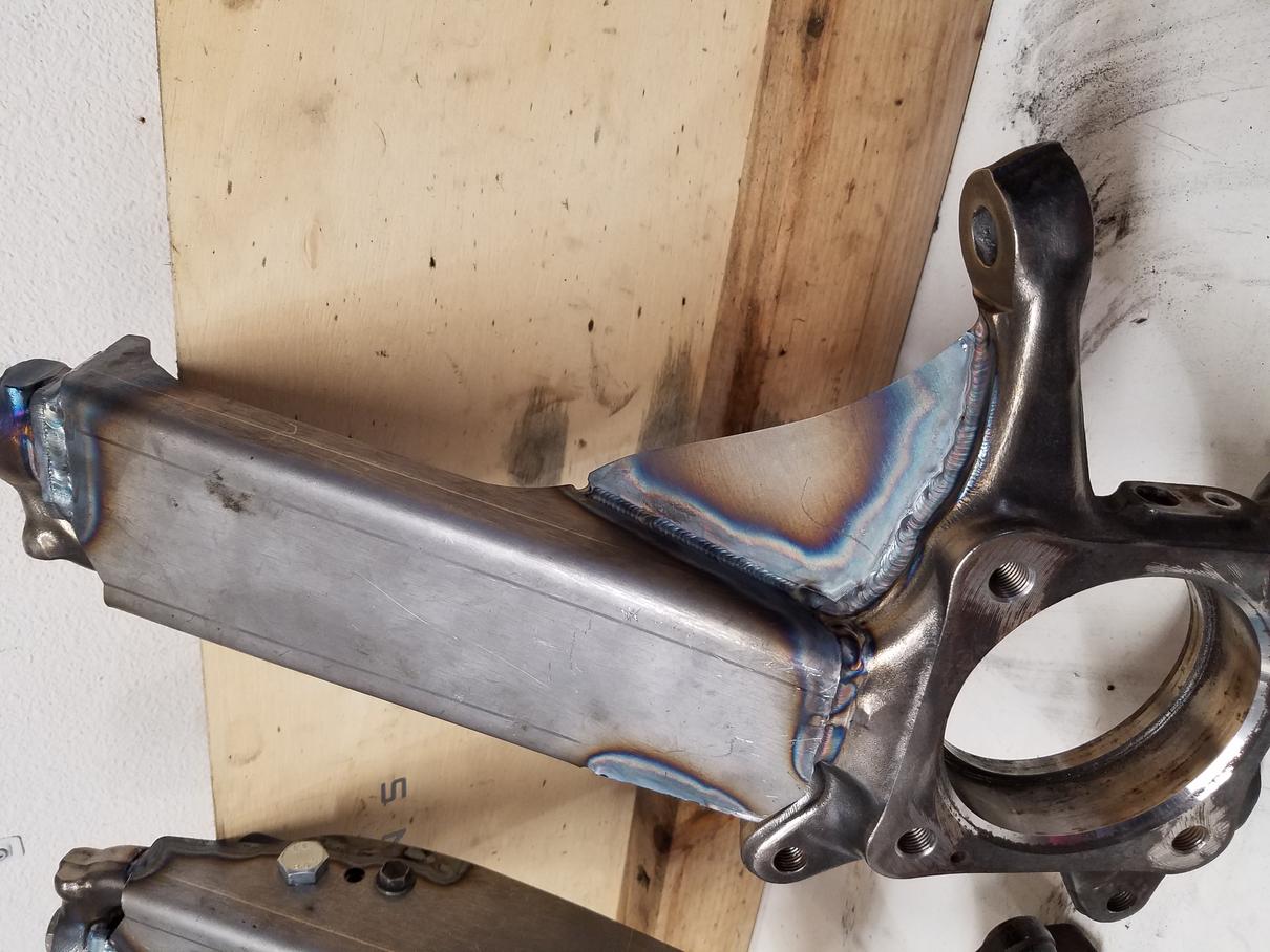

Got the spindle gussets all welded up! Paint and put them back on next week.

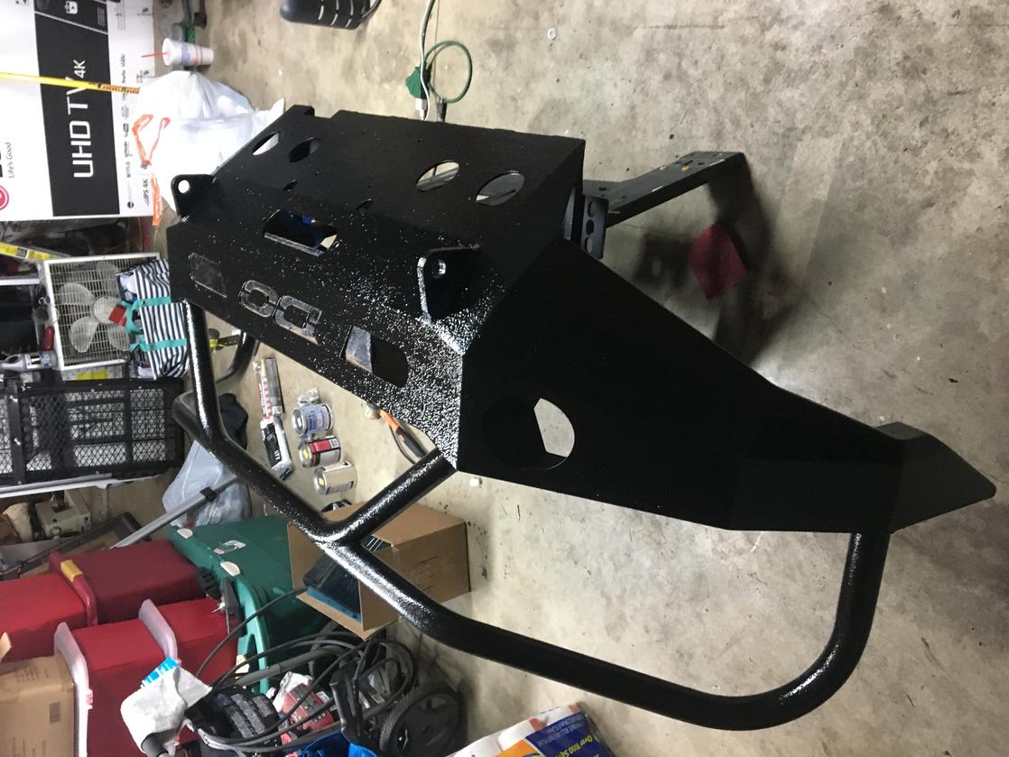

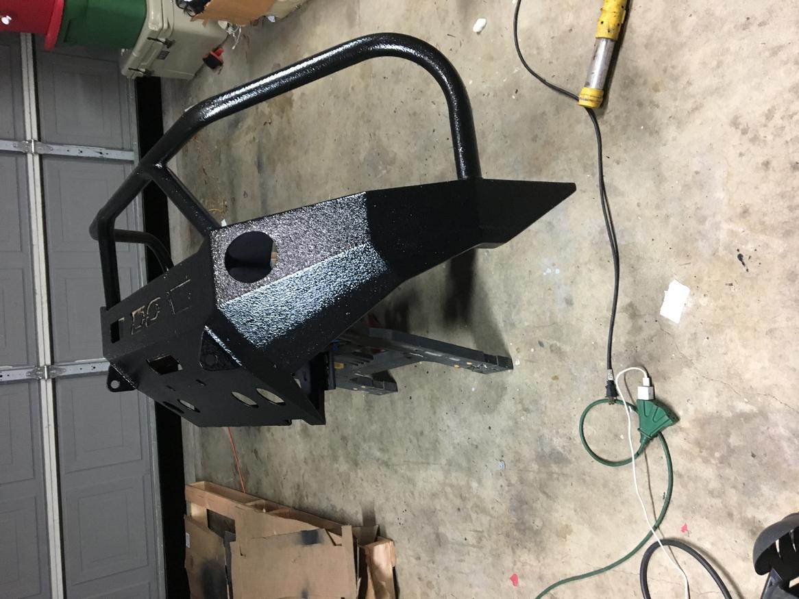

Painted my Demello 3-hoop today with some Monstaliner. Should be ready to go on tomorrow:)

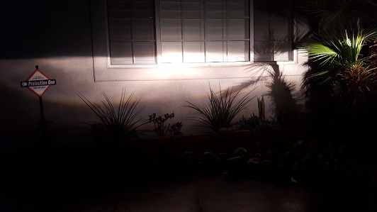

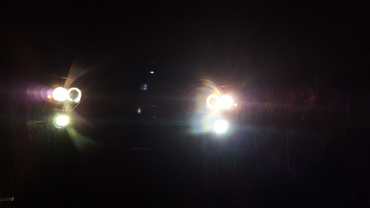

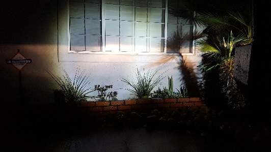

LEDs in the DO fog light holes
Thanks [MENTION=143757]MisterNickG[/MENTION]. Got the FCKLightBars P4 Pods installed.
With the LEDs.
Without the LEDs.
Front to the 4runner, at night, in the rain: :shocked:
