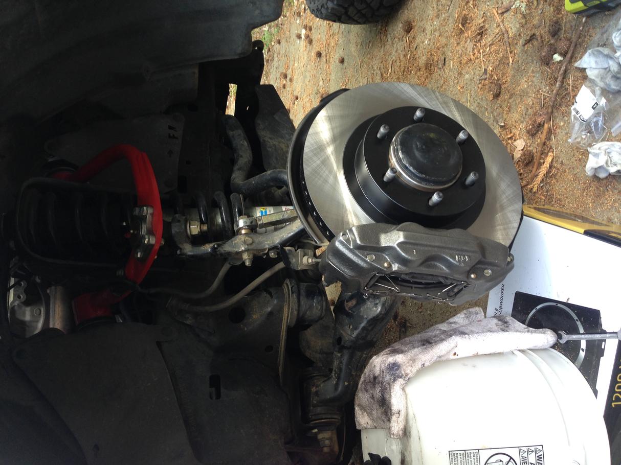

I'm in the rust belt so I had to go with ball joint UCAs. These just seemed a bit better than the Camburgs, which were the only other real choice. The joints themselves seemed a bit beefier, and since they are bolt on, and the arms are actually cheaper, I went with the JBAs. They have a great rep with the Tacoma and Jeep guys.
I've been running the same UCAs for a few months now. I was able to get my caster out to about 4.0 using these, so they definitely get the job done (and look good too).
The best part about them is their use of the GM half ton ball joint. Super easy to replace whenever that day comes.

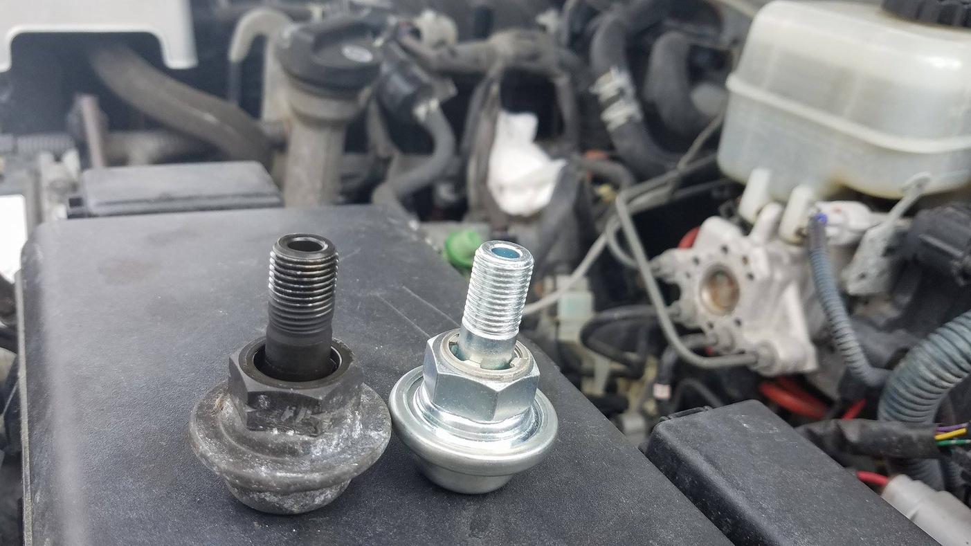

Replaced the Fuel pressure pulse regulator today. Apparently the little diaphragm in these wear out and cause hesitation and a annoying clicking noise mostly when cold.
- Also put on a new diff breather
only things left is to change the oil, grease the driveline and get a coat of wax on it before the FJnortheasters run in 2 weeks!
Did it eliminate the ticking? I'm hesitant to replace mine because some report the noise returning after a few days.
uhm, honestly I dont think my ticking was too bad to begin with but it definely made it a little quieter a little smoother and a bit more responsive I think..
if your going to do this, becareful not to lose the washer on top and bottom of the one you take out, very tiny pieces

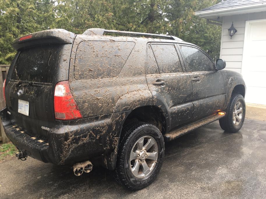

Took a mud bath in the rain. Did some field running. Headers sound great still in case you were wondering...

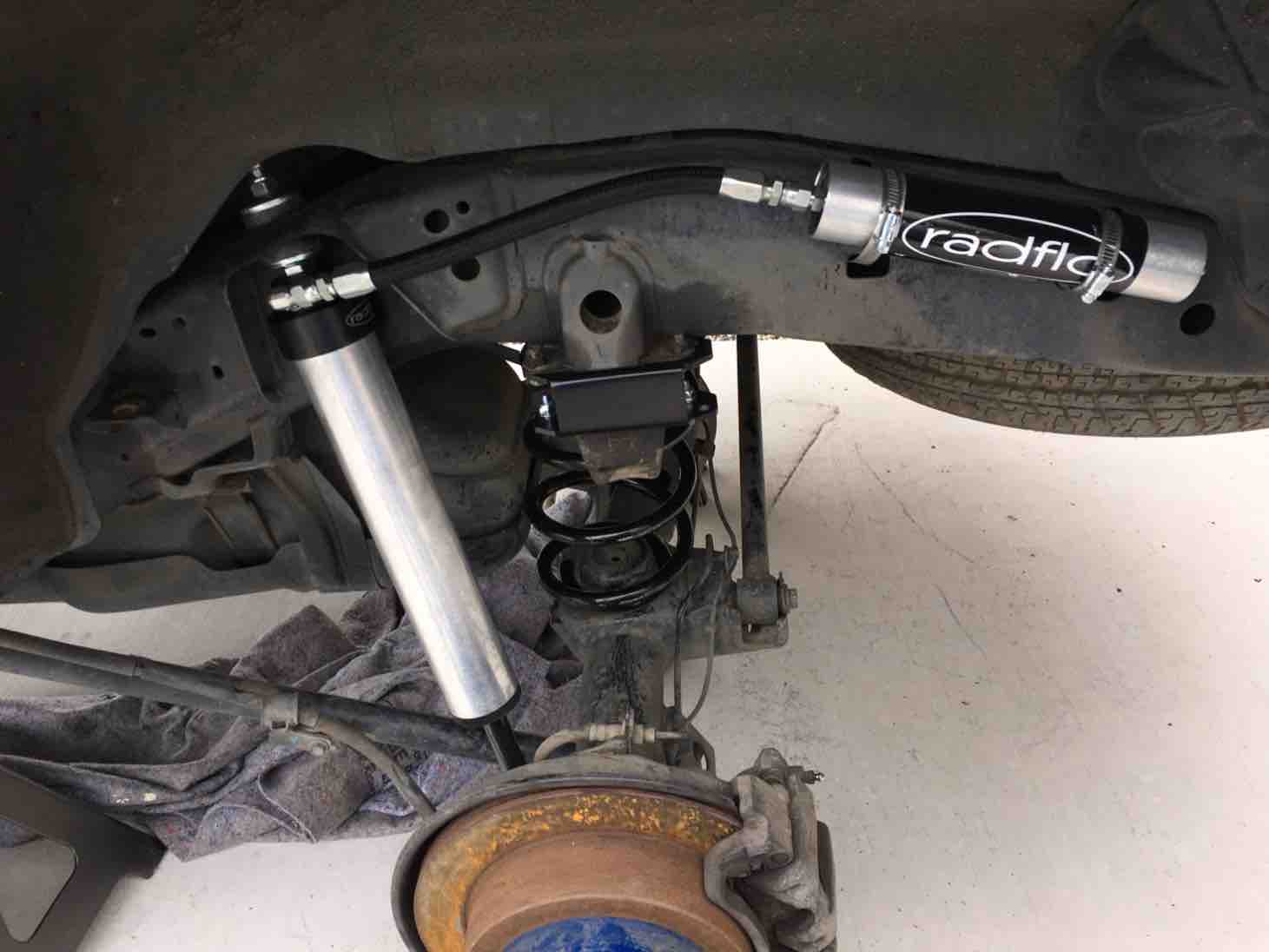

Got one side of the Metaltech kit installed but I'm getting some nasty rubbing on the gas tank with the coil. The axle is much much lower than where it will be with the tires on but I'm afraid I'll be rubbing here when I flex out. Anyone have this problem?
