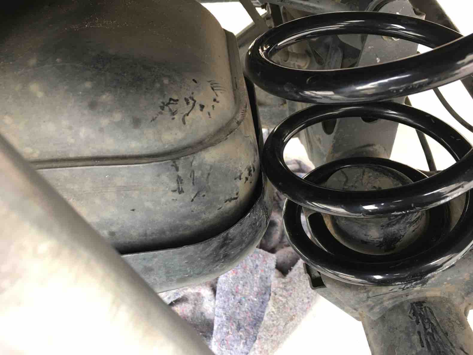

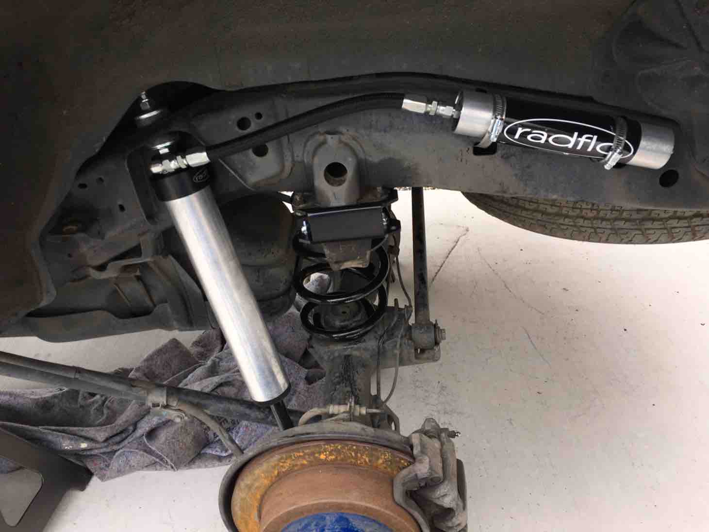

View attachment 248312View attachment 248313
Got one side of the Metaltech kit installed but I'm getting some nasty rubbing on the gas tank with the coil. The axle is much much lower than where it will be with the tires on but I'm afraid I'll be rubbing here when I flex out. Anyone have this problem?
I bought the metal tech long travel springs and shocks and they do same thing. They also make a ton of noise going over bumps in parking lots. Pulled them out to see what it was and I can see where the coils at the top are hitting the bucket in the frame. Thinking of getting Icons overland springs

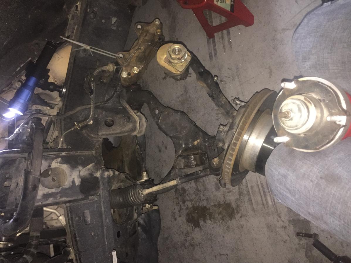

@Ralphman this way OME Install - no spring compressor - Toyota 120 Platforms Forum is much faster and easier. Your doing a lot more work than needed to get the strut out.

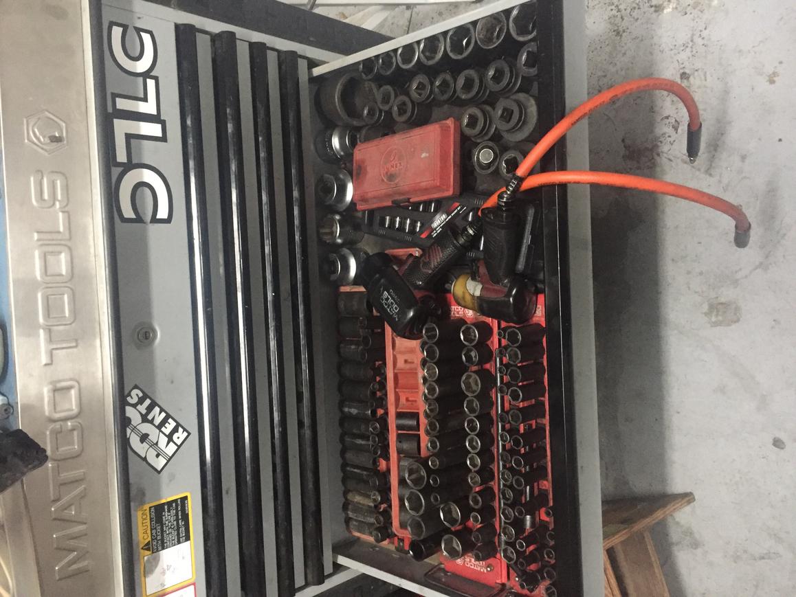

Naw this takes me maybe 10 minutes or less to get to this point once i got it jacked up. If i had a nice jack i could get it done real quick. My method is pretty simple with how the spc uca is. After the tire is off disconnect abs wires and get out the way same with the caliper, then loosen the ball joint nut move uca out of the way, next take out the lower shock bolt, swing lower control arm out of the(benifit of the polly bushings) next undo the 3 nuts up top and bam its out of your way. Im sure the lack of no front axles a hell of alot easier. And also i dont have a sway bar in the way also. But what ive learned over the years is you ask ten mechanics how to do something and you will get told ten different way. Also having all the right tools on hand helps. ive put tool truck salesmens kids through college over the past 5 years
