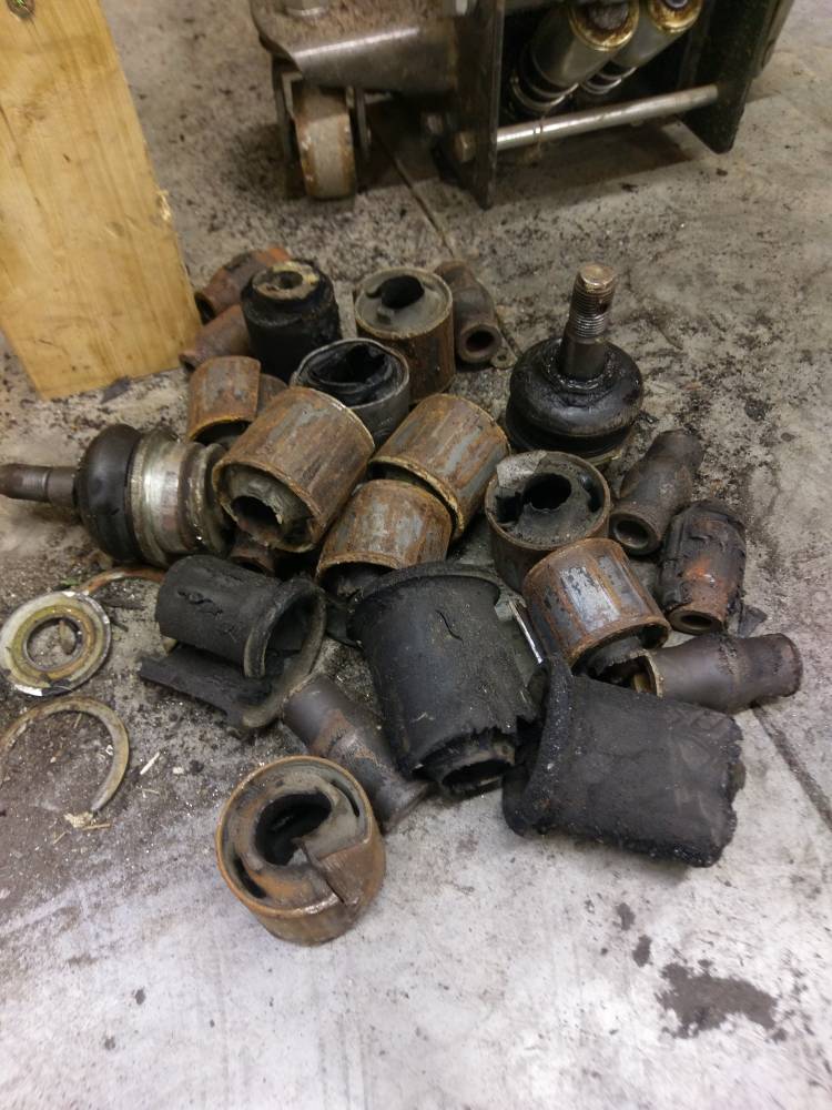

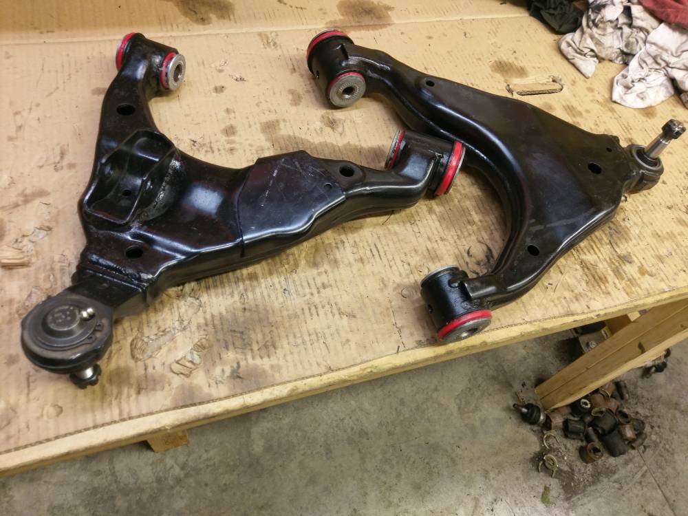

Finished up my spare LCA rebuild with poly bushings and new style moog greaseable ball joints. Now to weld up the alignment cam tabs and install the new arms.
Garbage from front and rear arms. So far not impressed with the rear poly bushings, only in for a couple weeks and extremely squeaky.
Honestly I put poly bushings on the F/R swaybar and HATED them. Not only did they make god awful noises on the 2nd day they completely fell apart after street driving.
I would not recommend them for anything other than the UCAs. OEM bushings/rubber are just in a different league from a quality standpoint.
What's the point of running them in the LCAs anyway?
Poly has less give and is supposed to be stiffer, more responsive.
Stock rubber bushings have more radial deflection (slop) and are captured so that they can only rotate so far. Lift something and give it more travel therefore larger angle of rotation in the bushing and you'll wear out the stock rubber bushings designed for a smaller angular range of motion much faster. Then throw in the fact that I'm currently running cheap aftermarket LCA's and multiply the wear effect, translate it into undesired steering feedback and slop. So while they don't add any additional travel (dictated by shock length) they certainly do make getting to either end of travel much easier and the ride more stable from just doing the rear arms so far. NVH is very much so a personal preference so to each their own there, but if you have them in one squeaky joint, might as well run it everywhere.
I've been running poly sway bushings for 2+ years now with no noise or degrading issues so we've had different experience there too. Maybe cheap bushings, wrong size, or wrong grease deteriorated them. I will agree that OEM ball joints and bushings are pretty impressive in terms of robustness but at 125k miles and lift and offroading they are well past their prime.
Was this job as bad as everyone says it is? I should do mine soon...
Best advice would be to get a MAPP torch instead of propane, and having a shop press, even the 12 ton harbor freight one will make the job that much easier and faster. And rent the master ball joint press tool to use the different sized cups and adapters for the ball joints. The real pain is if you need to cut the old bushings to get seized adjusters off the t4r. Yes it took me about 3 weeks to rebuild these arms but I only worked on them a couple nights a week so it could be a weekender job if you're ambitious and have everything together that you need.
I actually used the ball joint press to press out the rubber with a oxy acetylene torch and my impact, also used the press to put it all back together
