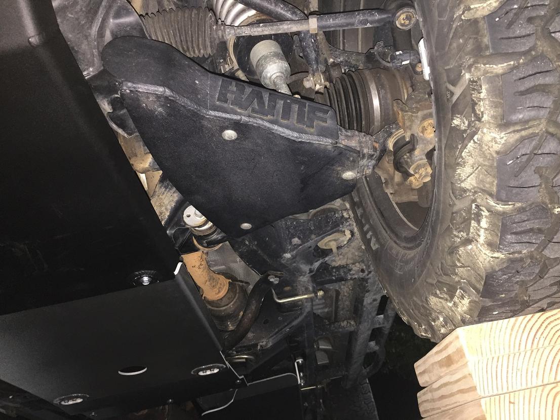

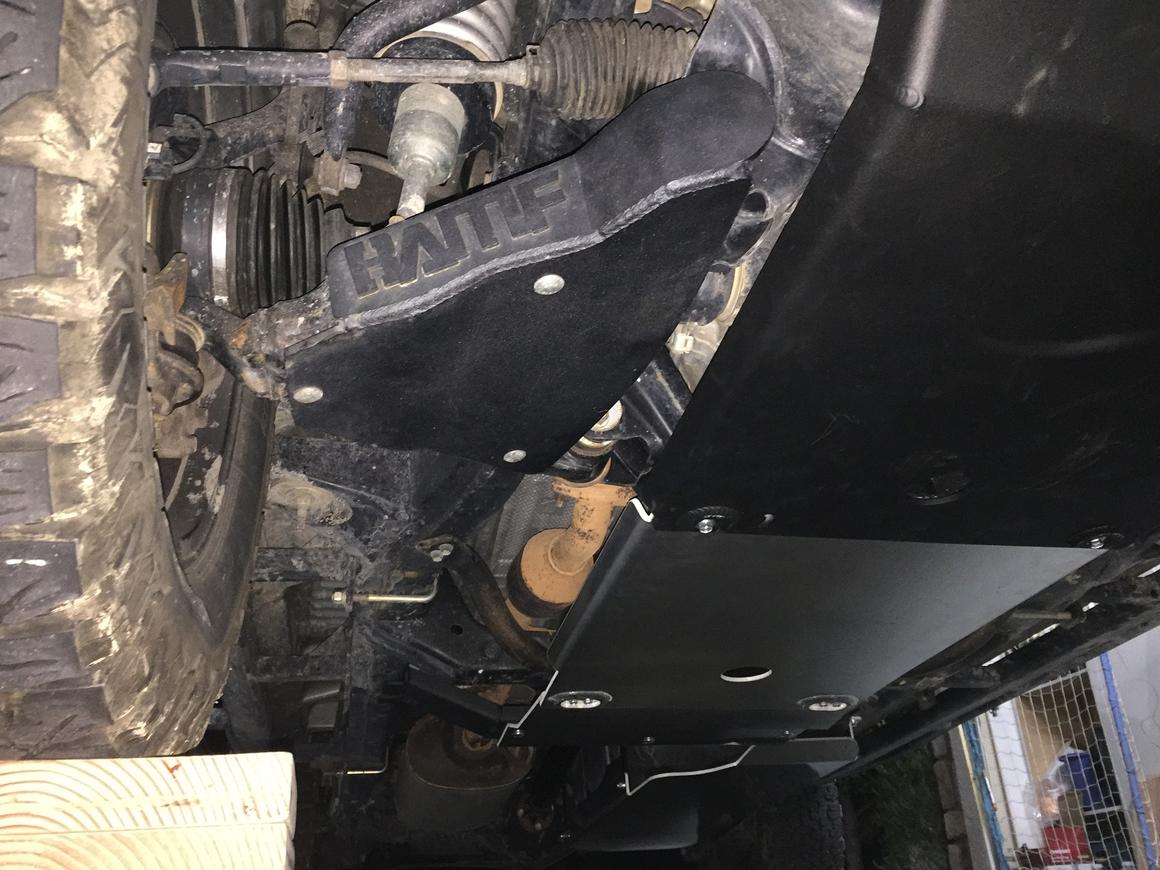

Finished armoring up the front with the A-arm skids... Had picked up a set of (barely) used BAMF ones a while back and got them installed.

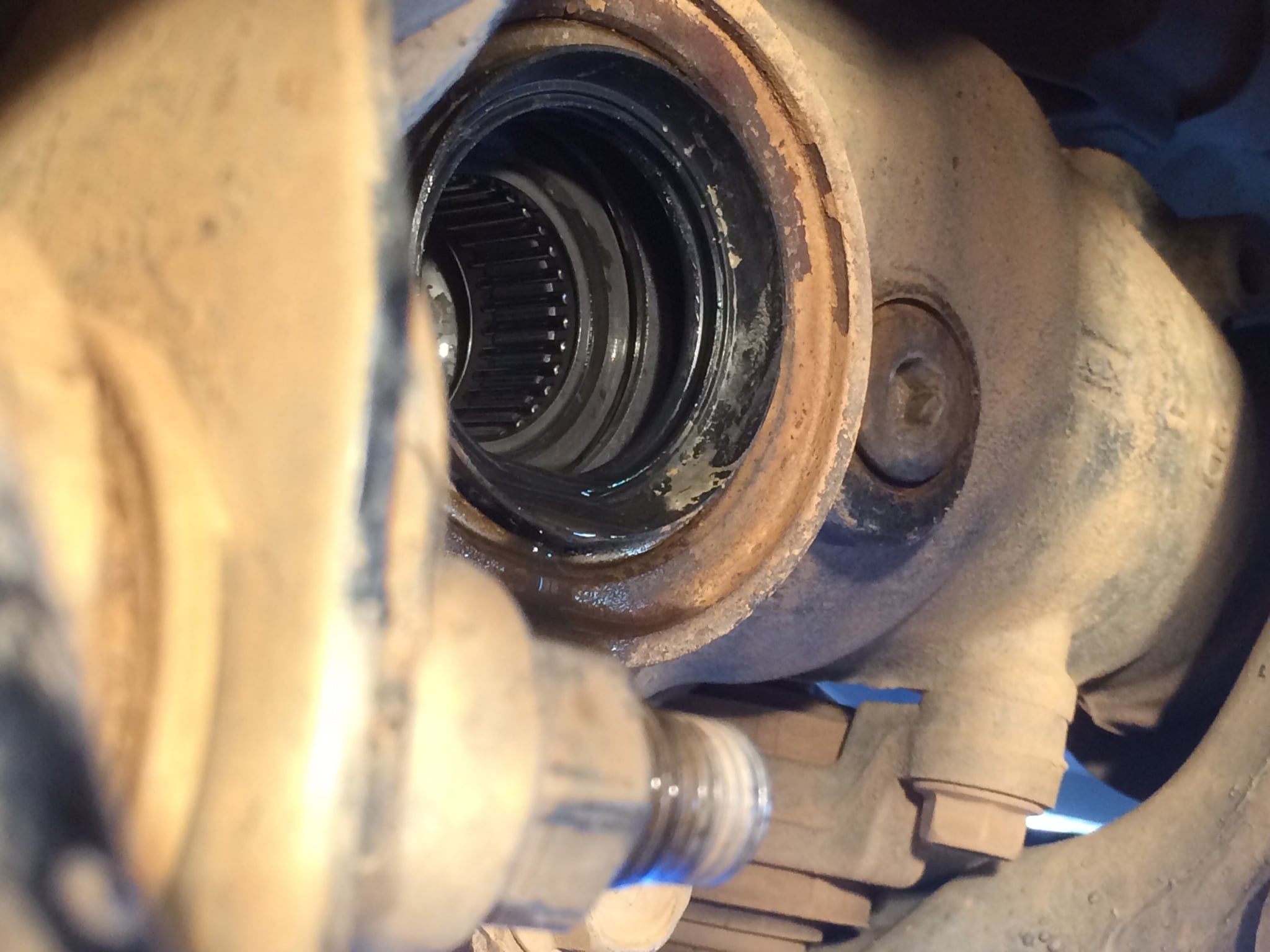

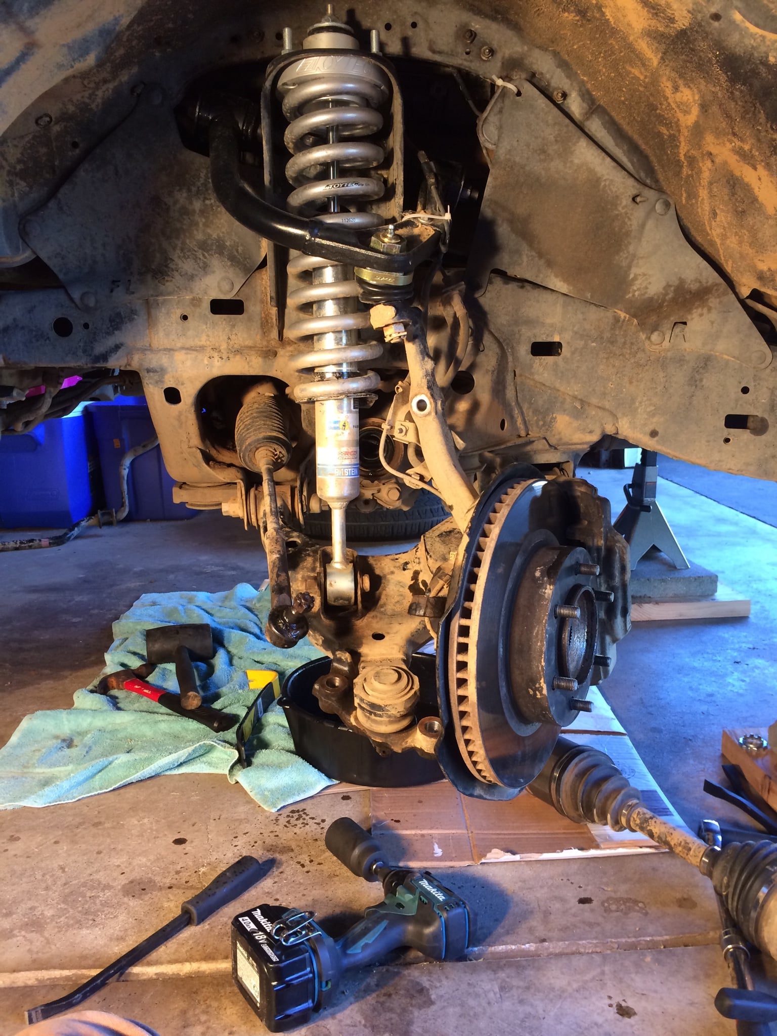

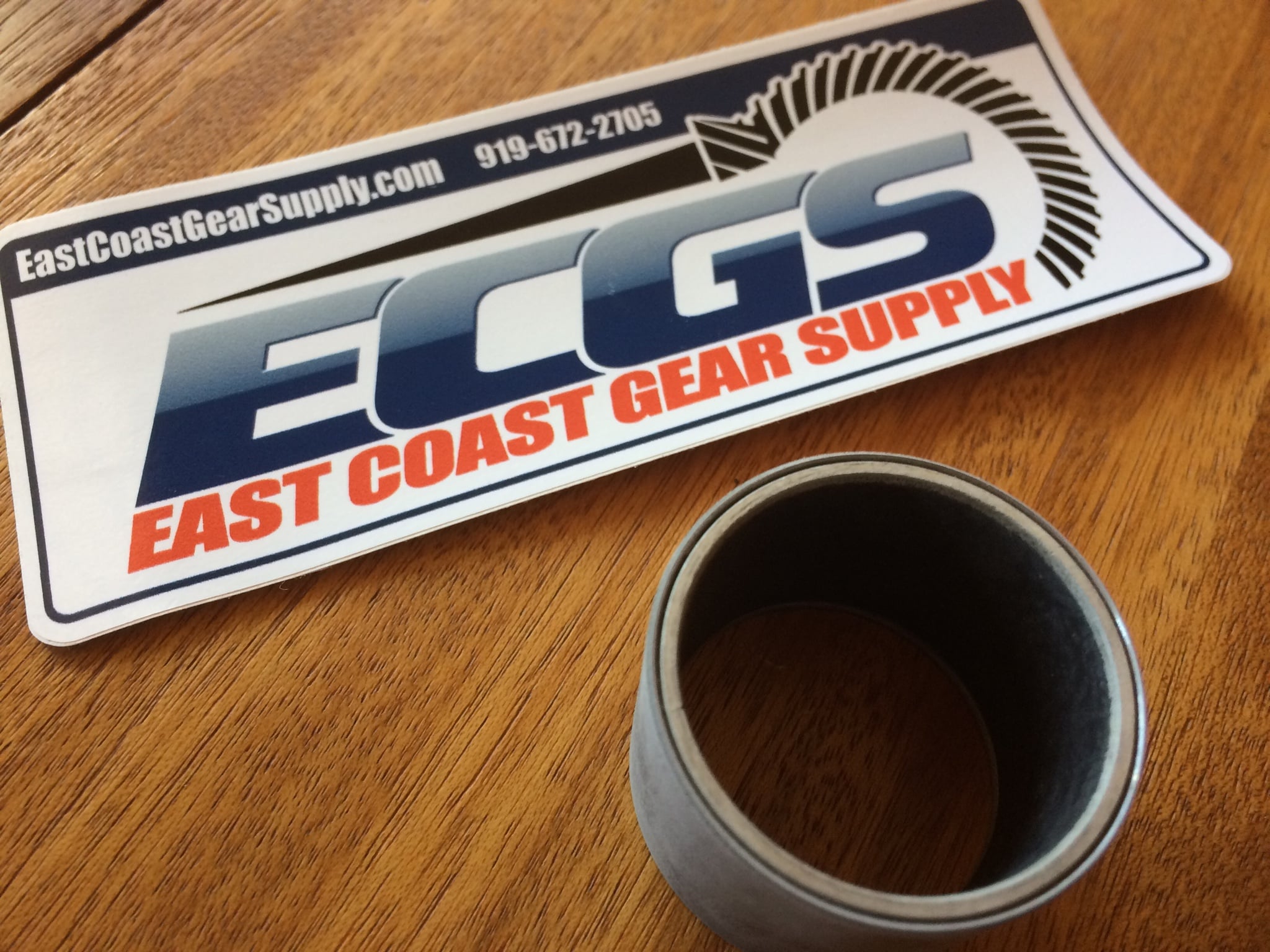

Tore my front end apart to install the ECGS bushing, which replaces the faulty Toyota needle bearing. Finally the vibration is gone!!!!!
you can see the Toyota needle bearing in there, which was replaced with the bushing. The bushing creates a tighter fit, and is designed to last the life of the vehicle.
Shout out to fdbyrne from the forum for letting me borrow the bearing removal tool, and a little advice for a smooth install.

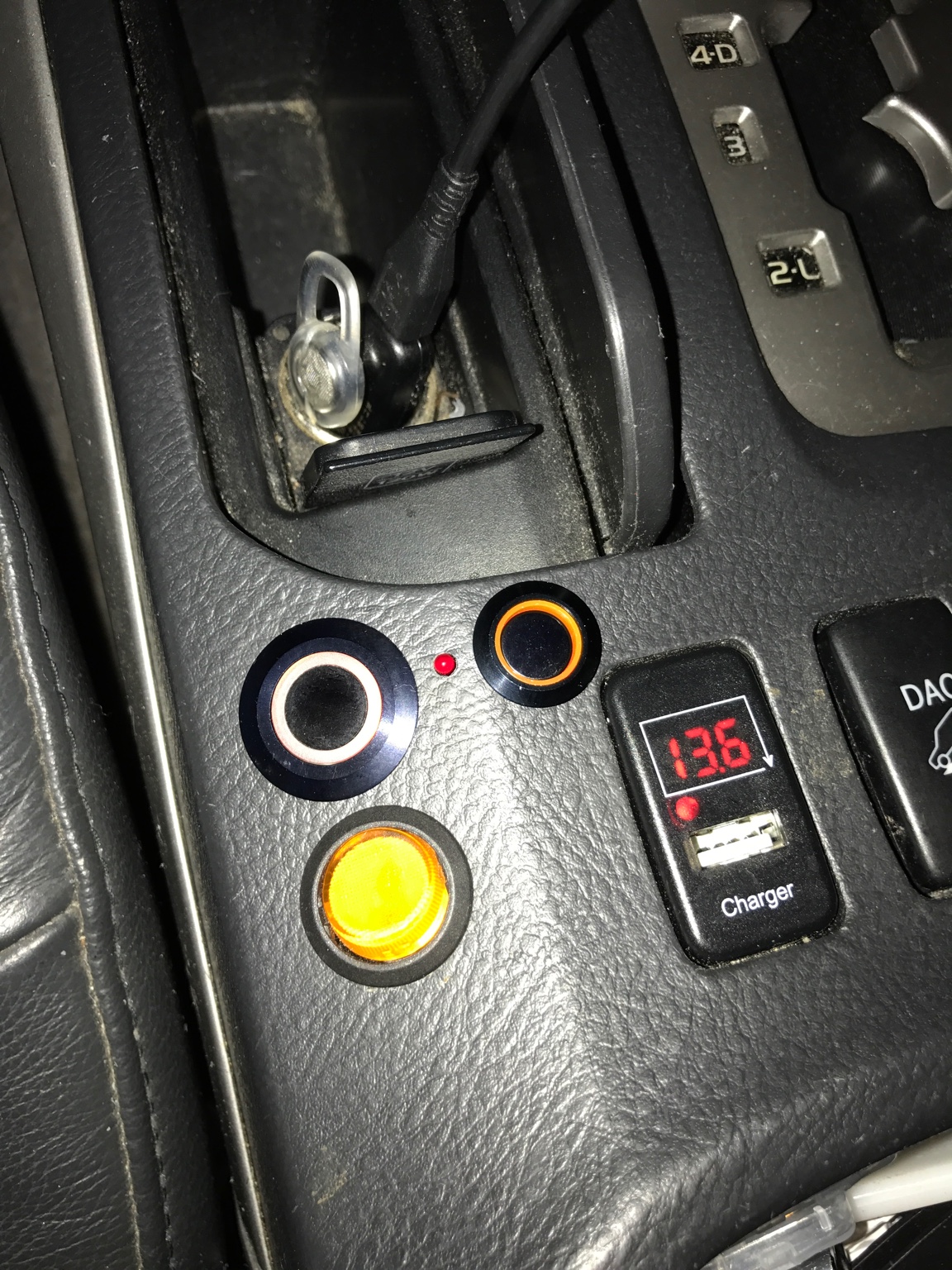

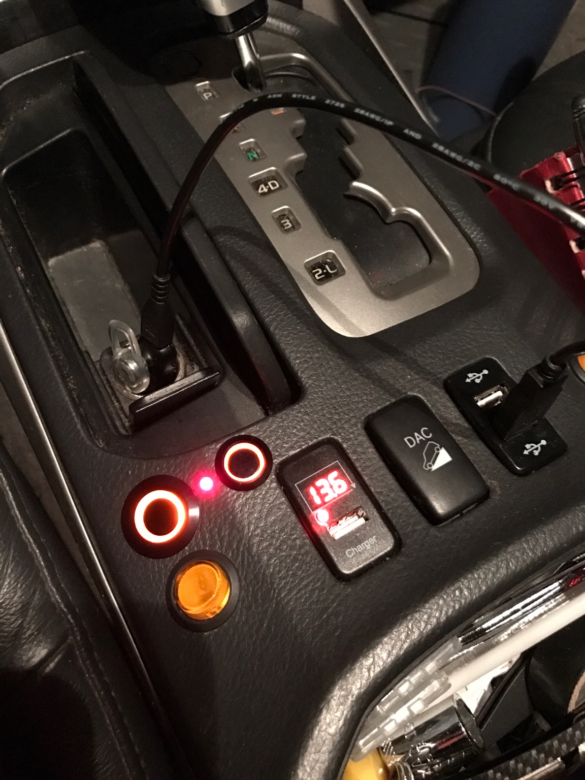

Installed some nice clean switches and a power indicator last night. The large amber one towards the armrest were already there when I bought the truck and are for the heated seats
Something to check on- I've got the RCI's and that bolt nearest the wheel---> make sure it doesn't stick up too far. It may look good sitting on the ground, but when it droops the damn bolt tore up both CV boots. There isn't much room there when it's all the way flexed out. Just something to look at before you get out and find both boots shredded.
Sent from The Far Side
Thanks for the heads up!
Yeah, I noticed the clearance on the one bolt at the top of the A had very little room ... then noticed three different bolt lengths and figured the shortest went there so I'm hoping I'm good. But I'll definitely double check before wheeling next weekend. Thanks!!
