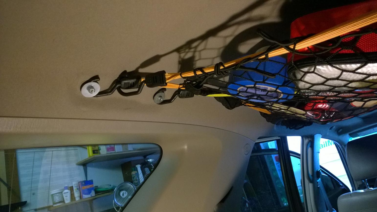

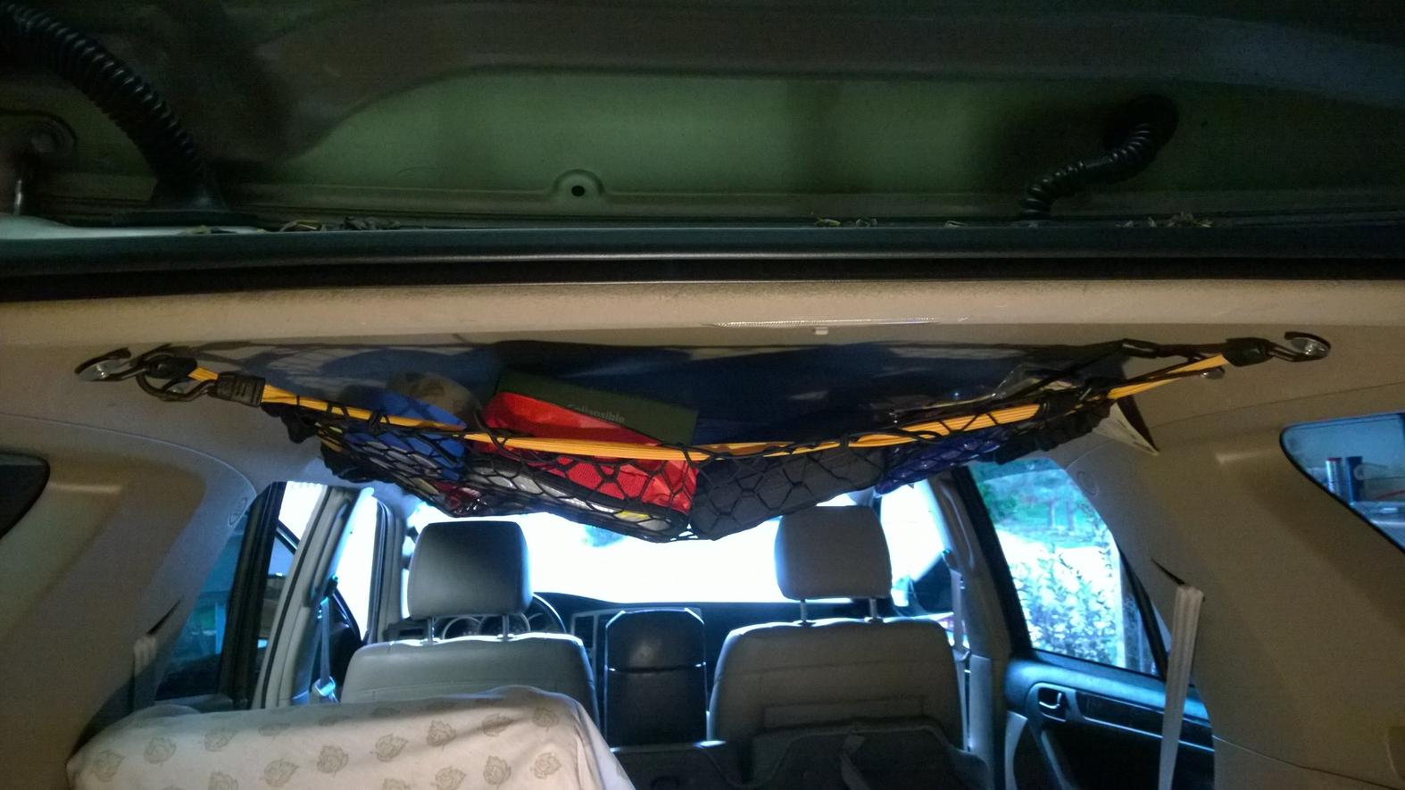

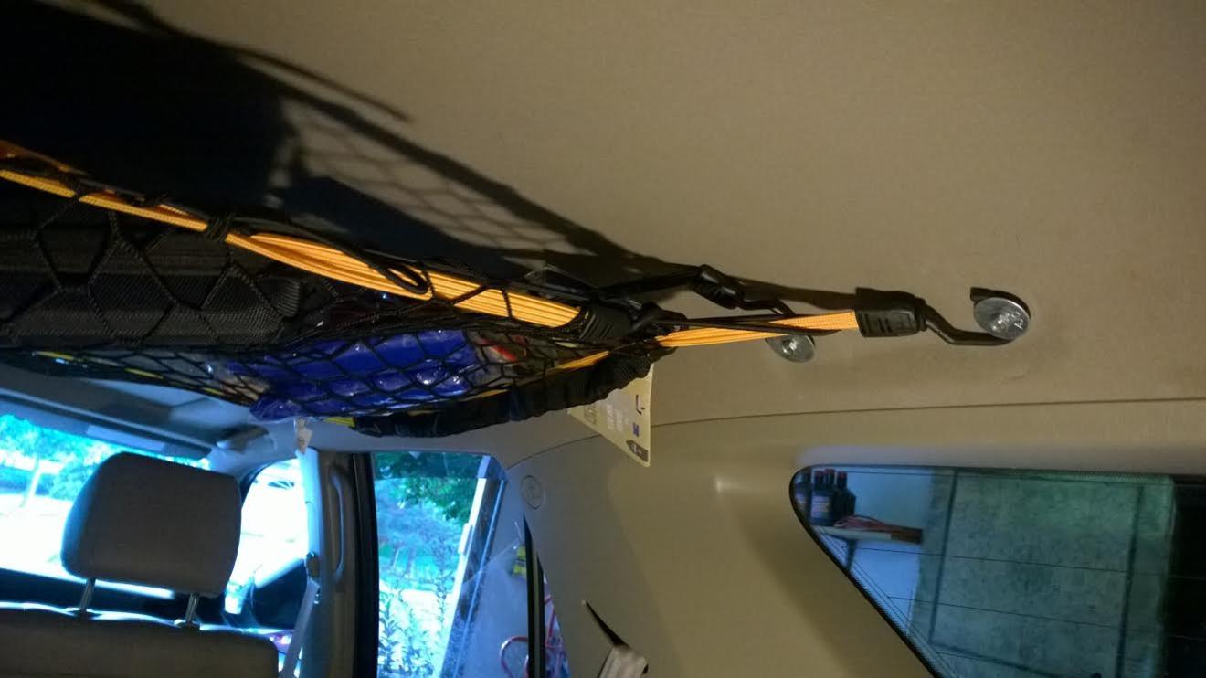

Re-installed the overhead cargo net on the '07. Just an OEM spider net meant for the floor area moved to the roof, PT347-89030. Weave bungees through the mesh, anchor one end of the bungees on the passenger grab handles. Anchor the other end of the bungees by removing the rear grocery hooks, reuse the bolts with a large washer. I used six bungees, two front to back, two side to side, and two crisscross. Holds a lot of gear.

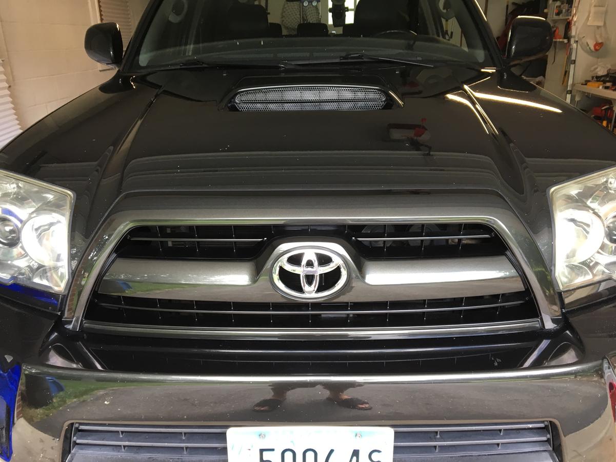

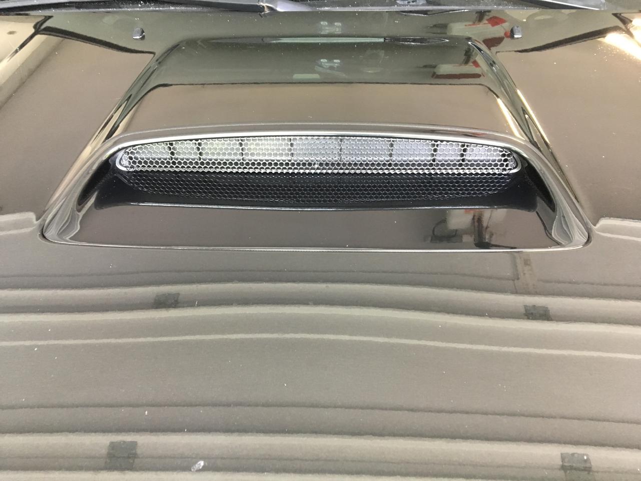

I put a limited grill on my sport edition and replaced the faded hood scoop with a new one.
