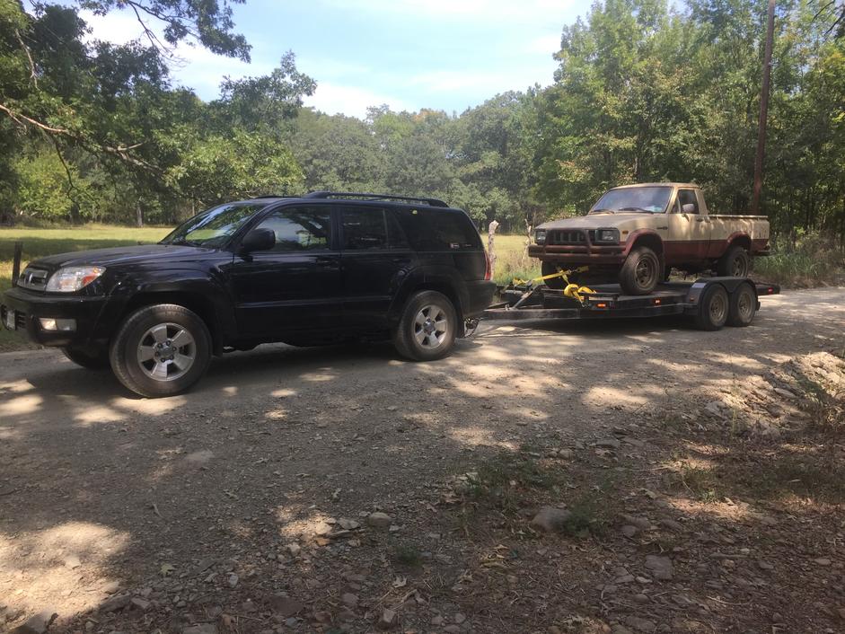

Went for a short trip to Oklahoma to pick up a 1983 Toyota pickup my dad bought. It went great. Most of the roads were fairly flat and I was able to cruise in 5th gear and maintain a 65-70 mph pace without it wanting to hunt for the correct gear.

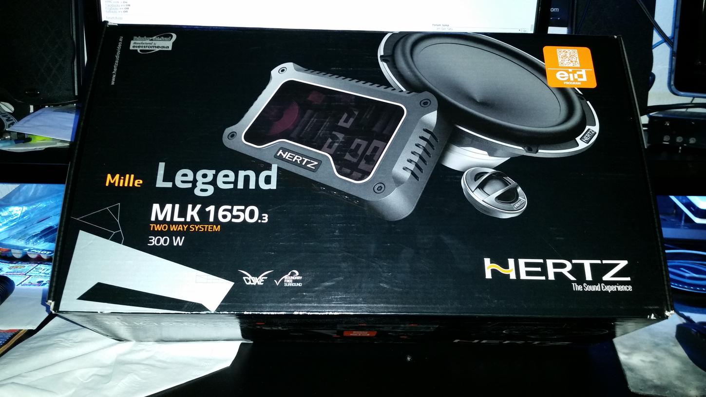

How did you wire these?
doing passive right now, my rockford amp have enough power to push it, although some post i seen says 250w and up.
want to try and do active, i can use my rear amp to power the tweeter and get rid of the rears in general, not sure if i want to risk blowing up my speakers since i play pretty loud at times.

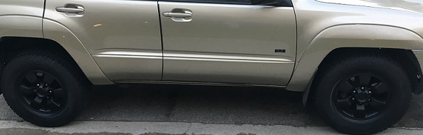

I just mounted my set of 5th gen trail wheels and the center caps went on just fine, not sure why you would need to trim anything.
It's weird. I have seen pics of others who mounted them and no mention of them not fitting. When I go to put mine on, they don't want to "snap" in securely. Almost like the hub is too true or something...:confused::shrug:

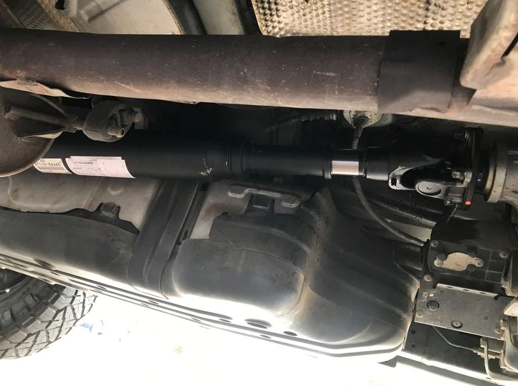

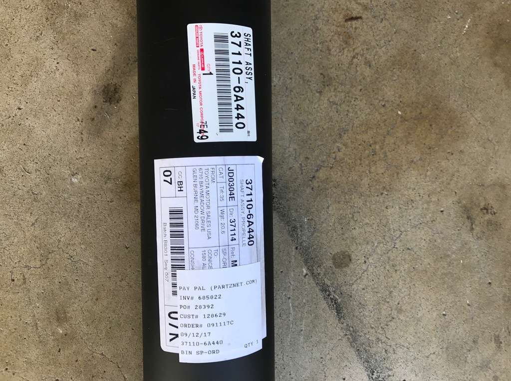

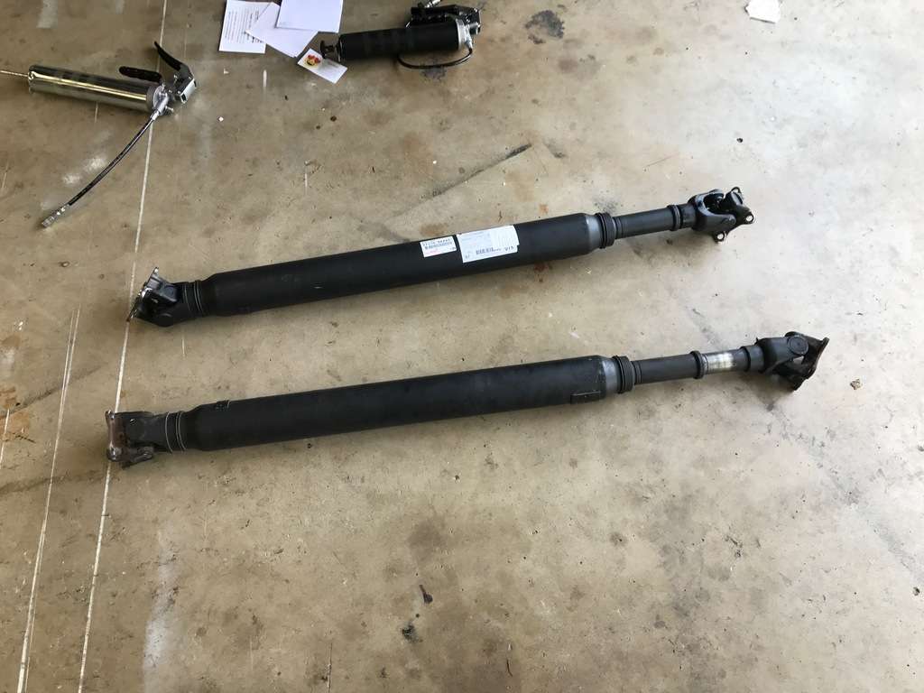

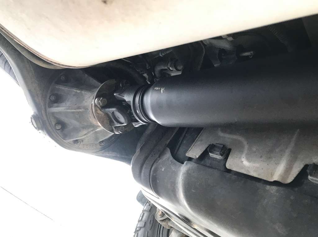

I replaced my rear driveshaft today. No matter how much I greased and cleaned the old one, the clunk would not go away for more than a day or two. Now it's soooooooo smooth. It was a pretty easy job to do once I figure out the front end bolt situation. The front (transfer case end) is just four 14mm nuts. The bolts are part of the flange and cannot be loosened. The rear (differential end) is four nuts and bolts. Just put a combo wrench on the nuts and a breaker bar on the bolts and you're good to go.
The new drive shaft:
New and old side by side:
Transfer case end of the new shaft:
Differential end of the new shaft:
