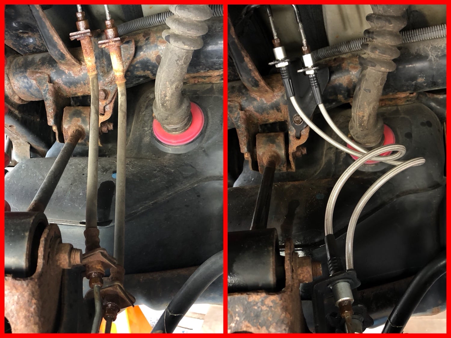

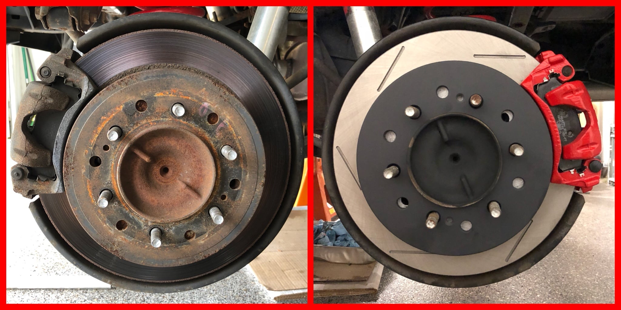

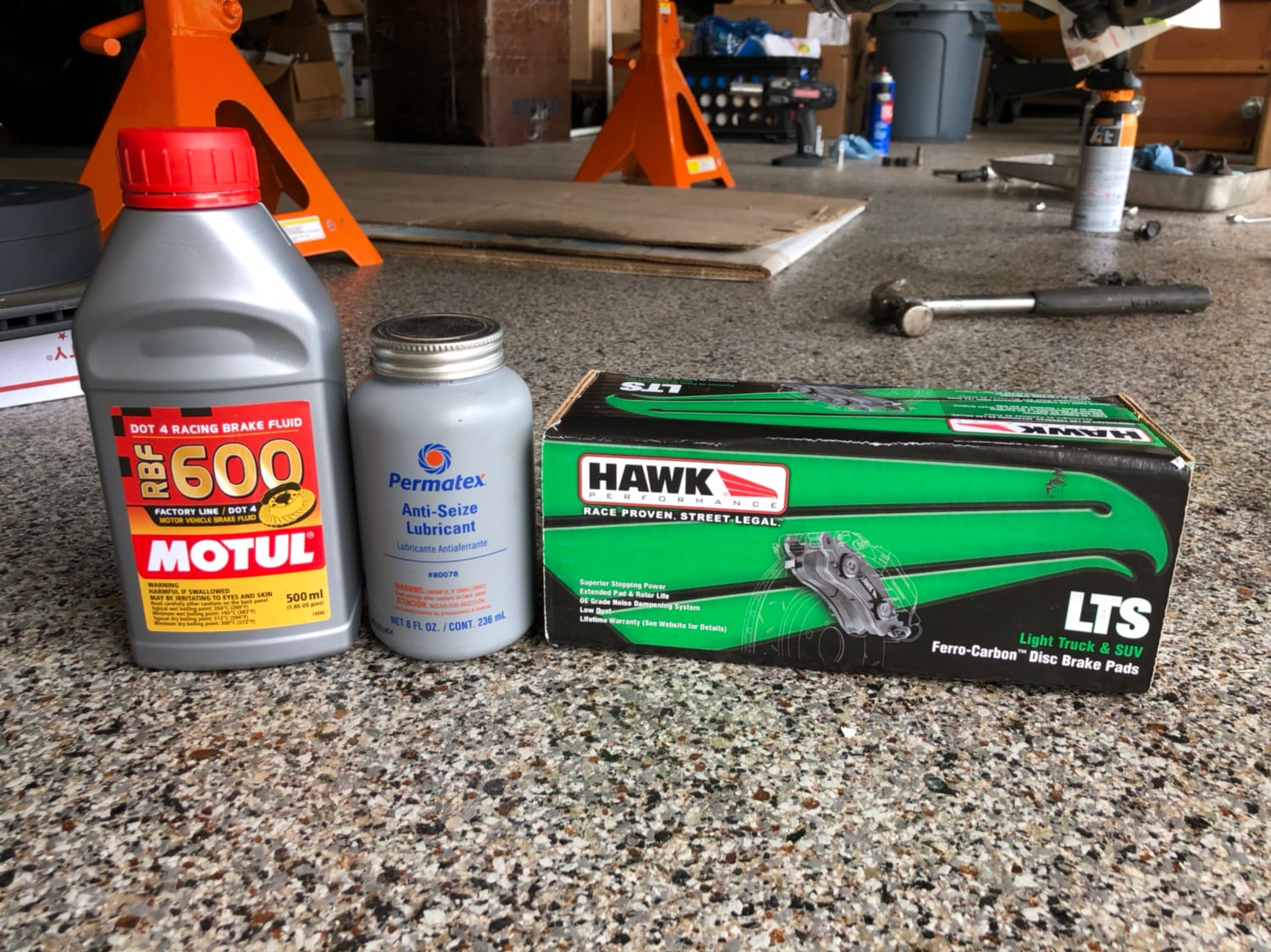

I did the 5th gen rear caliper with 4th gen slotted stop tech rotors today. Did Stoptech ss caliper lines.
Went with Hawk light truck pads.
Also replaced the center lines with 20” lines from Low Range Off-Road.
Here's the direct links to the details otherwise the above is just the cliff notes version.
SS Center Line
Rear rotors and Calipers

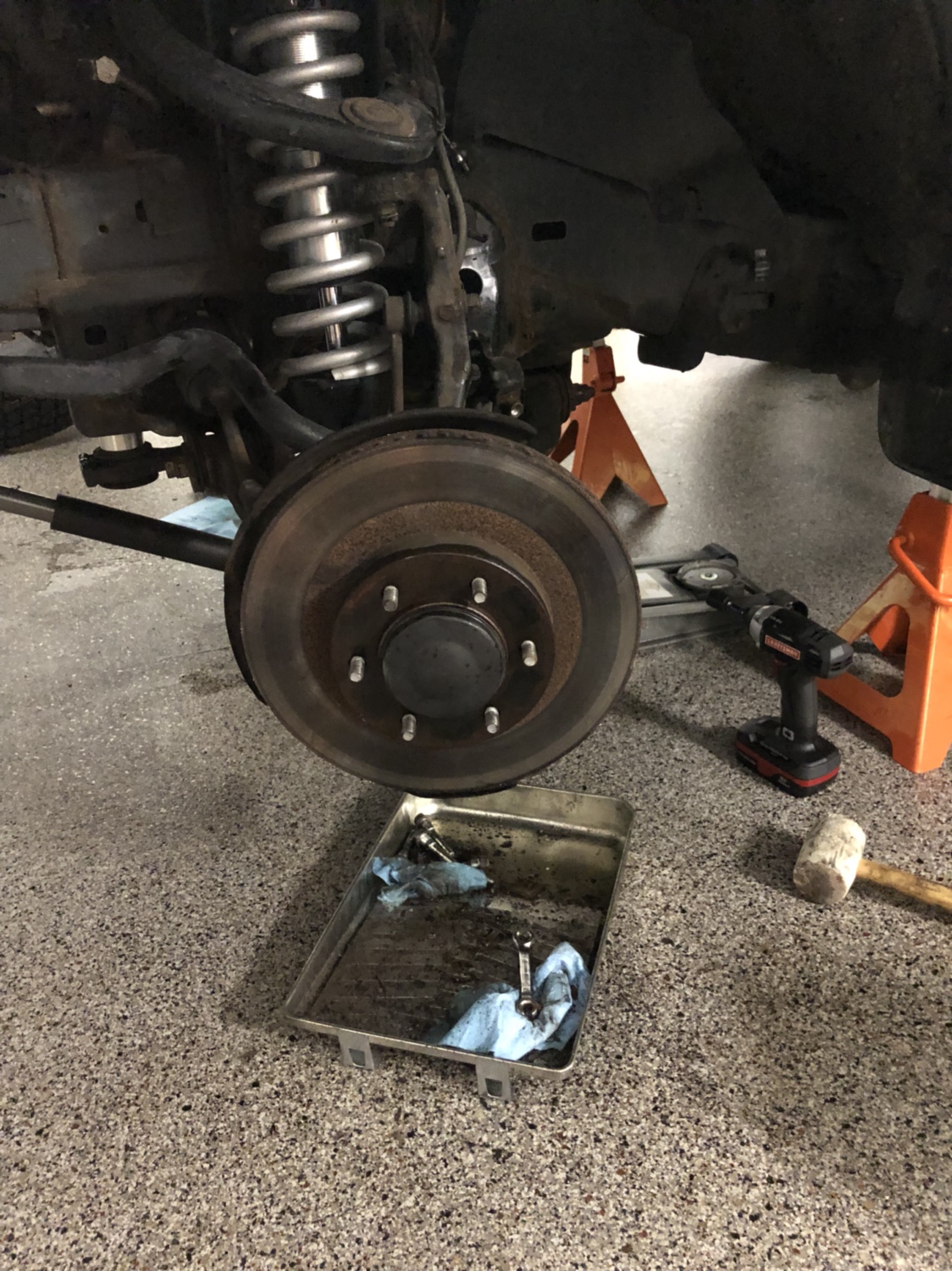

Buttoned up the rear and tore down the front. Not much happening. Rotors seized so I gotta go get some long bolts from the hardware store.
Whacked away for 30 mins with no budging...
