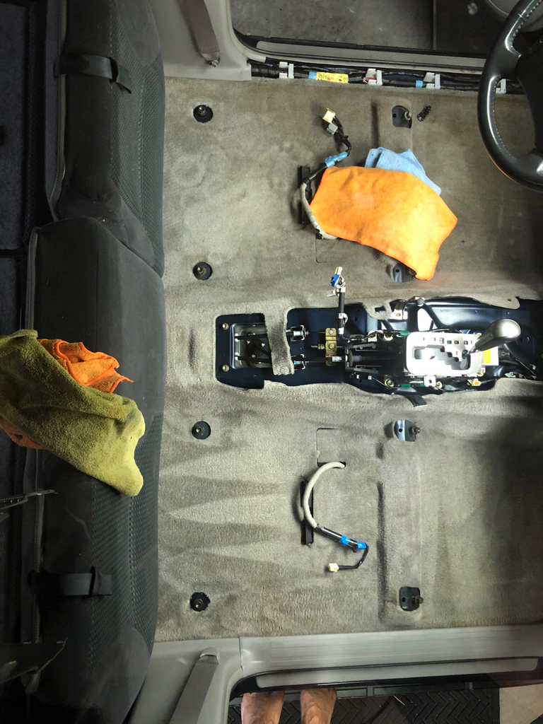

I sound proofed by doors and rear a while ago, so I decided to do the entire floor while I installed a new four channel amp. Layers include Dynamat, CCF, and MLV.
Haven't gotten a chance to drive it around, but with the engine on and revving a little in the driveway, it's noticeably quieter :)

you see the factory ground point at the front seat bracket mounting hump? its a good place for amp ground, better than using seat bracket to sandwich it together. lets us know how that 4 channel worked out, and the ease of install.

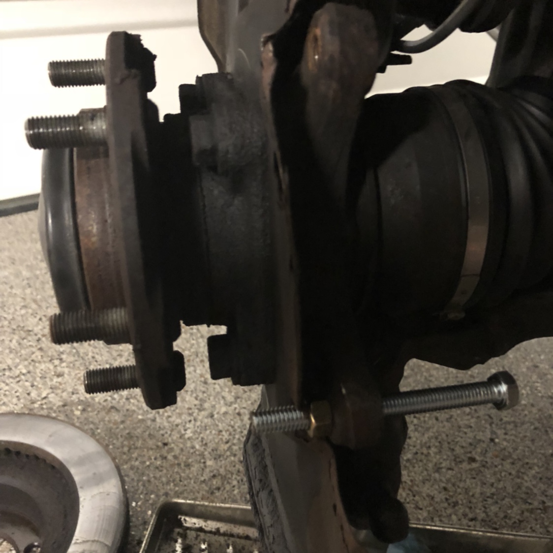

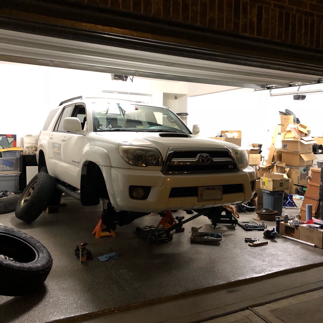

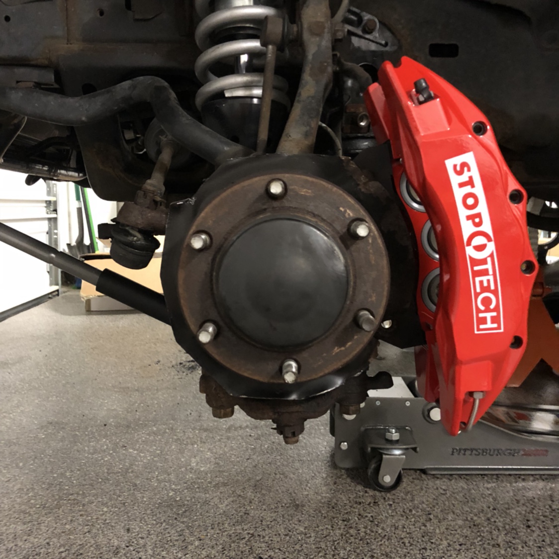

I’m on maybe hour 3 of working on my front brakes. Caliper removal was a cinch. Had to break for date night and get some other materials because the rotors were frozen.
Used the bolt method for the drivers side. The bolt didn’t work on the passenger but a few whacks with a mini sledge hammer did the trick. Rotor almost fell off and took out the finish on my garage floor [emoji23]
Just need to coat the calipers with the ceramic coating and I’ll get her bled and back on the road. Last thing left will be lower / upper control arms and rear sway bar links.

Damn those are sexy

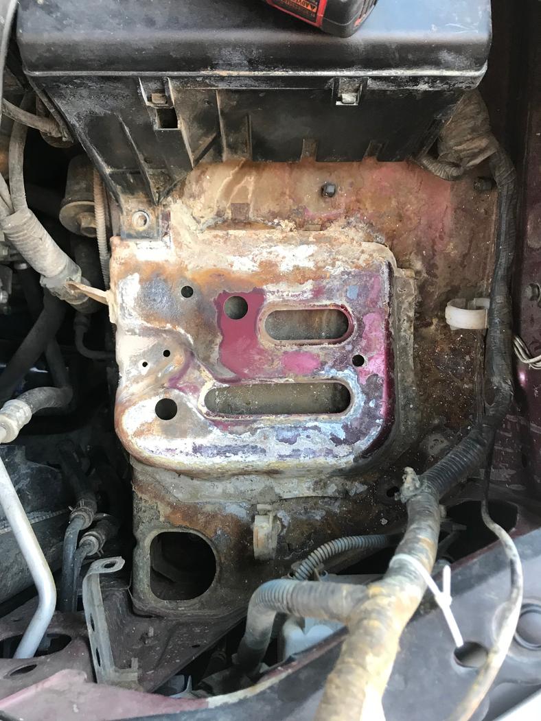

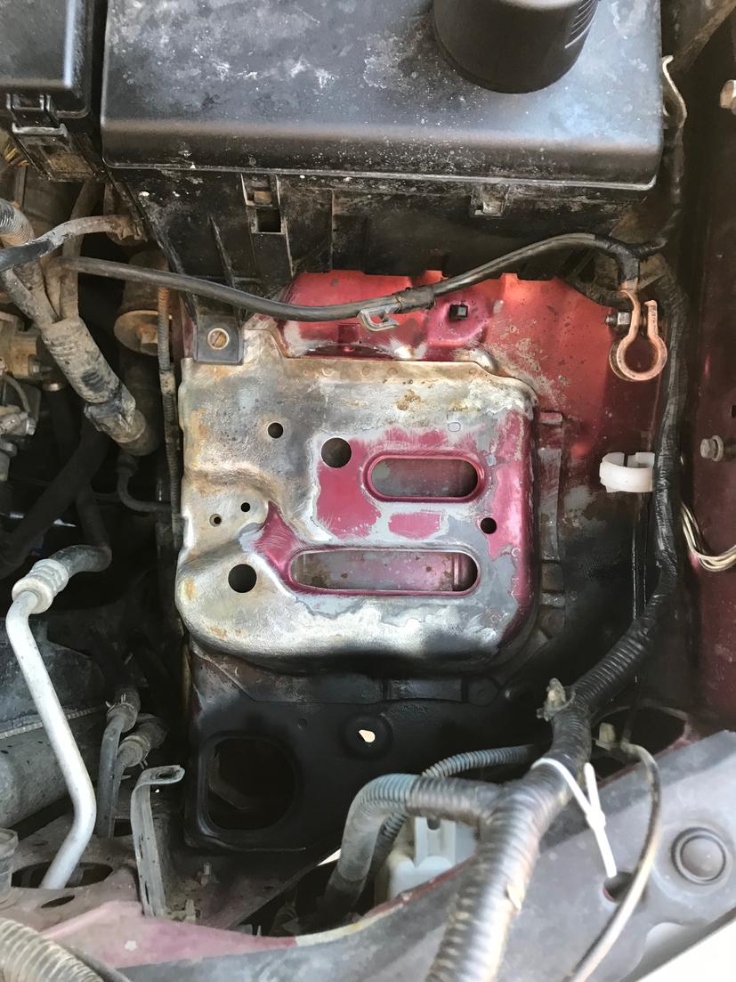

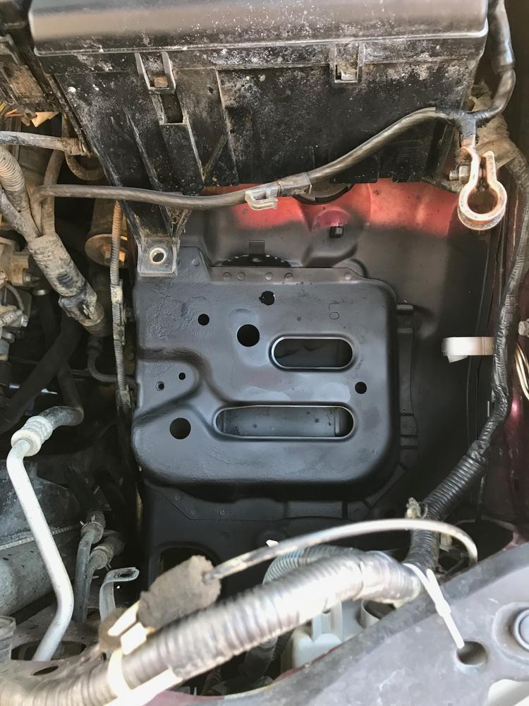

First time poster here! I've had my 4th gen for about 2 months now and have been nothing short of in love with it! I changed the battery a couple days ago and noticed a build up of corrosion and rust in the area around it, so today I spent the day grinding and vacuuming it out, then cleaned with baking soda and water, then put down a layer of rust reformer!

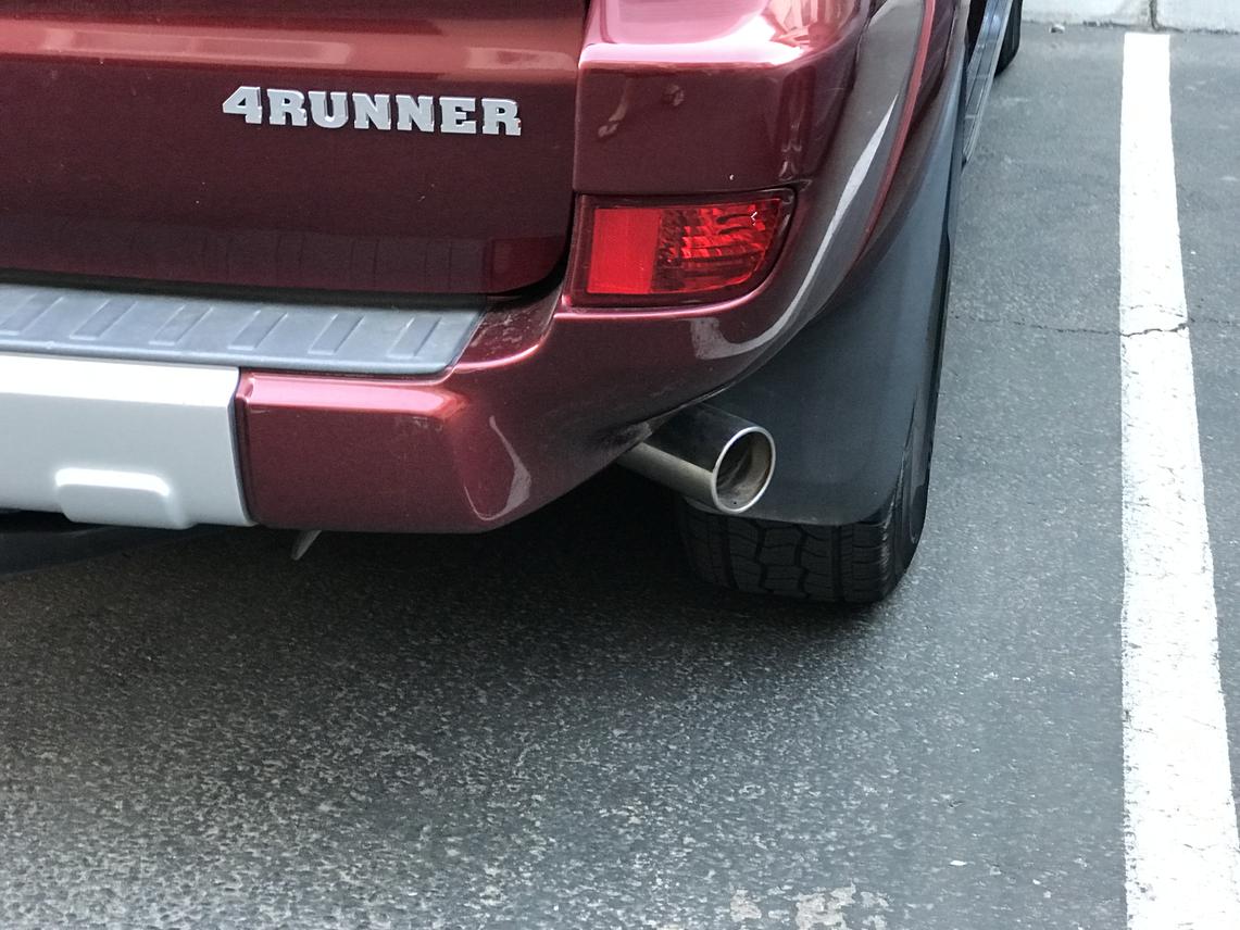

As a bonus, a few days ago I also had a local muffler shop move my tail pipe out behind the rear passenger tire!

[MENTION=245985]codeman528[/MENTION], what did the muffler shop charge you to reroute your exhaust? Looks like you kept the factory chrome tip? I'd like to do exactly the same thing and am wondering what a fair price would be.
[MENTION=114846]Bluesky 07[/MENTION], the shop charged me $55 for the work. They removed the resonator, made a new hanger, and retained the stock tip; overall I'm pretty happy with the work they did! Here's to hoping its enough out of the way to stop melting coolers on my hitch mount cargo carrier...
Thanks, that seems very fair. Any difference in the sound without the resonator?
