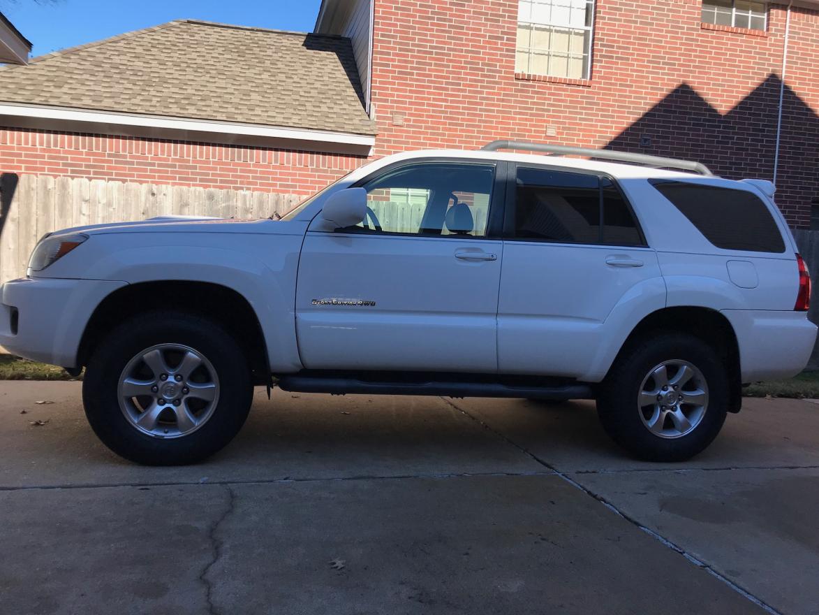

You can set your Bilsteins to get up to 2.25” lift up front, and add an inexpensive spacer for the rear if needed and keep the stock springs. Here’s one of mine with that.
That's with the spacer in the rear? That's already about where the rear of our sits right now, stock. Not going for lift right now (planning on running these tires for at least another year) so I think the 2nd notch (.85) should be enough to level it.
