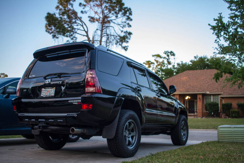

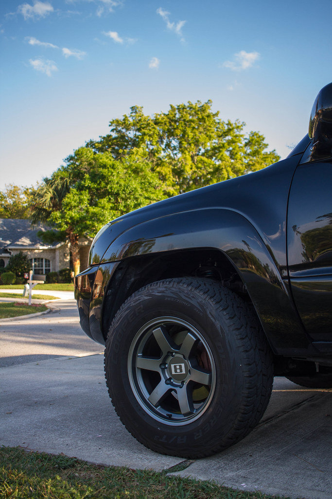

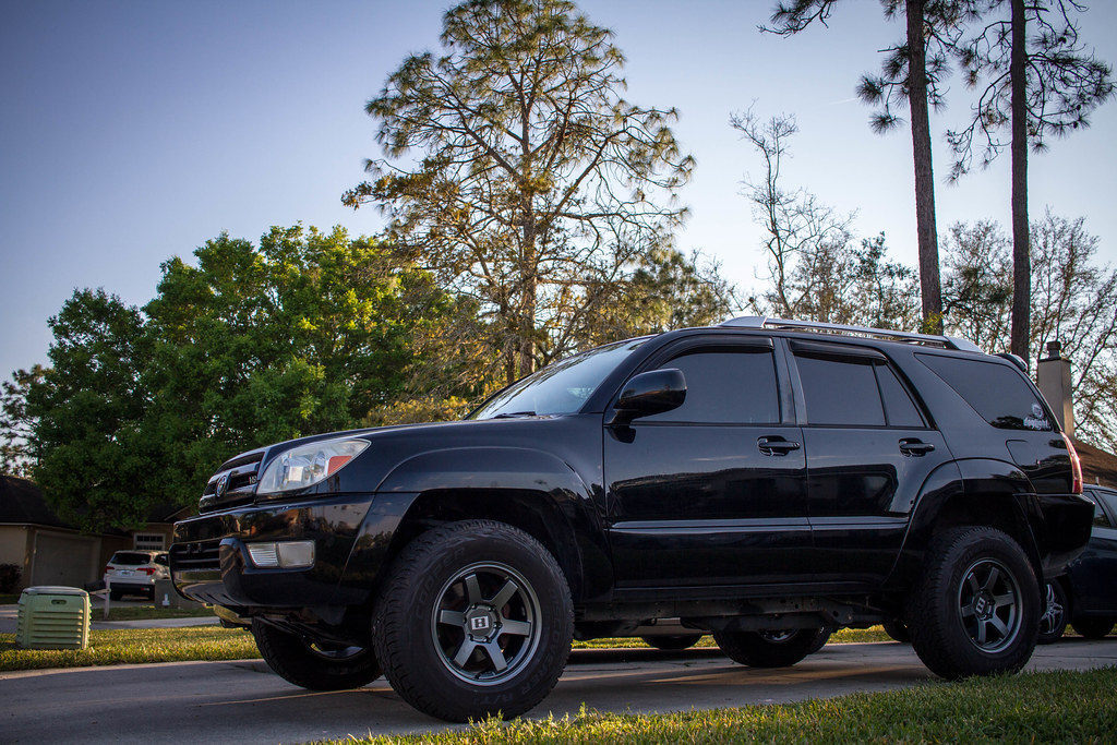

Well Xreas started showing its age so I picked up 2015 Tacoma TRD springs and 4600 bilstiens. Then ordered some new top hats and 5100s for the rear with a 1.5" Daystar spacer. Since I was gonna swap out the suspension might as well get some new rims so I ordered a set of lvl 8 MK6 17x8 -10 and swapped over my 265/70s. Oh and I wrapped the silver section of the bumper and purposely left just a little visible, something different.
Sat in my garage asking to be taken off road again, it’s been 2 years since it last seen mud.

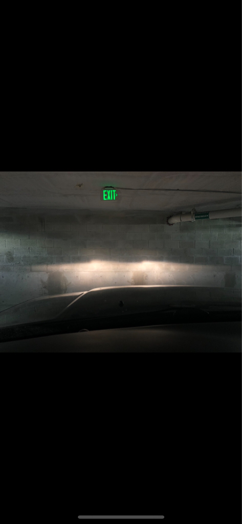

$30 sylvania halogens vs xenon depot 5k hid kit

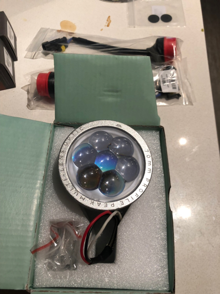

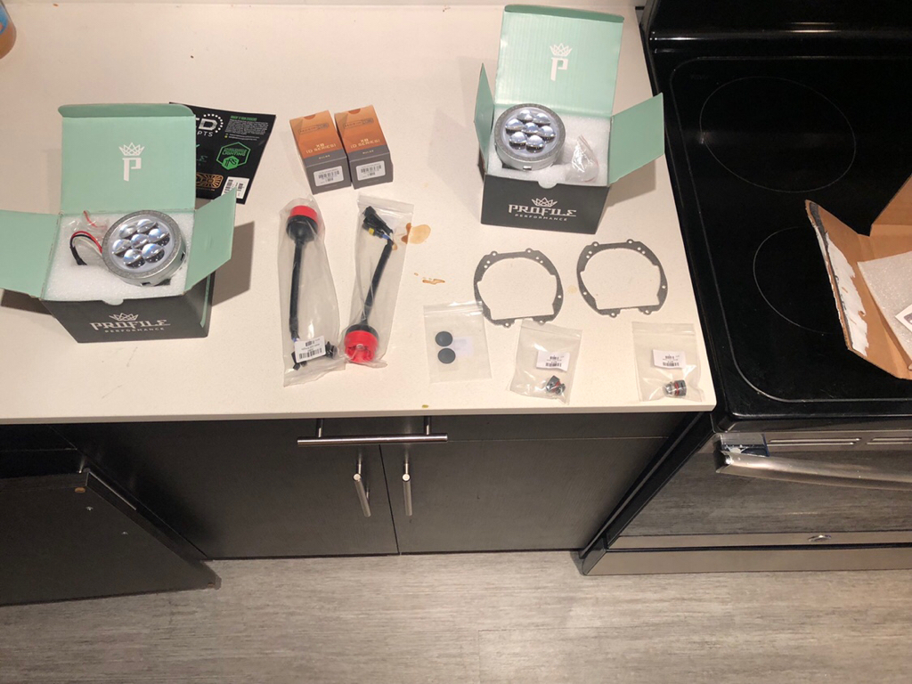

Still have to re aim the lights for hid and the bulbs are only temporary, I just received all my parts for a full D2s 4.0 retrofit with profile hi lens led in my high beam.. that’ll be coming around mid May most likely when I’m out of school for summer

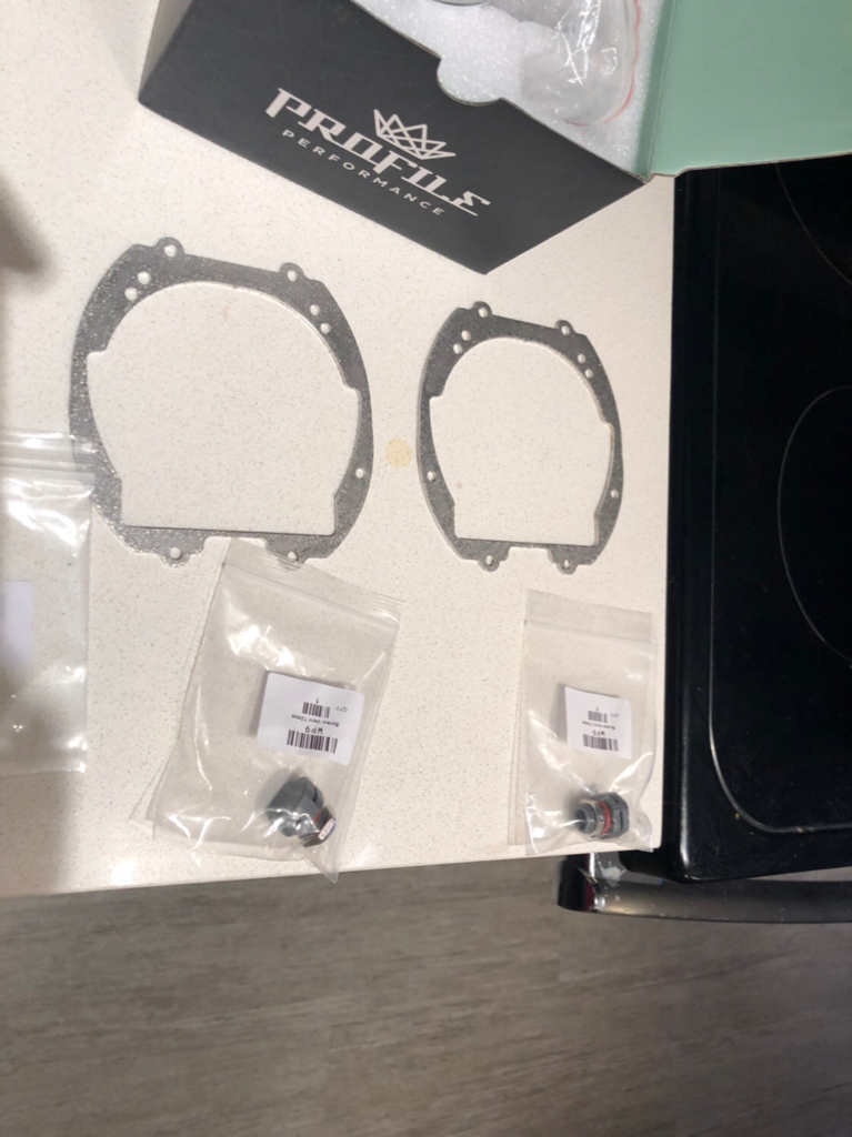

Got my parts for my retrofit in the mail the other day
Profile Hi lens led projector to go in the high beams
Already own (not pictured) D2S 4.0 projectors for low beam
Already installed (not pictured) xenon depot hid kit
I have the amp to D2s straight connectors and Morimoto 5k D2s bulbs for the projectors
I will be using those metal brackets to mount the projector

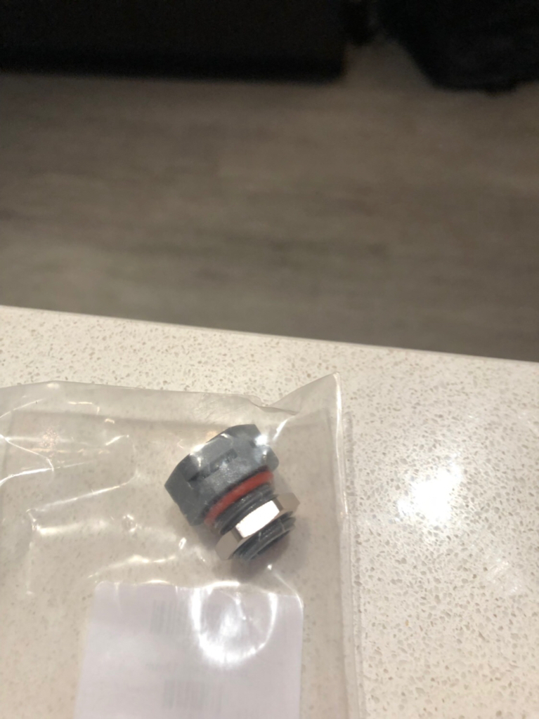

And I picked up 2 screw in breather vents and 4 goretex breather vents just Incase I decide to buy a separate aftermarket housing to do the retrofit in rather than the one housing since my lenses are pretty yellowed around the edges

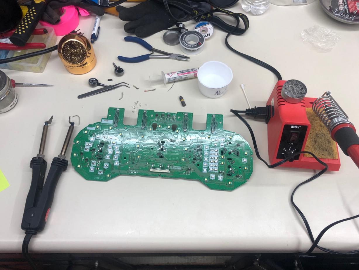

Hooking [MENTION=50507]CookieRoe[/MENTION] up with a cluster correction that someone else really screwed him on! Luckily not around anymore!
If anyone is interested shoot me a PM.

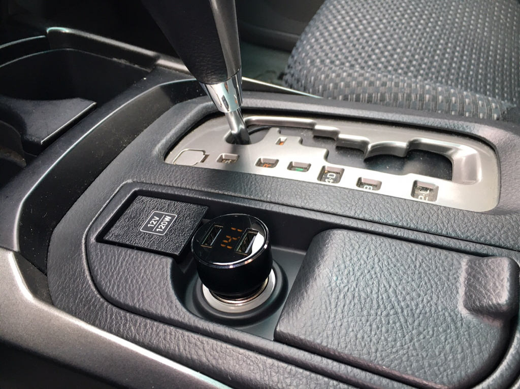

Inspired by [MENTION=50507]CookieRoe[/MENTION]
“Ashtray Kit” for $19.24 and the USB charger for $12.99
So much more useful than the rectangular storage area with the door on it. We can now charge two phones and still power another device without a big multi-port charger sticking out! I pulled the silver metal part out of the ash tray cubby and store cords in it.

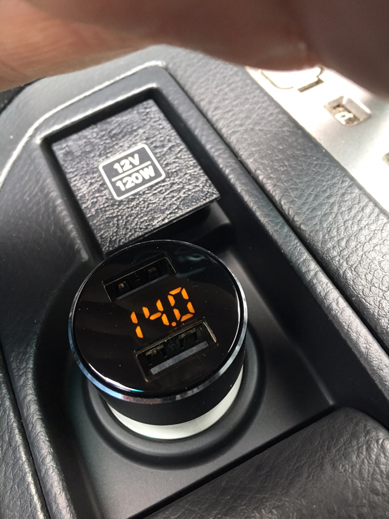

Yep, it is one of my favorite mods so far! I wasn’t sure if I’d like the tiny compartment because I used to store property keys and stuff in the other one, but I have to say that the overall looks and functionality trumps that many times over! I also removed that stupid metal cigarette holder since I don’t smoke, nor will ANYONE ever in my vehicles! I still use that little compartment to store the master keys I use the most, and moved the rest to one of the divided areas in my console (have the Vehicle OCD organizers in there), so it all worked out perfectly. I also bought a USB adapter for that spot, but I wish it had the voltage meter as that is a very useful thing to know if your charging system is doing its thing. I chose mine because it was the lowest profile one I could find, and doesn’t look like an adapter. I’m happy with its aesthetics and functionality, but that display is great.
