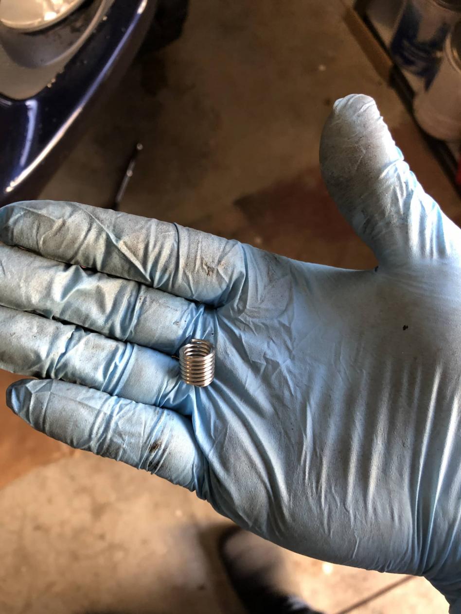

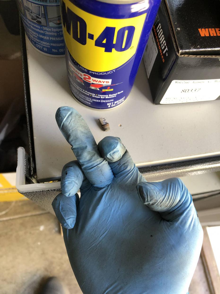

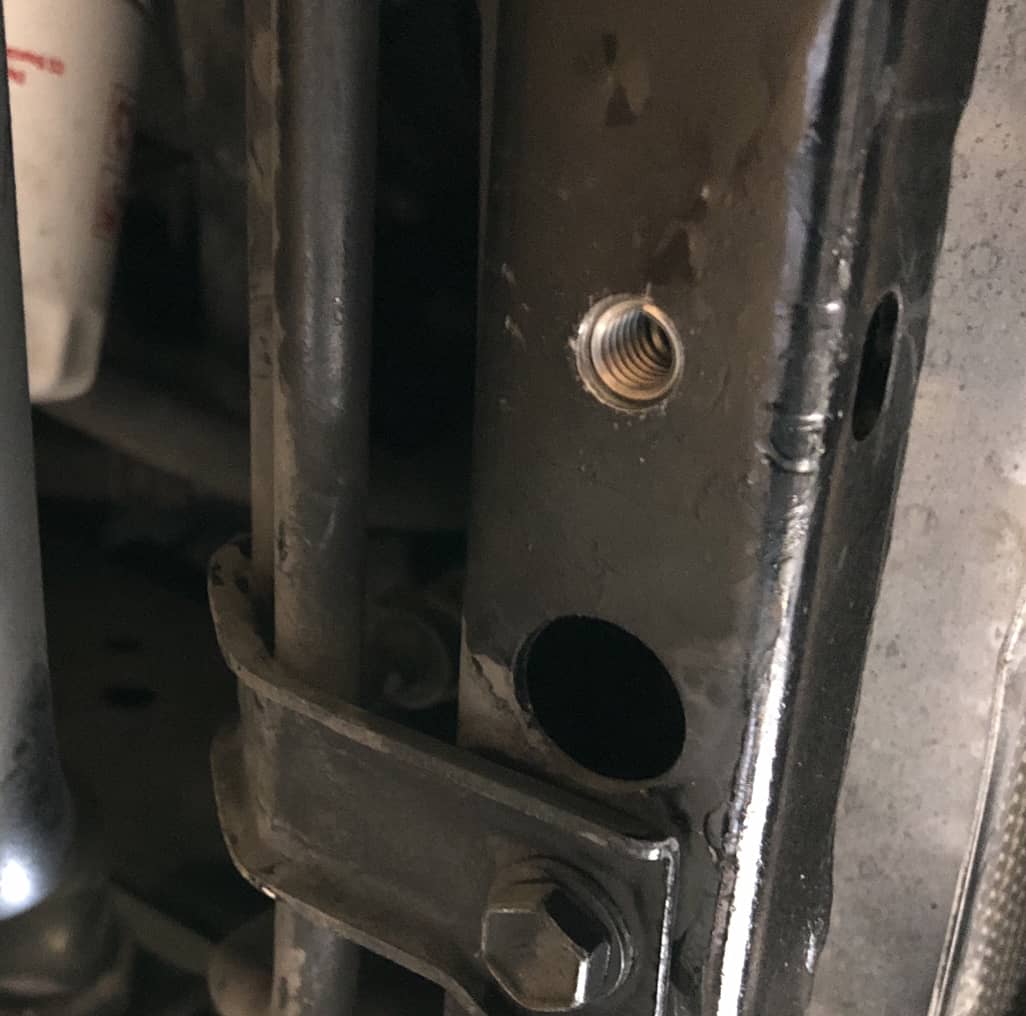

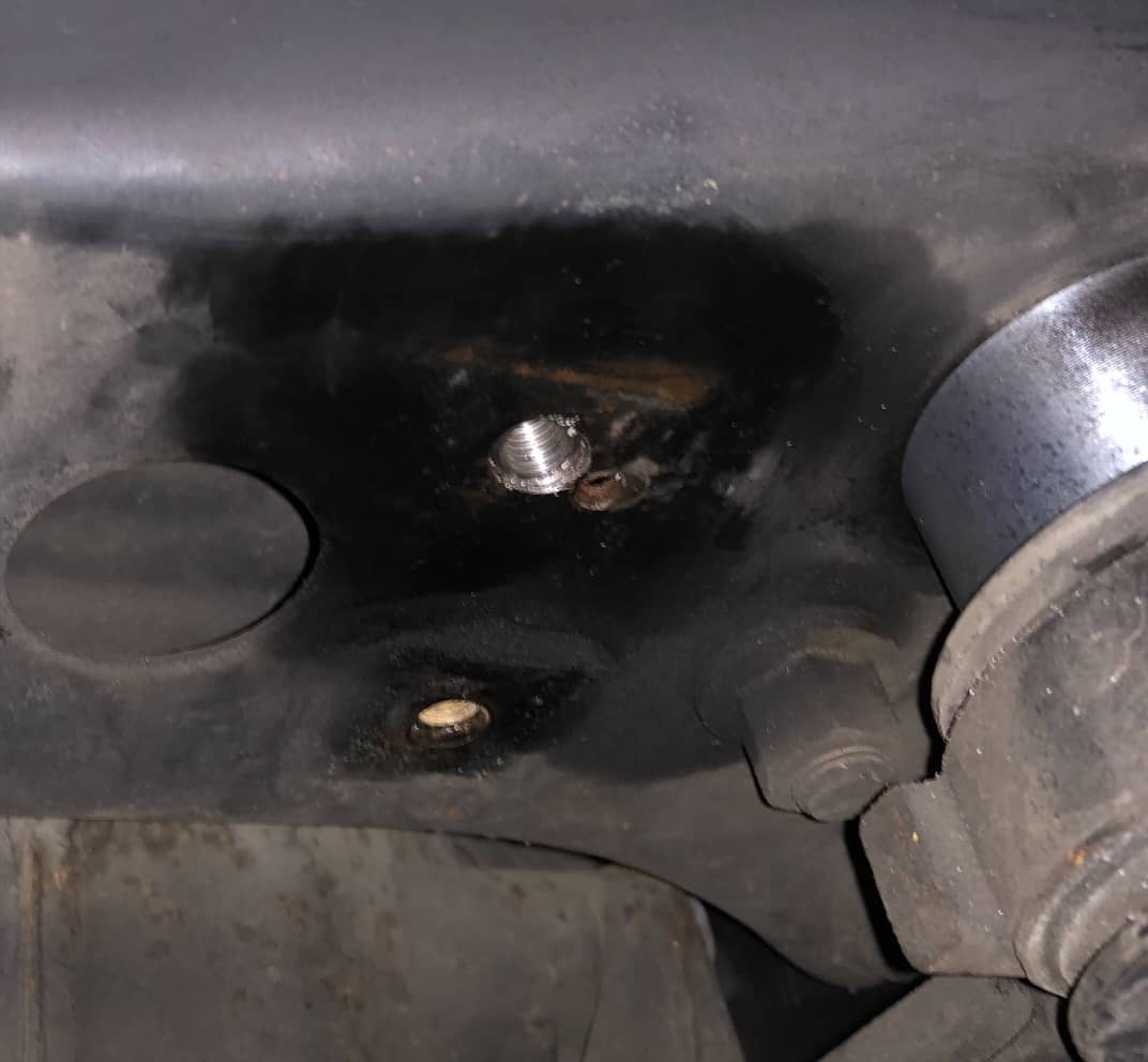

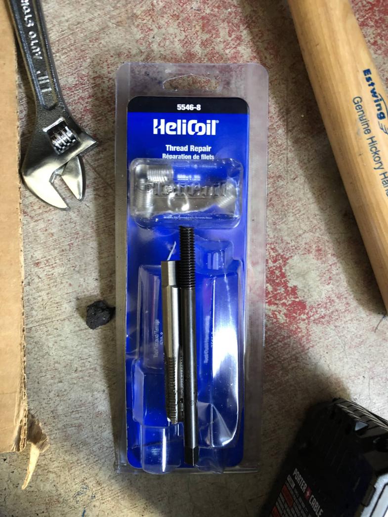

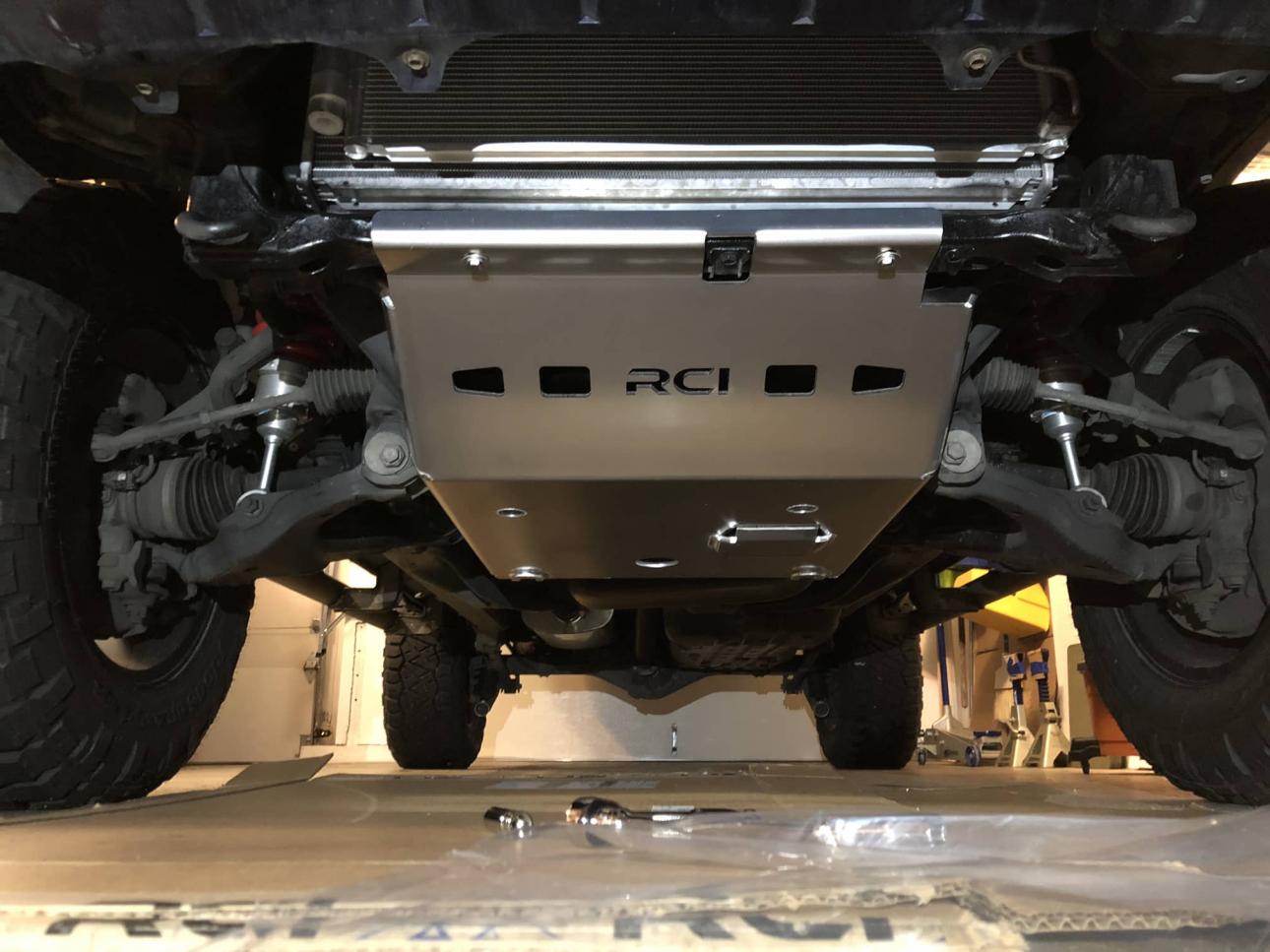

Previous owner broke a few skid plate bolts and stripped threads. My skid plates were held on with two bolts each...
Today I took the drill and m8 helicoil kit to the broken and stripped holes. Pic of one of the broken bolt tips next to the WD40 can and appropriate sentiment below.
The stainless threads are now stronger than stock. Not to mention the bolts go in butter smooth with permatex antiseize applied.
