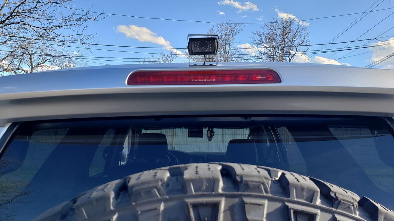

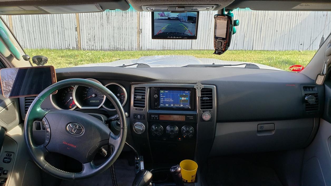

Finished up my RV backup camera. FINALLY lol

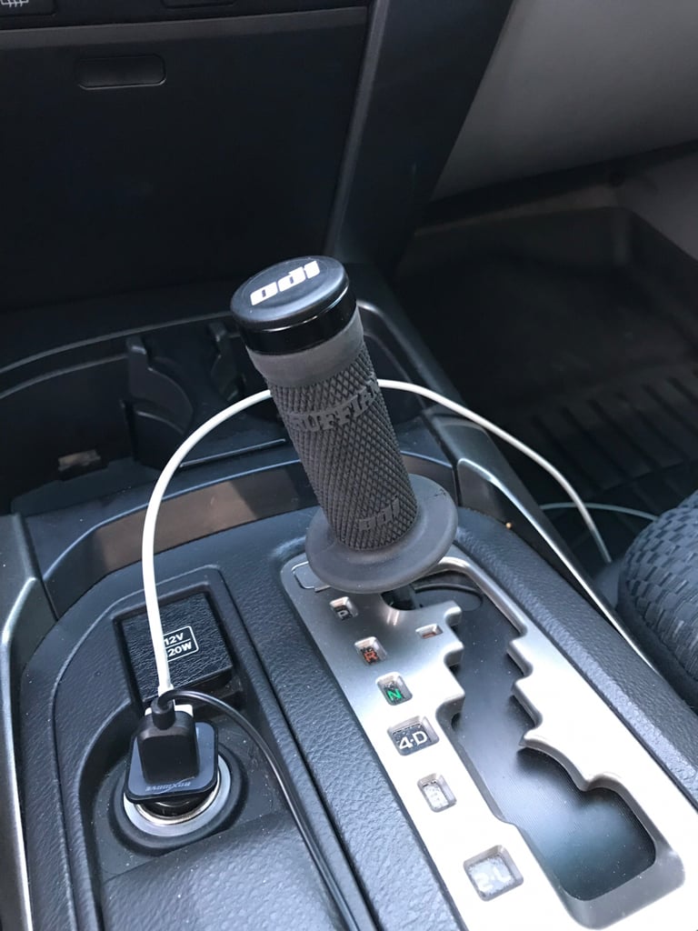

Machined an adapter to clamp a mini BMX grip onto my shift rod. Came out perfect! #bikenerd

auxbeam led fs-2
https://www.amazon.com/gp/product/B01KFBPBX4/ref=ppx_yo_dt_b_asin_title_o03_s00?ie=UTF8&psc=1
Rearview Camera - pioneer ND-BC8
Pioneer ND-BC8 Universal rear-view camera at Crutchfield.com
Displayed on my Pioneer AVH-W4400NEX DVD Receiver
Pioneer AVH-W4400NEX DVD receiver at Crutchfield.com
2x 12" Alpine dual voice coil subs
running off a vintage RockfordFosgate 1000a1 amp running at 1/2 ohm
and used this used that fits great next to the DAC button
https://www.amazon.com/gp/product/B013W8LQ7C/ref=ppx_yo_dt_b_asin_title_o06_s00?ie=UTF8&psc=1
This is absolutely on my list, but with a mtn bike grip. Just need to figure out a way to interface the two. I've got extra bars, just need an afternoon to put it all together! Great to see these though! Any problems getting to L gear?
Actually yes it won’t go lower than D at the moment [emoji1787] Need to adjust the height after work. I thought about using a MTB grip but I felt it would have been too tall. This one is about the same height as the factory shift knob.
Haha!
That's my fear too, but hopefully a narrower grip will allow it to sit a little lower yet and still be able to slot to the lower gears
Haha!
Maybe a grip that isn't a lock on but most grips are the same thickness regardless of what you get. My 7/8" OD adapter barely fits between the grooves in the 1st gear position BEFORE I trimmed it so definitely wouldn't clear with a grip on there as low as it sat before. I had to move the grip up like 3/4" and trim 3/4" off my adapter but it goes into first now. Sits a little higher but not too bad. The top isn't clamping anymore but thats ok, the ODI logo rotates :eyebrows: Send it!

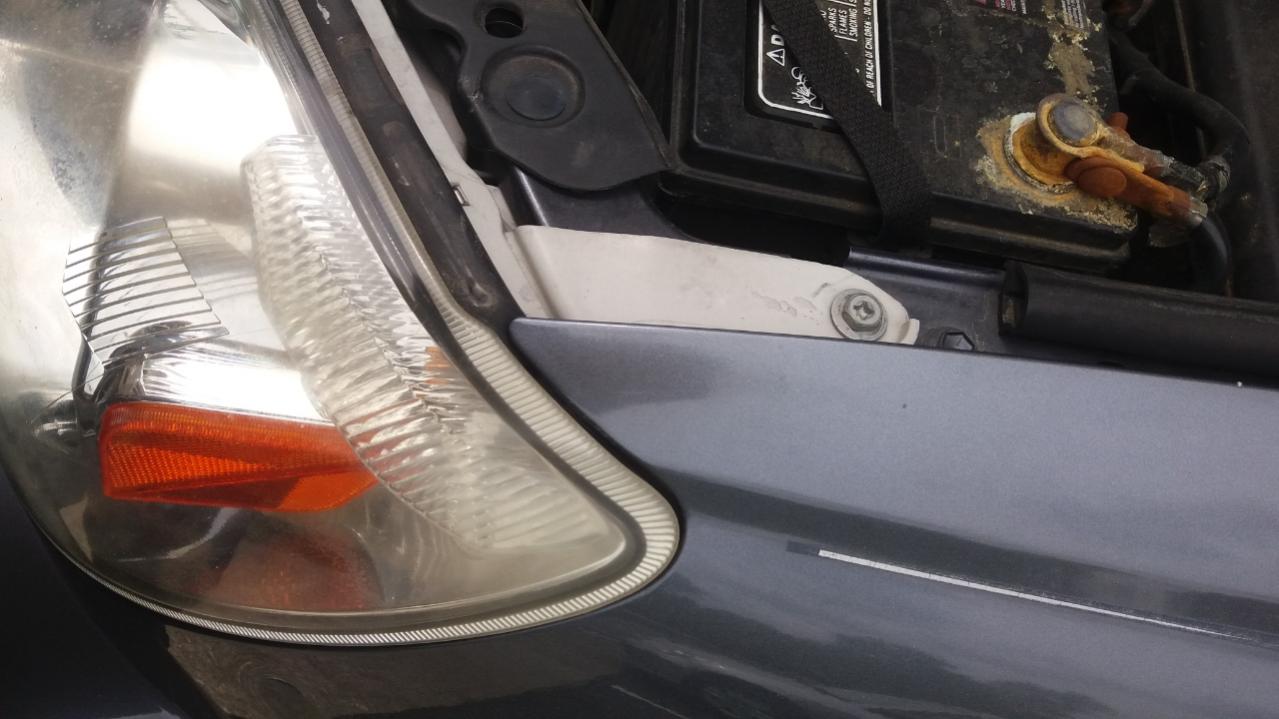

What someone else did to my 4Runnner today
Just got clipped from a fella turning from a middle lane in front of me. Good news is he had insurance info ready and the claim was started before I got out of work.
Headlight, foglight mounts cracked. Scrapes on the fender and bumper cover trashed.
I hate to get grey metallic paint matched from a shop so I'll see what they offer and maybe try to get a used bumper somewhere.
I just hope the fender isn't bent.
Ignore the rust on my battery terminal. It was a salty winter in Cincinnati.

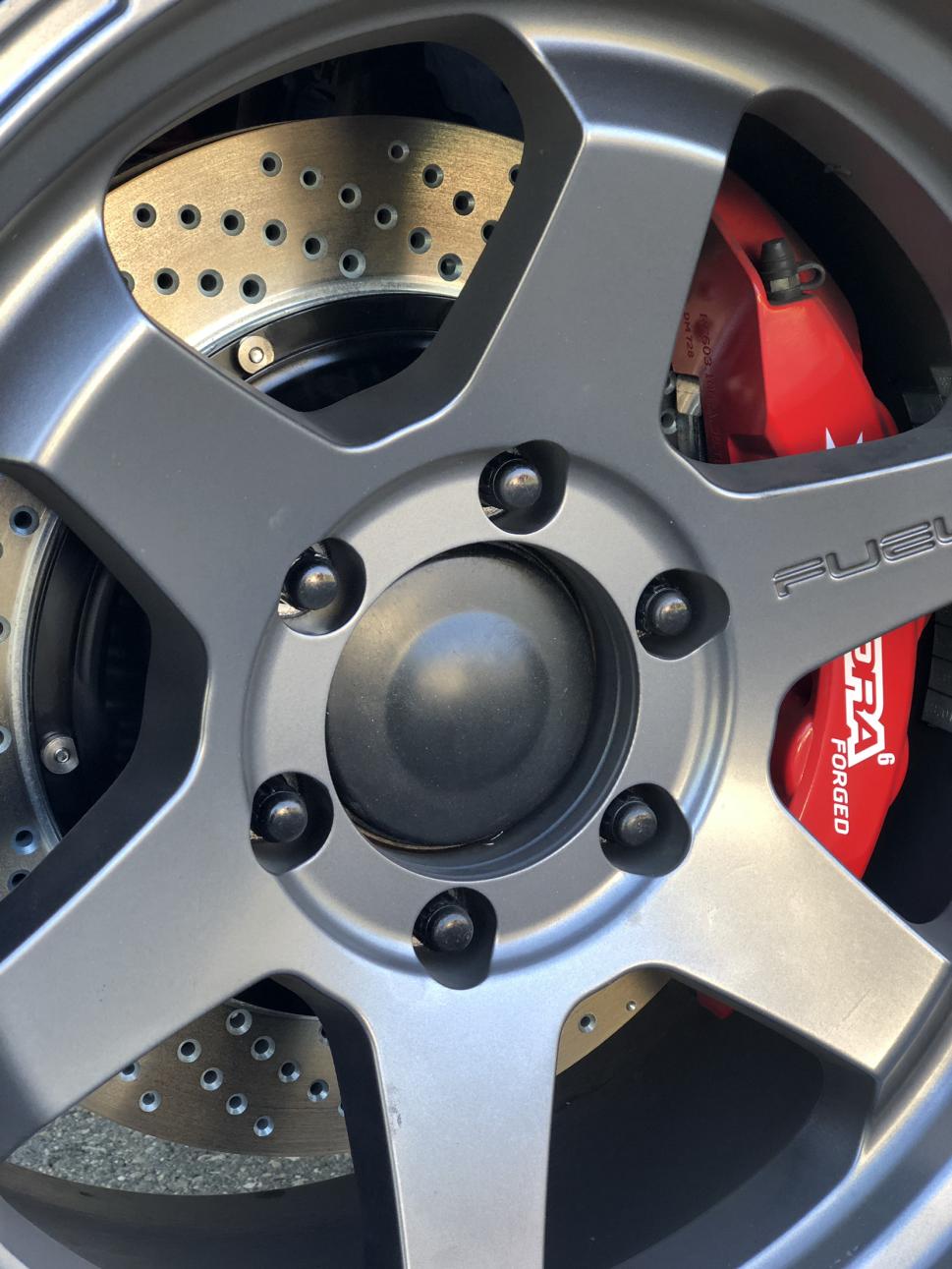

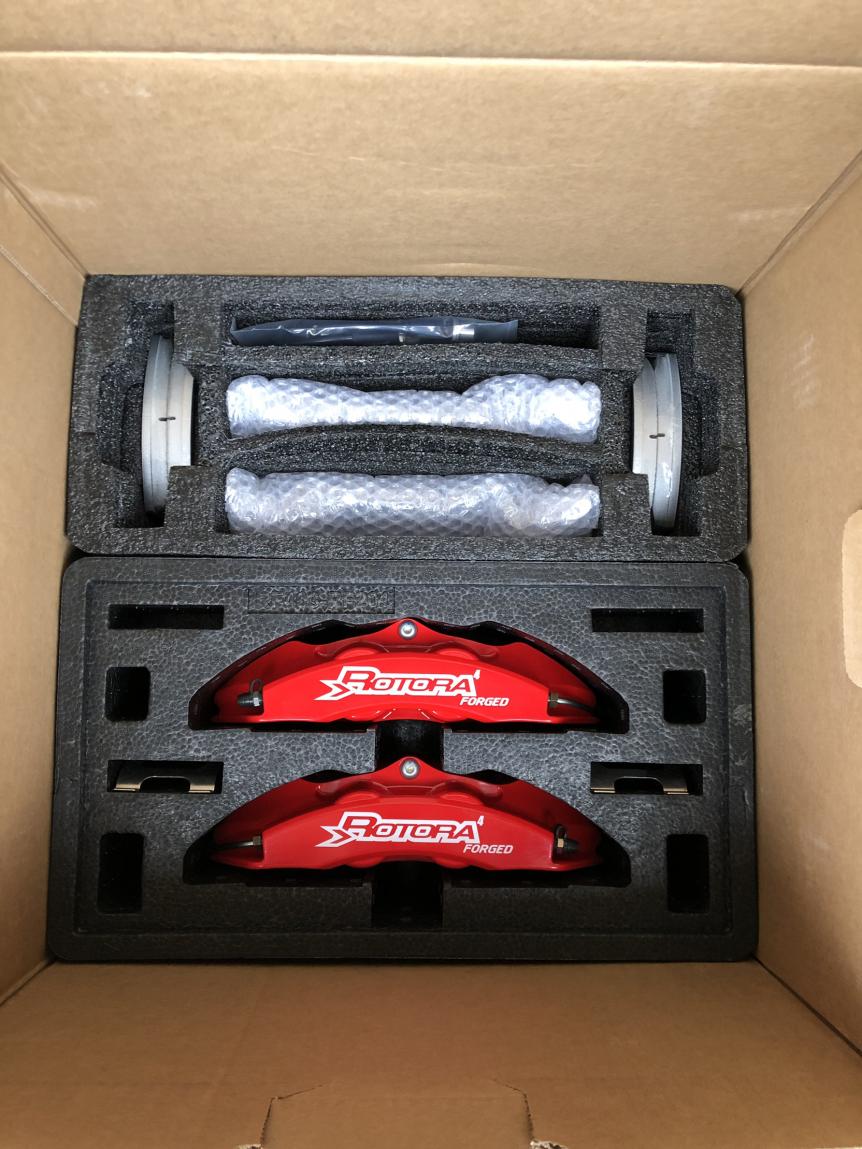

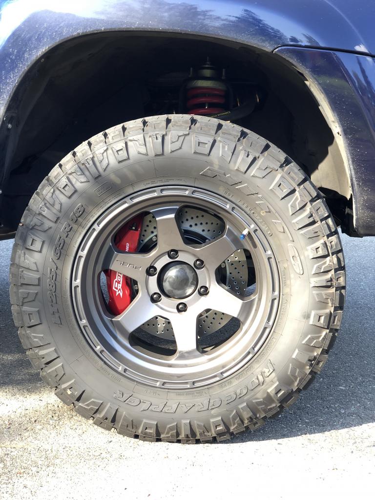

Today installed Rotora 14” front and 14” rear rotors and forged aluminum calipers. 6 piston front and 4 piston rear.
Review to follow.
