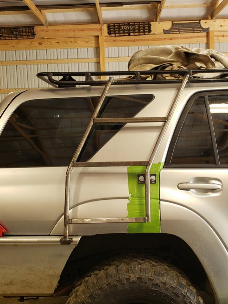

New ladder
Added side ladder for access to RTT so I don’t need detachable one.

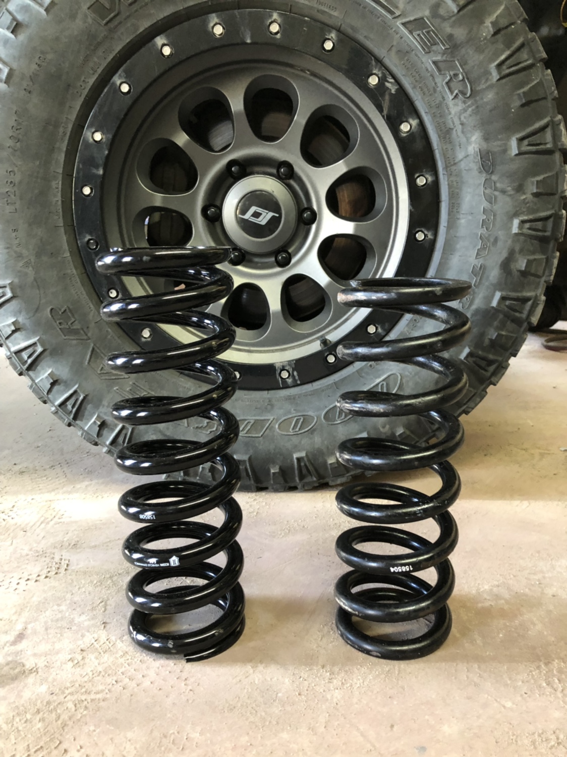

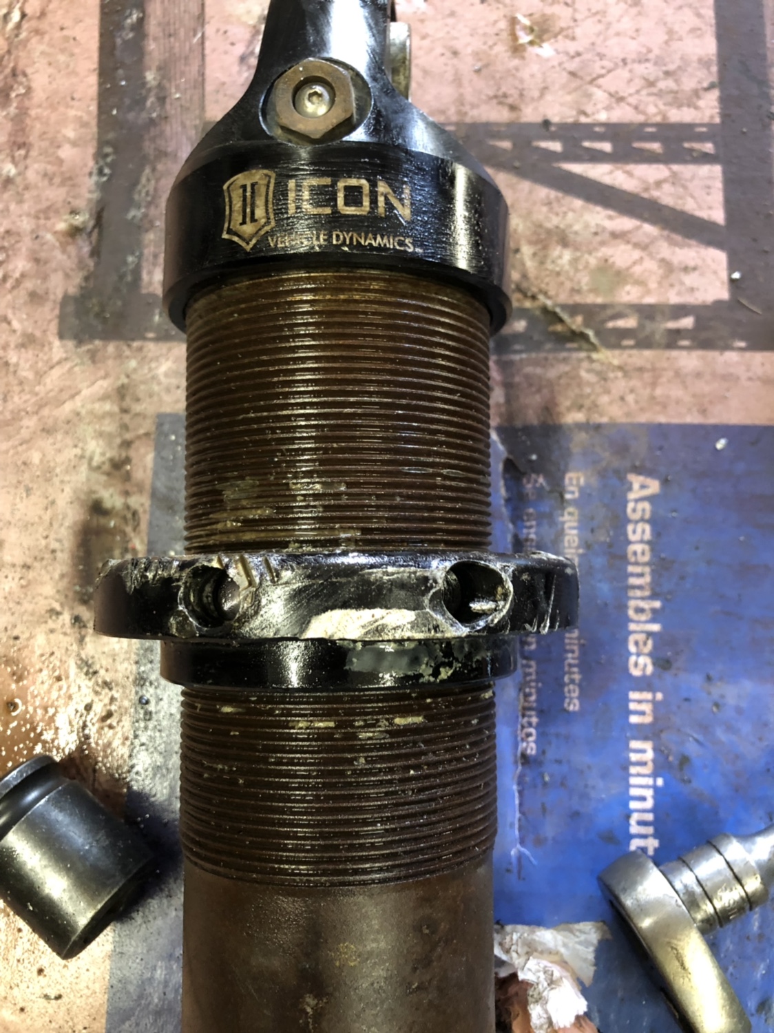

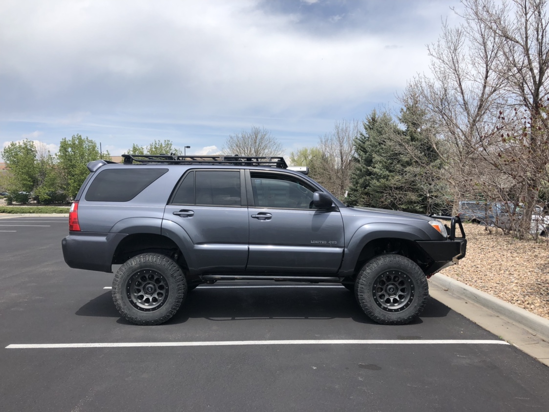

Finally upgraded and installed 700lb springs in my icon coilovers. One was an absolute ***** to install due to corrosion on the shock body. I had to soak it overnight, scrub all the rust off and used a big ass monkey wrench to even get the adjustment cap to spin.
I istalled an ARB bumper and a Come Up Seal winch last year and the 650lb springs that come stock with the coilovers couldn’t handle the 200+ new pounds up front. With the new springs I have more lift and the truck handles canyon roads much better.
Don’t do what I did and get the 700lb springs when you buy your coilovers if you plan on getting a bumper/winch.

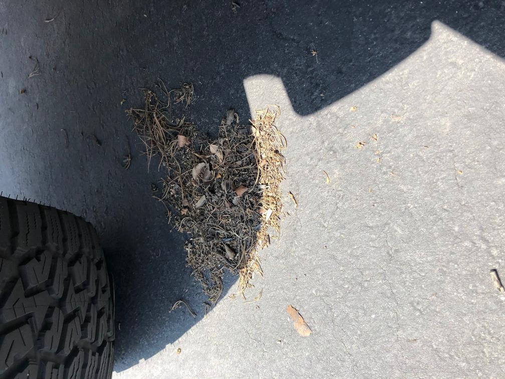

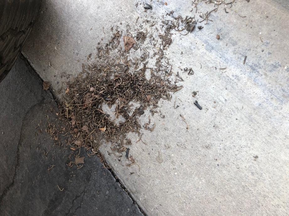

Sunroof drains and more...
The last major rainstorm we had ended up soaking my passenger side floorboard. Got the water damage all taken care of shortly after, bet never actually fixed the problem.
So, I took some flexible galvanized wire, sanded the edge down smooth and used that to clear the top drains. Water immediately started going down the drain holes, but wasn't trickling out the bottom.
Thanks to this forum, I decided to look behind one of the panels where the drains exit. A laughable amount of debris had accumulated there over the last decade and a half of being parked outside. Cleaned it all out and now it's draining perfectly! I couldn't believe the amount of debris, so I'm definitely going to be finding a way to put some mesh up top so it won't collect there in the future.
Nice! Which panels did you have to remove?
Had the same problem on mine. As much or more than what you had. Ridiculous amounts

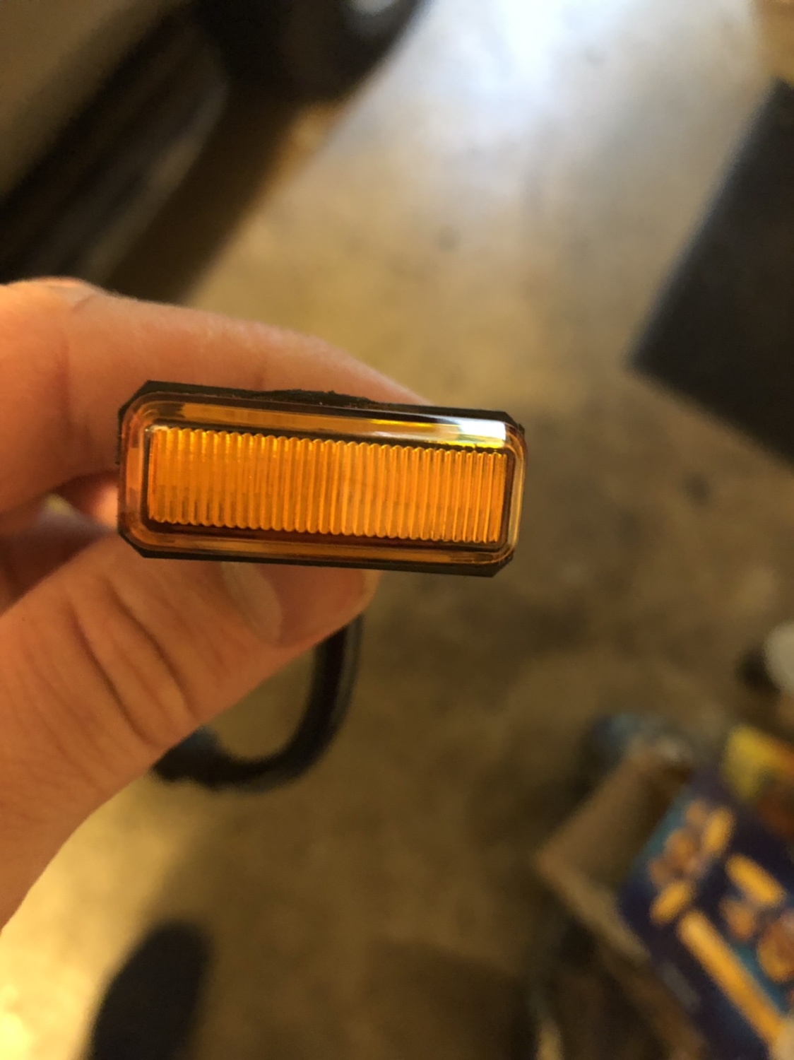

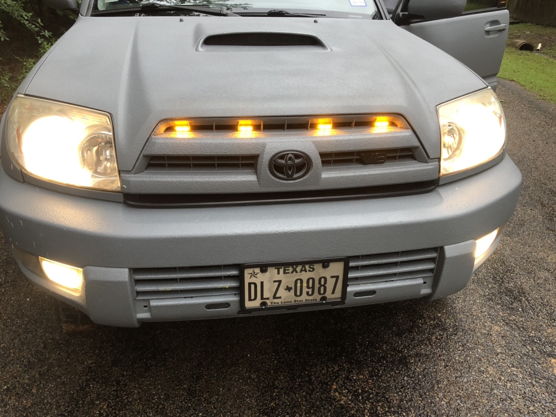

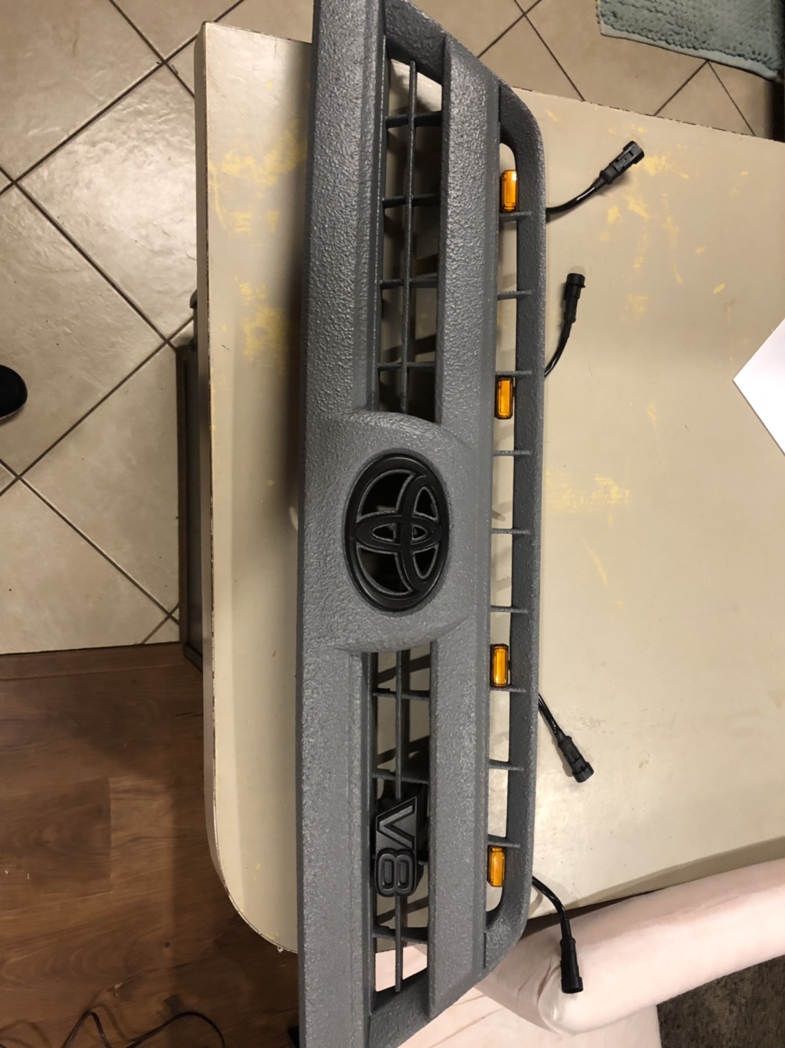

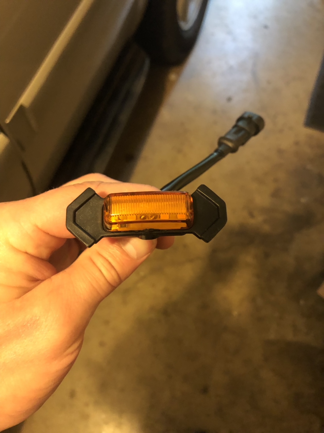

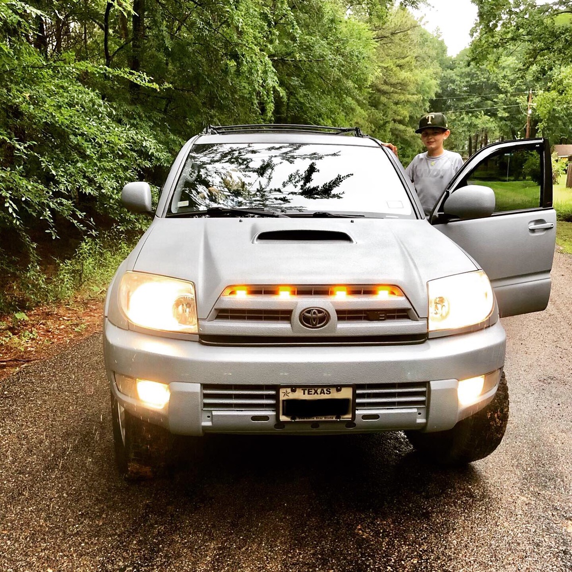

Added some raptor style lights to my grille
They are for a new Tacoma. I just trimmed the sides off and mounted them in the grille with some 3M weatherstripping double sided tape.

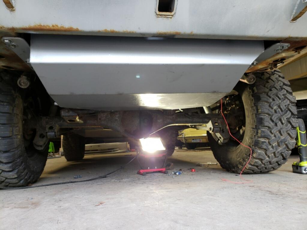

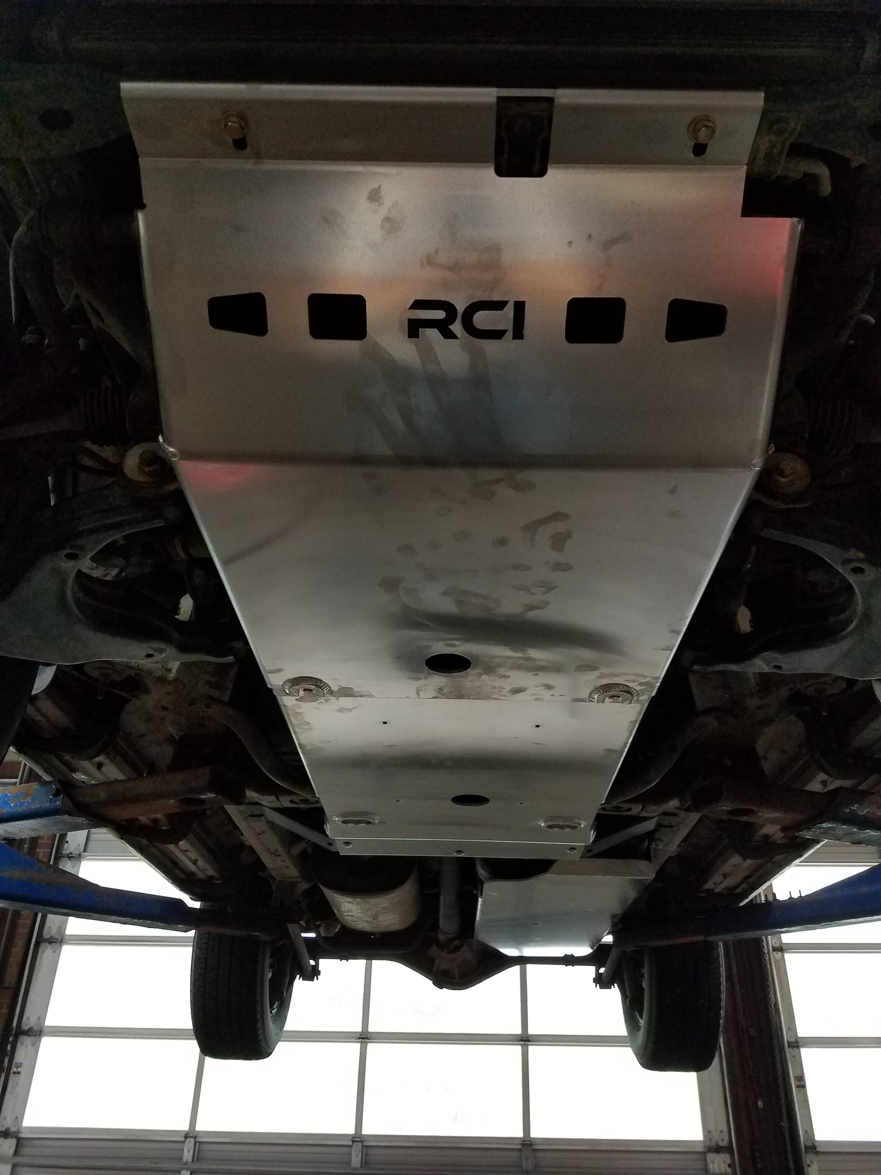

Got our RCI skids installed today, with a little help from my friend at Pine Hollow Service. Really nice kit, did end up swapping out 2 bolts for longer ones. Replaced the gas tank straps too since I was in there, but they really weren't bad at all.

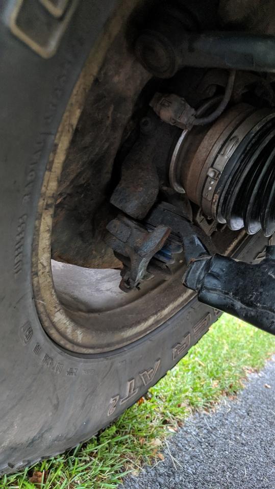

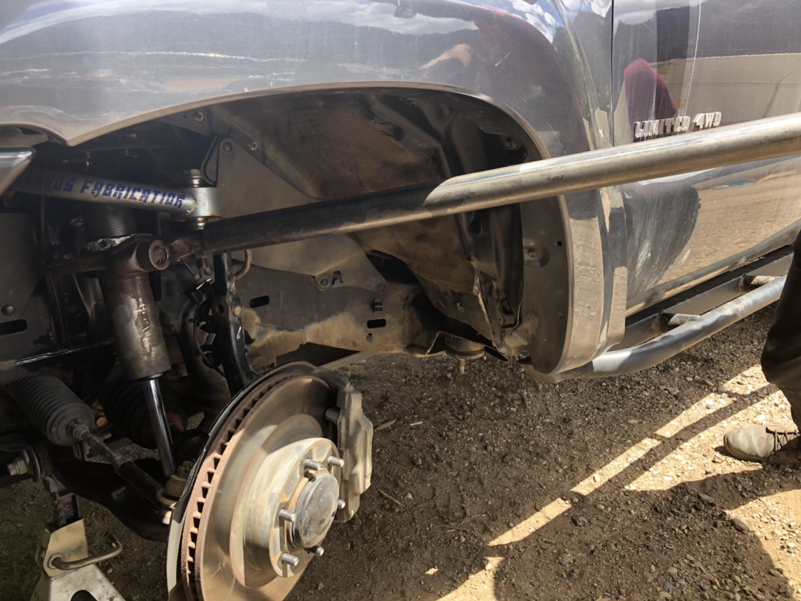

Got incredibly lucky on Saturday. Heard a little *ping* on my way over to some mountain bike trails in a local park. Was suspicious but everything drove fine so I thought nothing of it.
As I was back out of my parking spot later my front right tire started dragging. I pumped the brakes thinking it might be a stuck caliper and put it in 4WD in case it was something screwy with the drivetrain. Move the car forward and it was fine. Reversed in 4WD and it seemed fine.
Got to the end of the park entrance and decided to jump under and take a look before I got too far.
Who can spot the missing bolt?
Was a lesson to me to always recheck bolt torque after 100 miles or so after doing work. Soooo glad it didn't turn out as bad as it could've if I'd kept driving on it.

Holy crap! That’s bad! It’s One of the main bolts holding your knuckle together!
Did you put Red Locktite on those bolts? The book says to do that.
